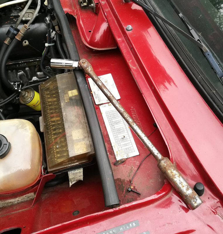

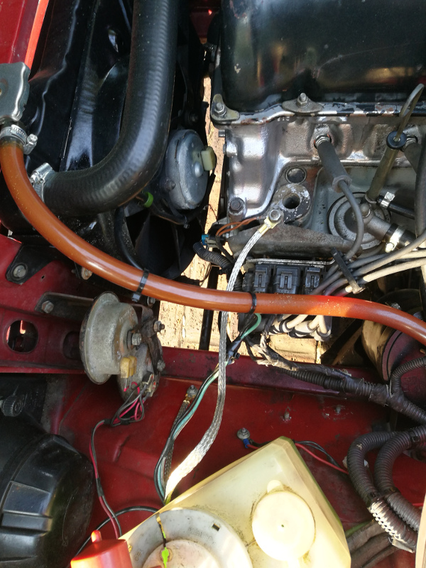

Well I think I can confidently say that the Lada is now running rich, doing some poking around just now once it's up to operating temperature results in it gasping for air and smoking like a coal fire if you floor the throttle until the revs pick up - which was happening very slowly. Rev response was more like a normally aspirated diesel than a petrol.
My mind does keep coming back to one factor that has a bit of a question mark over it, and that's the timing. Both the spark and fuel injection are precisely timed from the CPS so as to ensure that the correct amount of both air and fuel are carried into the engine...and the precise timing of that was never really confirmed...Methinks I need to get that done properly.
I did a hot check of the coolant temperature sensor, and it showed a sensible value (which I now can't remember - it was definitely in the right ballpark though).
On the plus side - it doesn't matter where in the cycle things are, all it needs to know is where no 1 TDC is...On the negative side, the radiator probably needs to come out to really get at it...Also, I need to get the blasted spark plugs out, a task which I'd been pointedly ignoring for months as they are utterly stupidly tight. Well, it was bound to happen eventually. Time to get me a nice big plug socket I can use with my breaker bar I guess, they just prey that they come out rather than snap in the head.
Speaking of batteries - the one in the smoke detector in my bedroom decided to pick 4AM this morning to expire...thing's only been in place about six months. Not amused! Of course I couldn't find another PP3 to save my life, so I'll need to pick one up next time I'm out. At which point I'll probably find three...
EDIT:
Well first thing I decided I needed to do was find TDC and ascertain that it wasn't a million miles away from where it should be. This meant getting the spark plugs out - a task which had thus far proved impossible - having snapped one spark plug spanner and bent another in half. However once I'd grabbed a suitable socket, my ancient scruffy 1/2" driver bar was having none of it, and they were all out within a few minutes. No 2 didn't half give a terrifying crack when it came free though...
Sometimes the fancy little T-bar things just aren't up to the job, and you just need some old fashioned brute force! The first thing I immediately found then was that the plugs (as I suspected from the 10mm body) weren't the right ones. They were some of those fancy 4-electrode ones, which I've found give great results in modern engines but have been at best patchy in more traditional ones. It was notable that due to the slim insulator that they weren't a very good fit in the HT leads either. The new plugs which had been sitting around for months were duly pressed into service.
One possibility that does sping to mind is that these might be more guilty than I'd thought. The first problems I had were during torrential rain. I almost wonder if water's got into the area under the HT lead boot and started tracking - there is quite a bit of carbon on the insulator of the plugs courtesy of the formerly leaky rocker cover oil seal. While this might not have been causing the plugs to stop working at all, it could have lead to a poor spark...and I know from prior experience that you need a stronger spark as the engine warms up and the mixture leans out...That's one I guess I'll never know the answer to. Anyhow, new plugs are in, they look better with the 14mm rather than 10mm body, and the insulators fit snugly into the HT lead boots.
My guesstimated TDC setting turned out to be correct +/- a couple of degrees - nowhere near enough that I'd expect it to have a significant effect on running - *assuming* that the TDC adjustment should indeed be relative to the mark on the timing cover rather than the CPS pickup itself, I'll need to do some reading to confirm that. Pretty easy to see though, as you can just shine a torch in through the spark plug hole for no 1 and can easily see the top of the piston.
While fiddling around on that side of the engine, I also applied a bit of protective grease to the ends of the additional grounding strap I applied last time I was working on the car (which I still also need to attack with a couple of cable ties to tidy it up). I decided that couldn't be a bad thing A: Because I hadn't seen a dedicated earth strap for the engine to body, and additionally B: Because there's a lot more electrical kit hanging off the engine now (including several hundred watts of manifold heater) that never used to be there. I'm a great believer that in cars that there's no such thing as too good a ground connection.
Final check was a vacuum leak hunt. I found three possibilities...
1. Purge line from the charcoal canister missing hose clips - though in my defence, it never had any from the factory - though the original silicone hoses were a very snug fit so probably didn't need one.
2. Main PCV circuit hose could be moved on the hose barb at the throttle body end despite having a clip on.
3. Secondary PCV hose had never been tightened up where it connects to the air cleaner...Oops. Wouldn't *expect* that to do anything though as it's open to atmosphere inside the air cleaner...I should also by now know however not to apply logic to vacuum systems!
These were all quickly resolved. Even though I'd like to replace the clips on the charcoal canister purge line as they're seriously cheap and nasty ones...no idea where they came from! They however were the only ones the right size I could find...so they were used.
Starting up, throttle response was immediately way sharper. Proper "snap" from the exhaust if you booted it from idle, with a slight suggestion of very light grey smoke when it was just started (so running open loop) just as I'd expect. Then went out and spent ten miles driving around MK in a variety of manners, and the car behaved impeccably - even if after a week of driving the 107 the brakes do feel mildly terrifying! Parking back up, obviously now well up to temperature, and blipping the throttle resulted in a proper throttle response and zero smoke, and no obvious "rich running" smell like earlier.
Have I fixed it? No idea yet, I'll need to hop onto the A5 tomorrow and do a few "laps" up to Stoney Stratford and back and see if it behaves. However before lunch today it was patently obviously sick - after I'd changed the plugs and given the vaccum system the once over it wasn't obviously sick...so we'll see I guess...
