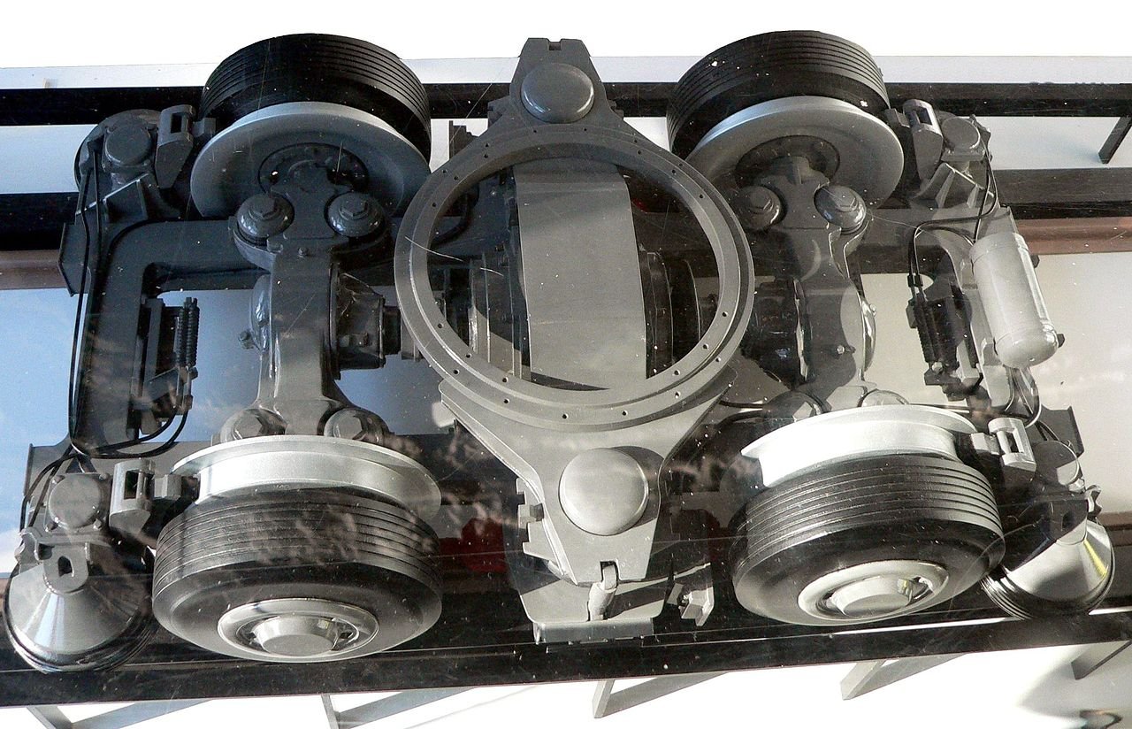

Always did like the way Paris metro trains on rubber tyres used to arrive without clatter and squeal at stations.

white exec wrote: 19 Oct 2018, 11:43 Always did like the way Paris metro trains on rubber tyres used to arrive without clatter and squeal at stations.
Was that the reason for the fitting of the rubber tyres?
If so, it's brilliant... Only minor problem I recall in Metro Stations where rubber tyred trains call is the awful rubbery stench in the air...
But I'd rather have a stench than a squealing racket!!!

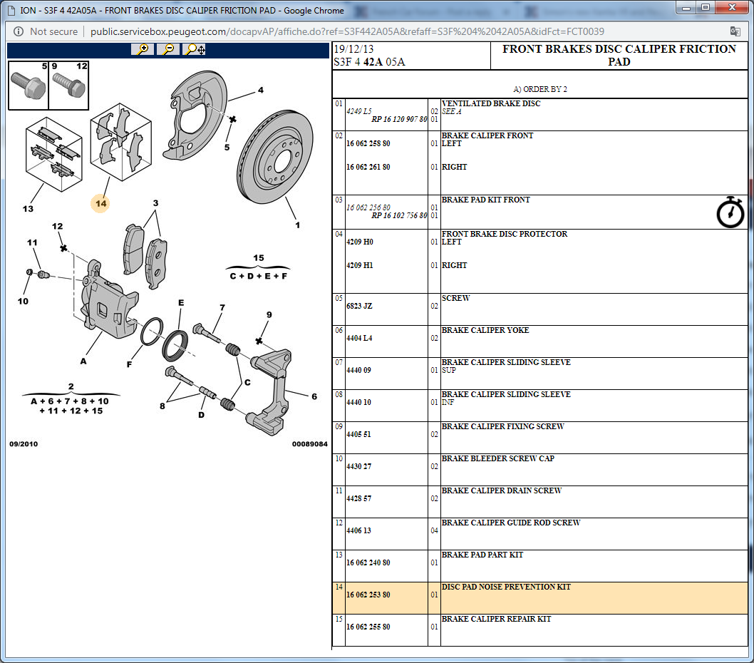

Funnily enough I've seen what these look like in person as when I ordered the brake caliper repair kit (seals etc) they supplied the noise prevent kit by mistake before sending it back. I kinda wish I'd just kept it!!! They are basically full size pad backing shims with a kind of compressible rubbery material on the side that goes against the pad back - no doubt to damp squeal, (which I don't have a problem with) but the compressible nature of the material may help to prevent the caliper assembly from rattling as well.
Only £10 for this noise prevent kit, so if it works it's a no brainer to get it. So I think the next step is to get new metal pins and the noise prevention kit. At least I can guarantee then that that bottom pin wont ever get jammed again...

I wonder if the "noise prevention kit" backing plates have a spring finger on the edge of them to do that as well ? I did see them in person in January before handing them back as the wrong part, and I remember that they were shims with a sticky rubbery backing on them but I don't recall the shape around the edges and the servicebox picture isn't detailed enough to tell.RichardW wrote: 13 Nov 2018, 07:20 It needs a set of those springs that were available for the Xantias with the bigger Bosch brakes that pushed the calipers up!
I'm going to try to order 4 of the metal only pins and the noise prevention shims for it today. While I'm at it I'll see if I can get a new release handle for the left rear seat as I can only fold that seat down with a 10mm spanner at the moment....
