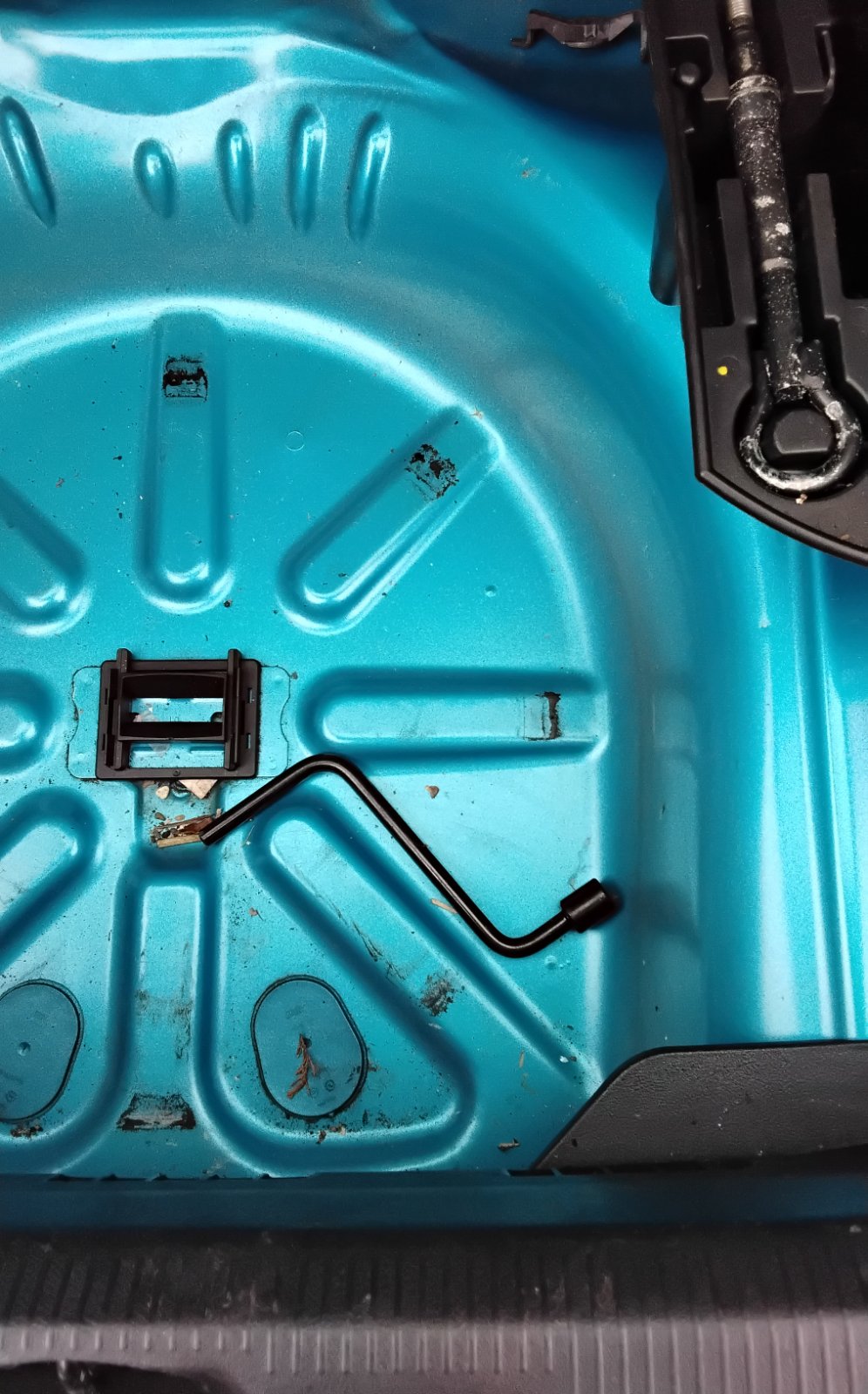

Ive tested the trailing arm bush no movement there, I cable tied the hand brake cable to the fixing bracket thats tight now , here's the weird bit , the hand brake locks up but will release with a bang, or whe you drive off, so I held the drum at a quater to three and slowly twisted it up and down like turning the steering wheel, there's a knock a quite knock but its a noise that could be the problem, wheel bearings , they are odd some will grind some drone if one of the races has failed I think it might cause some sort of sound, but confusing thing is when the wheel is on and the car jacked up there's no play when testing the wheel the same way it gets done in its mot.
Either way I've new drums on order so these come with the wheel bearings already in so im not to worried so much knowing it will be all done when it gets a bit drier make me have that bit of piece of mind.
Im now going to check the boot , ive a 100 mile round trip to do at mid day so im going to take the spare wheel out and stuff and see what happens , anything worth trying , I think if someone else has the same trouble this post might be useful

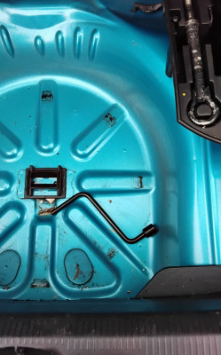

Going to remove parcel shelf and boot contents now,MattBLancs wrote: 25 Jan 2026, 21:17 Happy to be proven wrong, but I'd rule out wheel bearing. My experience they've droned at certain speeds, never rattled.
You mentioned parcel shelf earlier, have you been for a drive with that, jack, wheel brace, spare wheel and anything else interior removed to confirm noise still present?
Definitely coming from the rear?
Checked boot lid not able to rattle? (Striker plate adjustment, make sure it's pulling nicely against the rubber seal)
Are there any more underbody plastics (like the rear beam cover you removed) ?
Fuel tank mounting straps look ok? (Had very rusty ones on the 206 at one point)
Rear beam covers are off , no difference, might put them back on ? Dunno they could be traps for mud and help breed more rust
Tank straps I think there ok
Going to check the boot now. Update later this evening.

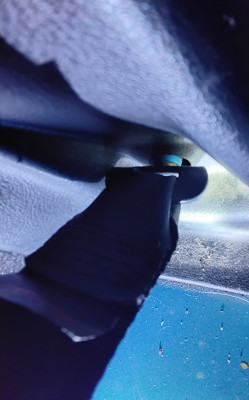

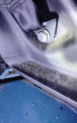

So I drove the 100 plus mile trip with nothing in the boot and no parcel shelf and the noise was still there how ever I by accident found that the seat belt ancor points seemed to look lose and the metal belt part was rattling and making a very close sound to what I hearing, ive tighten these up both sides and ive wrapped rubber gloves around them as to stop any sound, I won't know if this has worked till tomorrow, I had some help from a little cat
as seen in the photos

The Grey 308 seat belt lower mounts give an occasional rattle (mostly drivers one and I notice it most when putting the belt on/off)
Try an O-ring stretched over the bolt head - I added one and it lessoned it a bit.
