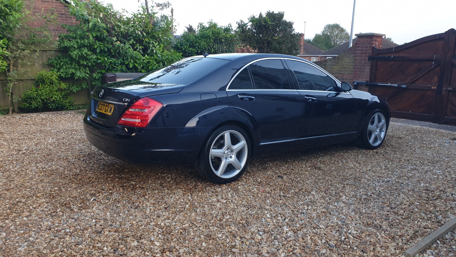

The disappointing Mercedes S320CDi
After spending 7 months driving the Citroen C3 every day, which was now filthy from the winter, the price of Diesel was coming down, and I fancied something more regal to use once or twice a week.
I have enjoyed a lot of Mercedes models over the years, and decided the W221 S class would fit the bill. I hunted our a good example with lots of extras, yet within my price range due to it needing a bit of love... and I made the purchase. At first I felt a glowing sense of pride that I had re-entered Mercedes ownership.
Spencer helped me give it a good clean, to ready it for service.
He seemed to find the Mercedes dull and occasionally preferred to clean the driveway....
But we managed to get it to a nice presentable standard... but it's here that I found myself thinking it was hardly an elegant car, quite a clumsy looking thing in fact; those headlights are horrid looking and I obsessed over what I could do about them far too much... :lol:
A week after buying it, I had to make a 5 hour round trip for work. I decided this was a journey the Mercedes was born for, but the journey was not quite as satisfying as I expected it to be.

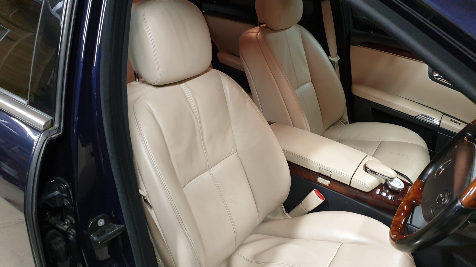

First of all, try as I might I could not get the seats into a comfortable position. They look like they would be nice and comfy, and there are about a thousand ways they can be adjusted, but they seem to be manufactured for the - Ahem - rather large gentleman, and they don't hug around my tiny frame at all. It's mainly the backrest that causes the issue, as it seems to be hard and flat where my shoulder blades are, which makes me fidget constantly... :shock:
Also, I realised the posh "massage" function was absolute rubbish.

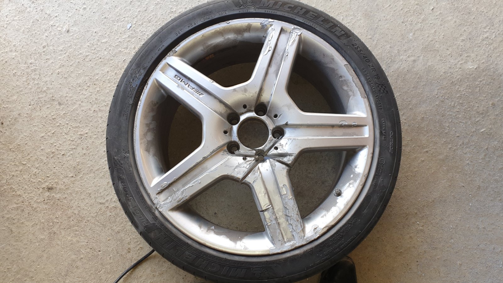

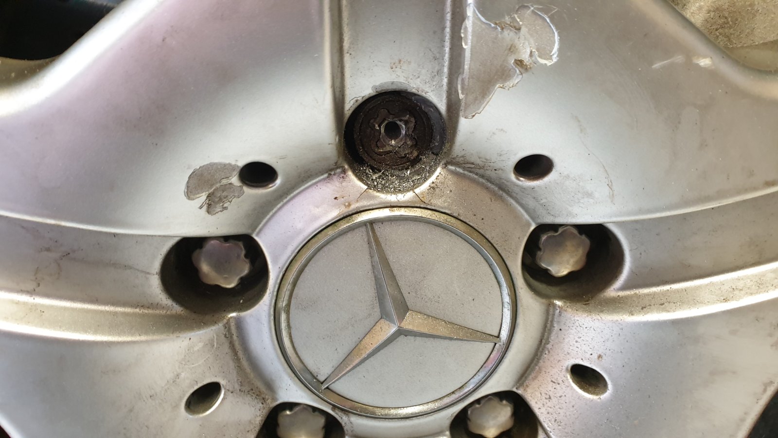

But then we had more drama when I dropped the car off to have some new tyres!

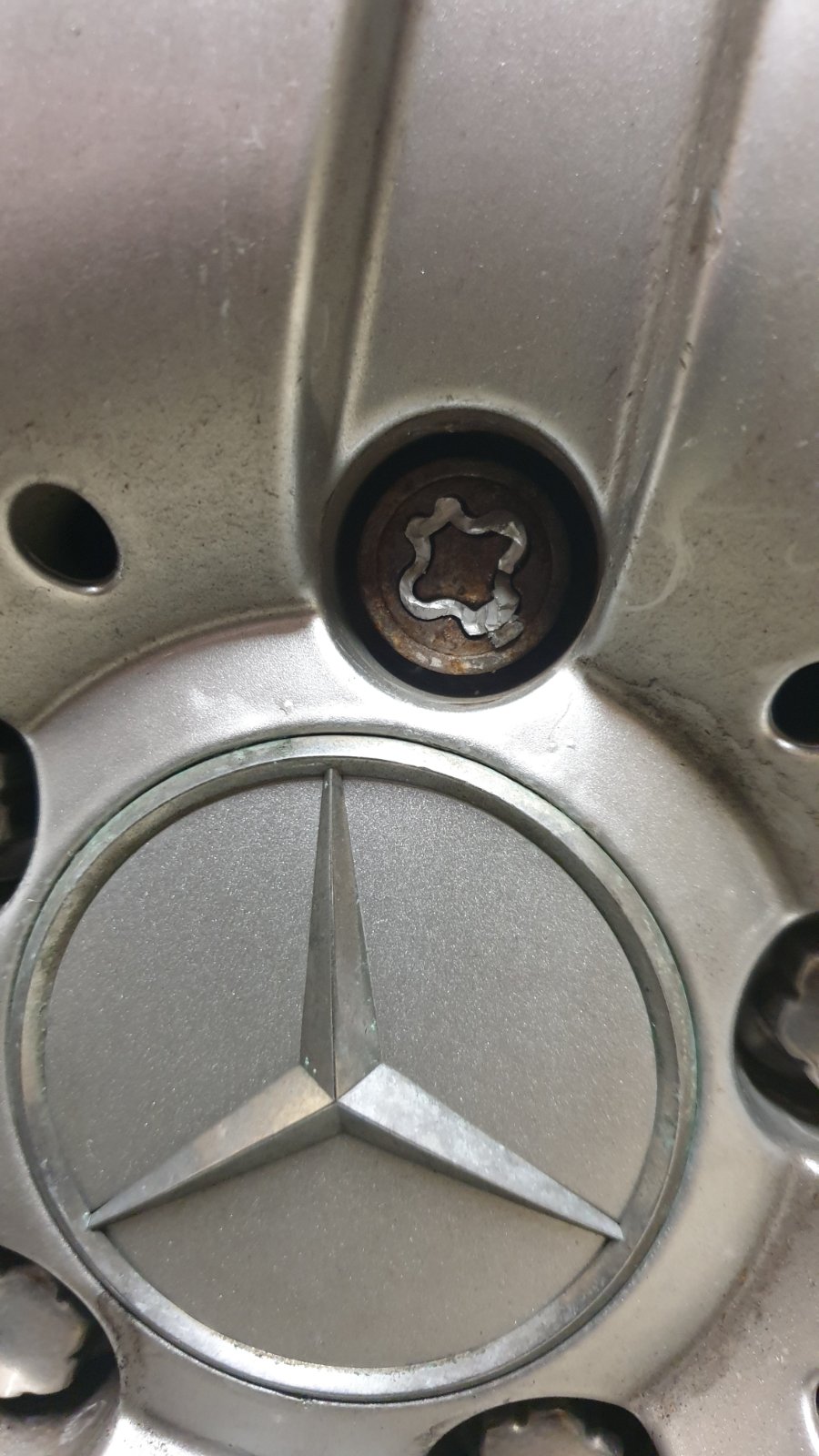

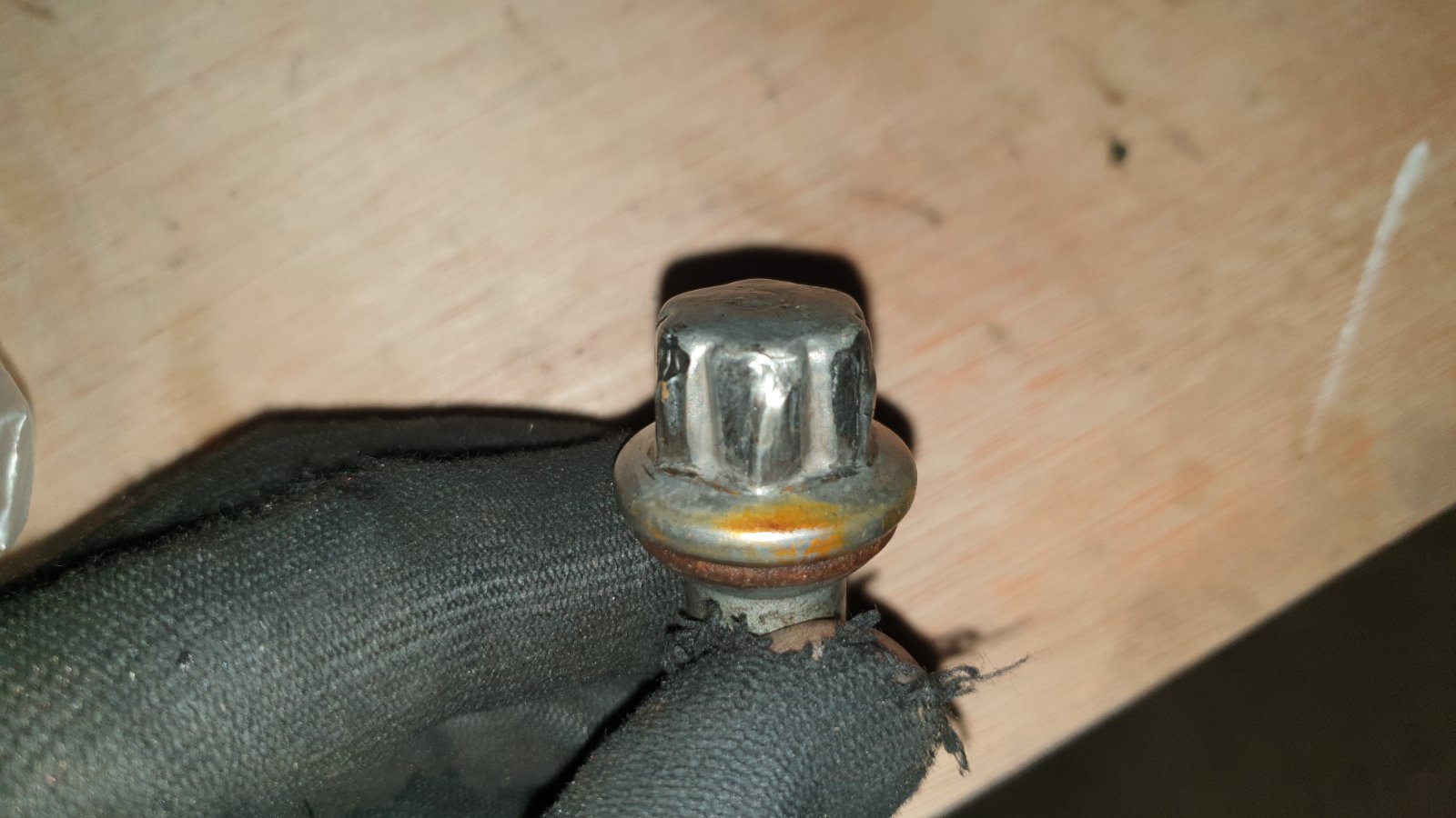

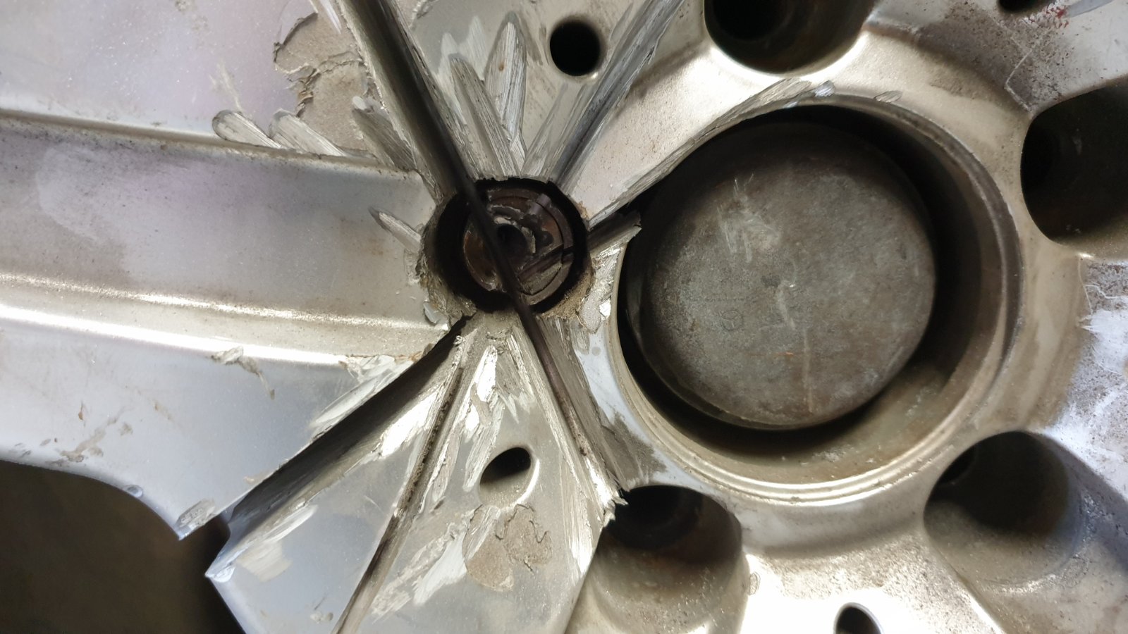

In a phone call that defied belief, the garage told me to come pick my car up, because they could not get the wheels off! The wheel nuts were ceased, and they had broken my locking nut trying.
There was a sliver of the locknut key trapped in one of the locknuts too!
I phoned a few wheel nut removal experts, but when I mentioned the trapped bit of locknuts most of them said they would not be able to help. Then one proposed to use a technique of "welding" to the old nut, rather than using pressure, but quoted me wanted £150 just to remove one nut! :shock:
I decided to do it myself...! :rofl2:
That was not a good idea... :?

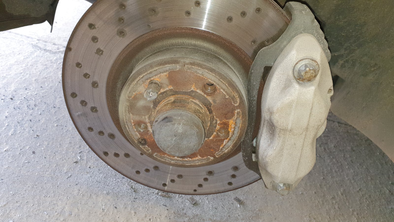

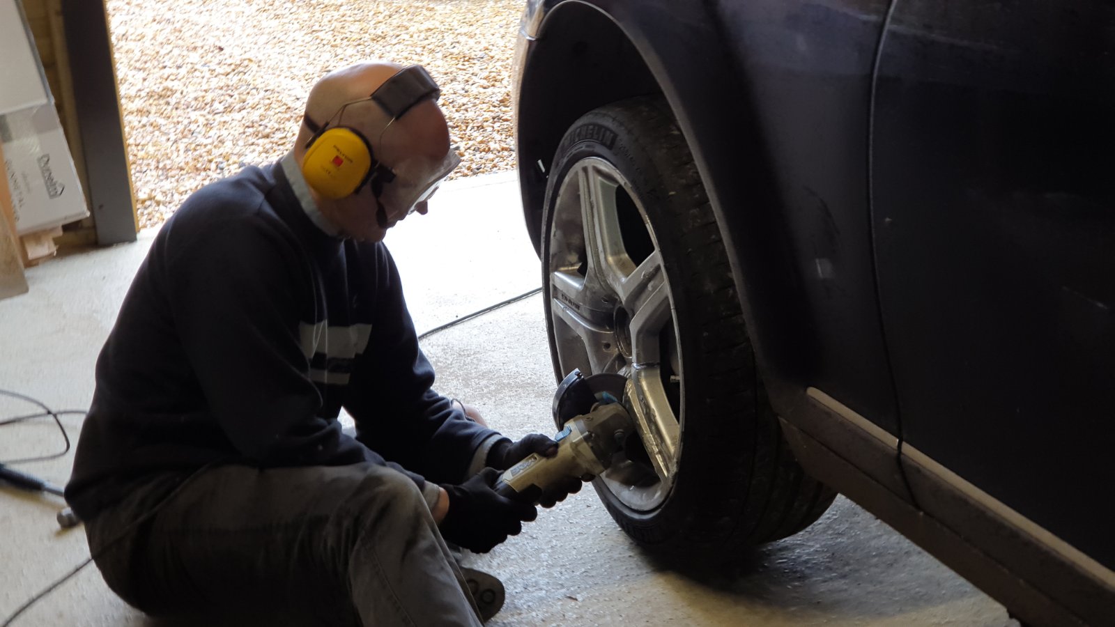

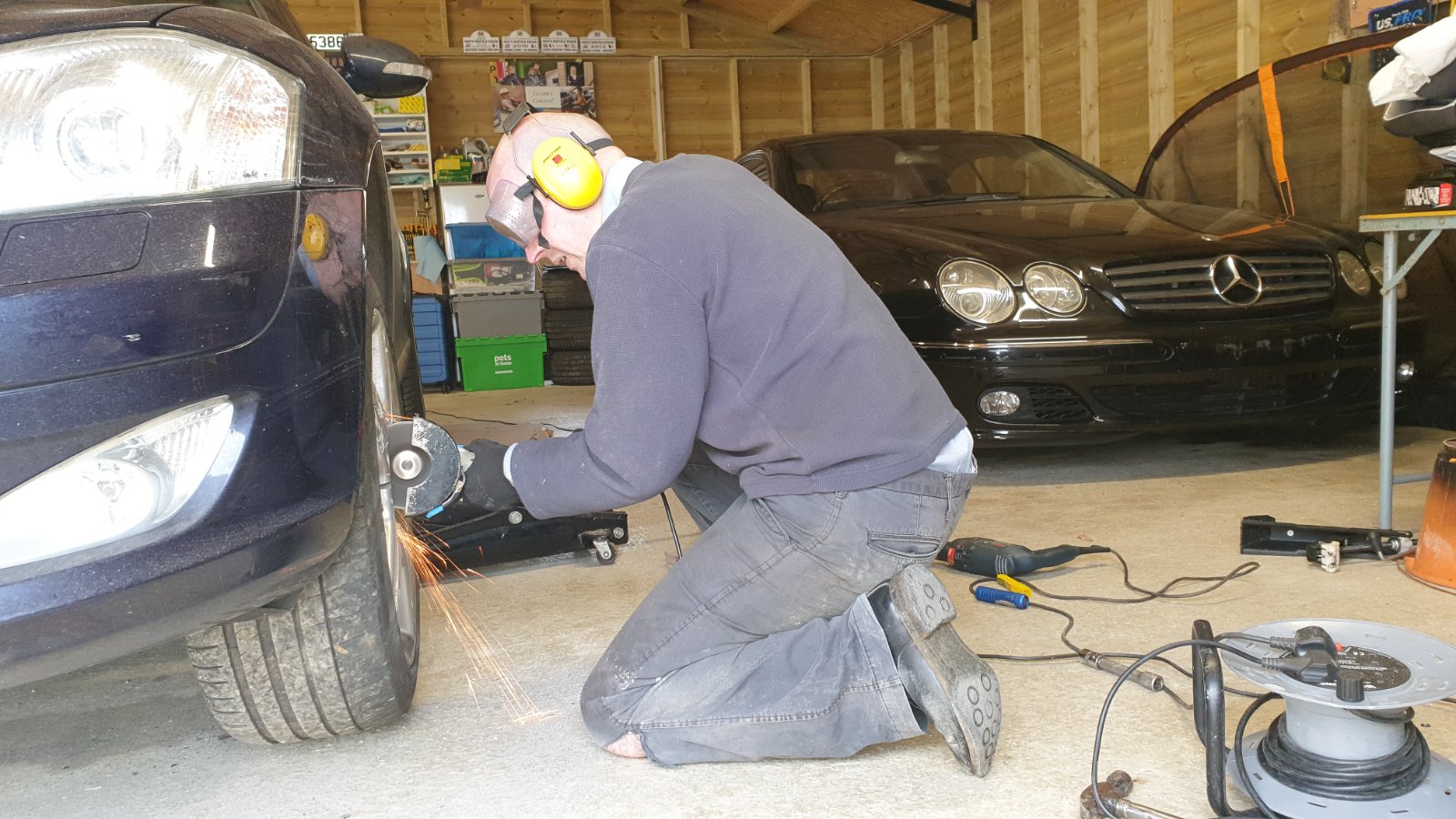

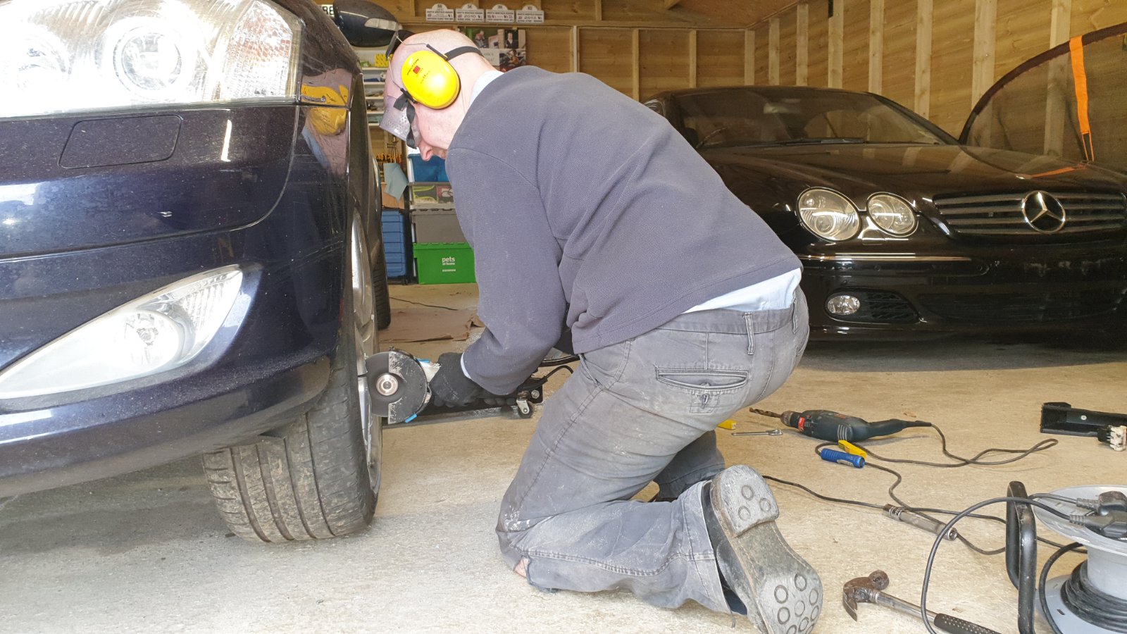

After the purchase of a new locknut key, I managed to get three of the wheels off with some care and elbow grease, but the 4th was absolutely adamant it was not coming off. I bought all sorts of magic potions and locknut removal tools... but they were all eaten by the beast!
Some of the wheel nuts rounded off, and had to be removed by hammering on a smaller socket.
Out came my friend the angle grinder...
The hooligans didn't enjoy the noise; it was kind of payback for what they do to Lindsey and me every day! :mrgreen:
It took me hours and hours... but the poor wheel finally came off....

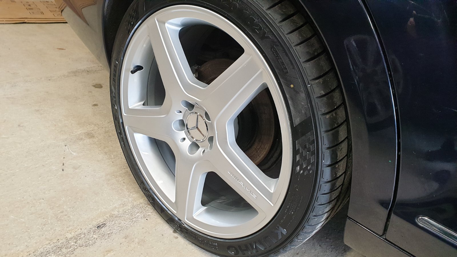

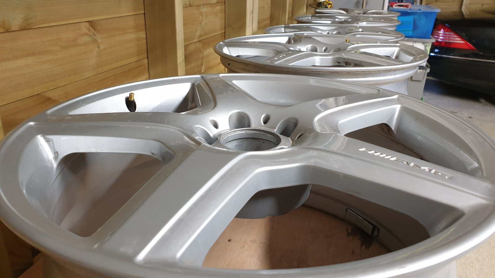

...and because of this, and my dislike for the style of the 19" wheels (I thought they were too small for the car style).... Aston and me went on a fun tour to buy some new 20" wheels.
We tried to forgive the big Mercedes and gave it a bath...
I confess I do like the new 20" wheels much more than the old 19" ones though... They suit it more.

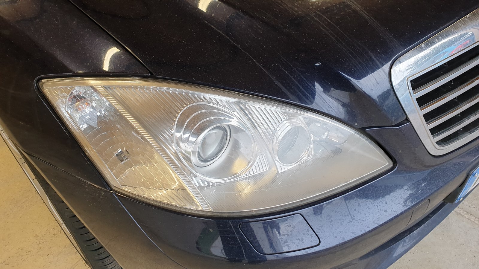

But I think this photo illustrates those hideous looking headlights very well... yes I know I'm obsessing... :|

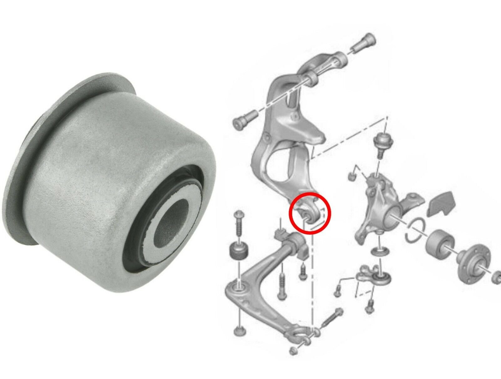

So putting aside my naughty cars for a moment, I think I have identified the "knuckle bush" that the man at the Citroen specialist said needed doing.
Some may remember (if I wrote about it... :?) when the Citroen C5 was last in the garage they told me that a "knuckle bush" needed doing, accompanied with comments that the part may not be available, due to the very complicated suspension "on those cars". I certainly detected some reluctance to replace this part, and even tell me what part needed doing... :(
But what a croc of rubbish that's turned out to be. The bush in question is used on the C5, C6, and a few Peugeot models too. There are so many of these bushes on the market in any flavour you like, I could replace these bushes every week if I wanted.
The negativity you get from garages really winds me up... my theory is that they must only like working on the newer models??
So... after much googling, I stumbled upon a couple of links that referred to a "knuckle" in two places as follows:
https://eurofrance24.com/wheel-steering ... 65704.html
and here too...
https://www.ebay.co.uk/itm/184175683453
It appears this bush circled here is known as the "knuckle" bush by some in the trade; though sometimes it is a lower pivot arm bush, I think there are some other names for it too. There seems to be two part numbers 365704 and 365604 which look to be identical in their use, and interchangeable. I just need to order one and try fitting it!
Then best of all someone has made this fantastic Youtube video showing how to fit it.... looks like child's play!!
I am going to order the Sealey VSE4785 kit (around £70), and a pair of the Febi Bilstein 44400 bushes, and I may as well do both sides while I have the car up.
Wish me luck!
Posts: 14308
x 3306
Re: c16rkc's mad house
I would ask on the Parts request thread first, as it may be they are of different 'resistances' to allow for different engine weights (for example).

As a minor update to the part number fiasco, the part does not seem to be available from Citroen separately, so I can only assume they want to sell the whole Pivot arm.
So that being the case, I have ordered the part that Febi Bilstein list for my car... part 44400
Really odd Citroen do not consider this a replaceable part, considering how easy they appear to be to change... :-k
Posts: 5311
Joined: 25 Apr 2022, 09:03
x 2343
Unread post by MattBLancs »
c16rkc wrote: 02 Oct 2023, 14:48 As a minor update to the part number fiasco, the part does not seem to be available from Citroen separately, so I can only assume they want to sell the whole Pivot arm.
Yes, there's a few items that you would not even think to check but yet are not available separately direct from Citroen. That bush being one as you've found.
Also rear anti roll bar bushes, not available separately = buy the complete bar!?! I beg your pardon!?!
Am sure there's others. CV boot kit rings a vague bell?

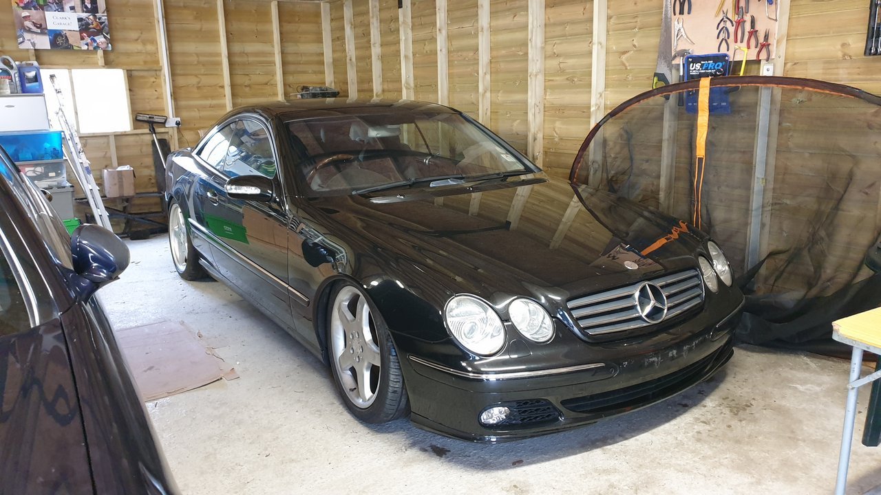

The Mercedes CL has been skulking around in my garage for far too long... since I built the garage in fact!
It's certainly time it moved to at least a different location in our garden... :lol:
Trouble is... so far I am clueless as to why it no longer works. It seems likely it's something to do with the refurbishment I did of all the ABC valve blocks and other components, but so far I have not managed to fathom what I might have done. I find the official Mercedes diagram of the ABC hydraulics a little hard to follow, so I took their diagram and added directional arrows and labels for each component; to help me try and understand out how things work, and what might be wrong.

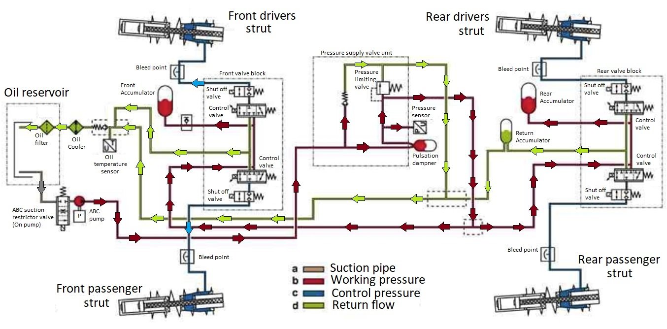

So... setting aside that I did all this work myself and cannot be trusted :lol: .... all the valve blocks have been refurbished, the accumulators are all brand new, as is the pulsation dampner, and the pump has been replaced too, it should be floating like a Grand sultan's magic carpet. But when I power the car up it just sits there sulking and feeling sorry for itself. The suspension does not budge one millimeter.
As I understand it, when the car is lowered, the car energises the strut valves regardless of the state of the sensor readings, and so as long as the pump is creating pressure the fluid will travel to the struts and lift the car, and it is only when the desired height is reached (or the pressure exceeds it's limit) that the car starts shutting off valves and running off excess pressure to bypass.
So for my car not to be rising it can only be two things...
1) Not enough pressure.
2) No power to the strut valves.

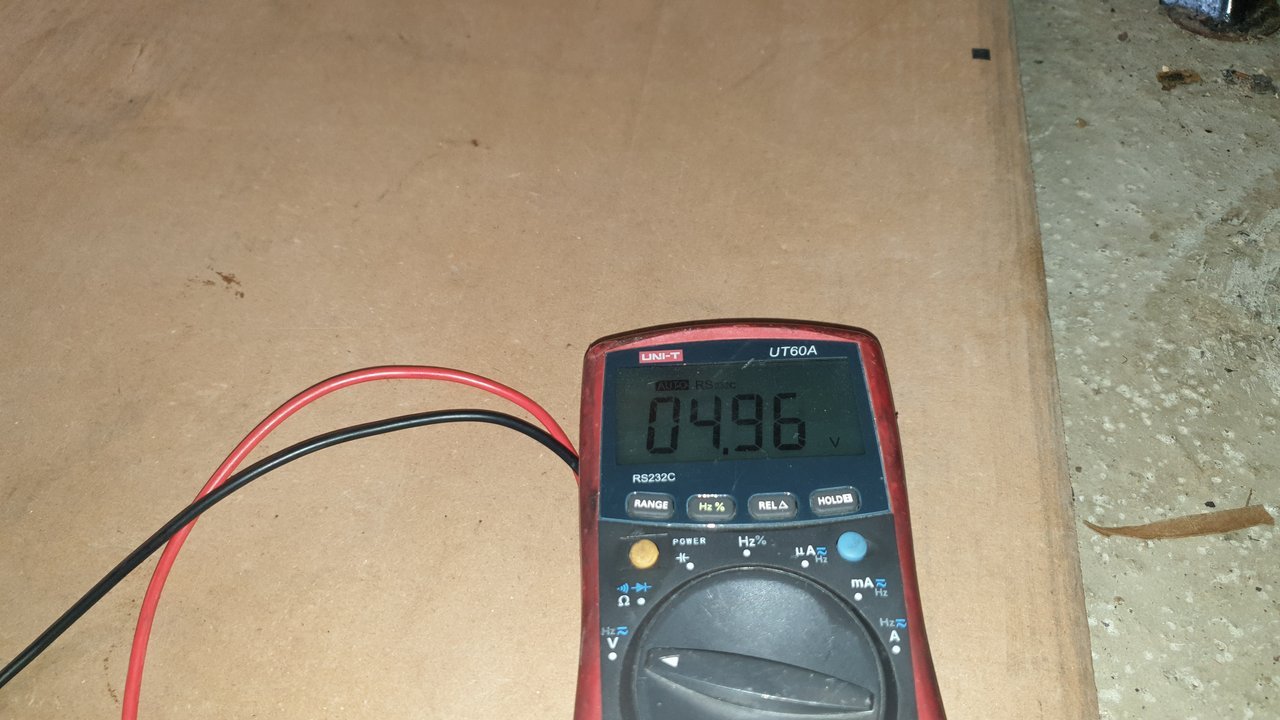

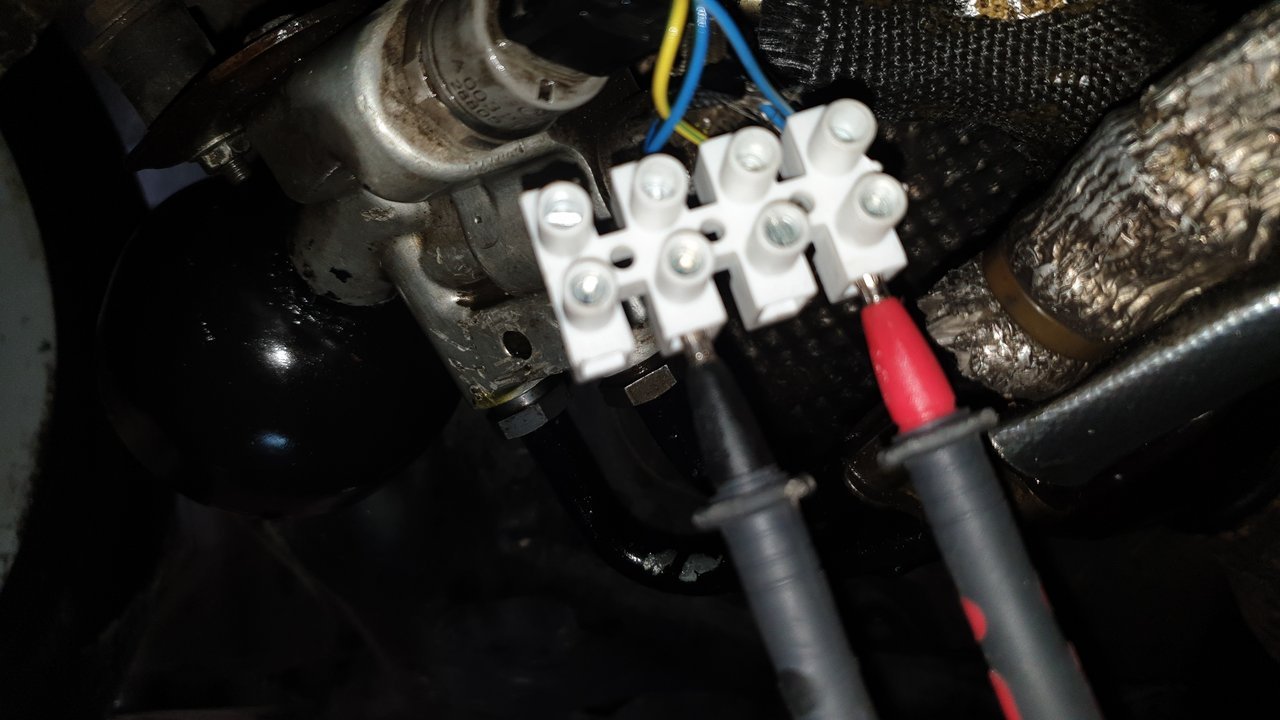

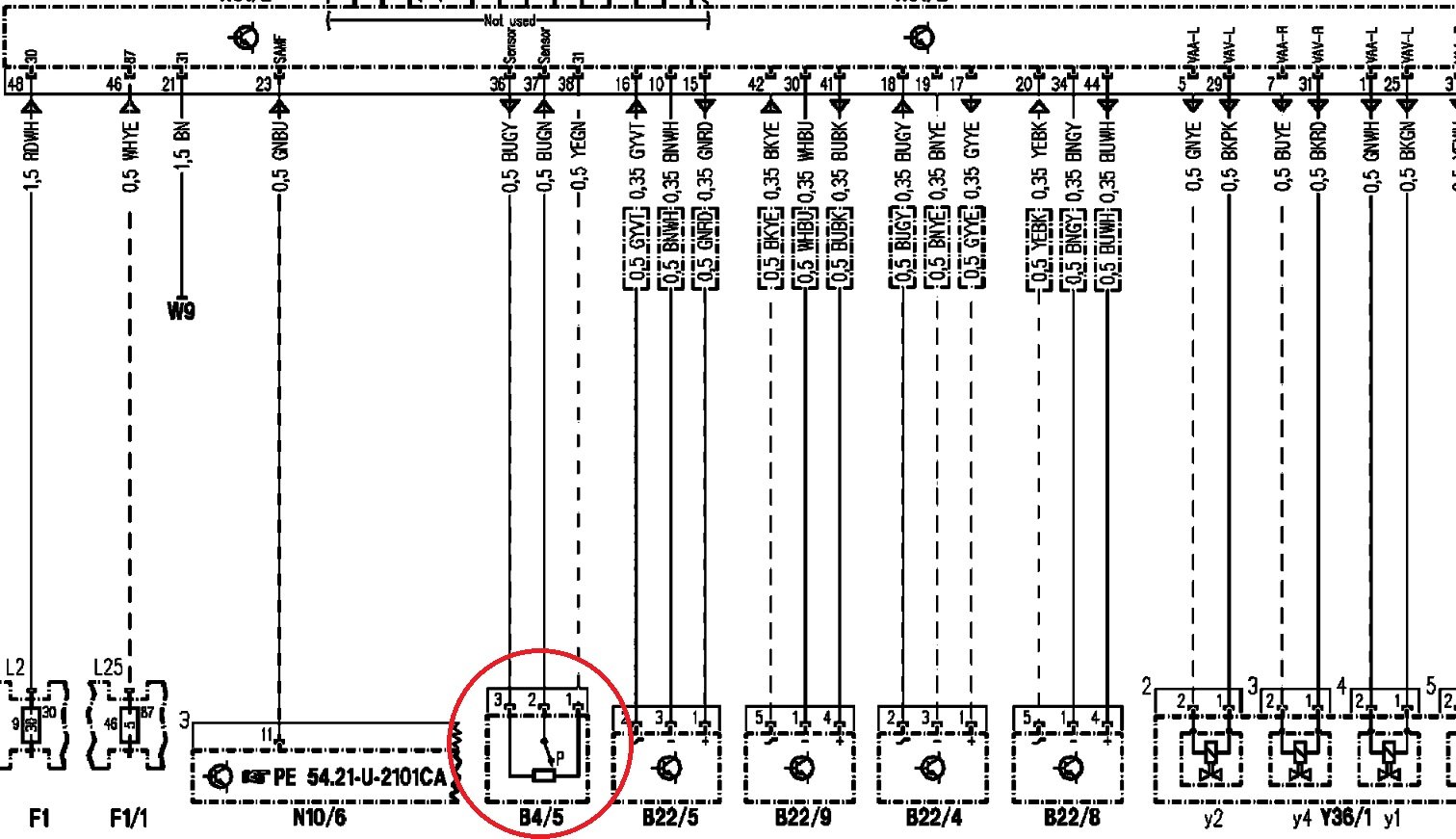

There is a sensor at the pulsation dampner (known as B4/5) and this gives a reading back to the car's computer as to whether there is enough pressure. The sensor requires a 5Vdc supply, and the output from it varies from 0Vdc to 5Vdc, with the higher voltage being good pressure, and a low voltage being bad pressure. This seemed like a good place to start, and previously I hacked into the wiring so that I could take some readings with my multimeter while the car was running.
There are three wires at the sensor, but at the time I did not know what they all did... I took some readings between them, and this is what I found:
Yellow to Blue = 4.96Vdc
Blue/Green to Blue = 4.36Vdc
Blue/Green to Yellow = 0.5Vdc
As I say, I had no idea which wire was which... so I did not really know what this was telling me. For sure two of these wires are the 5Vdc supply to the sensor, but I did not know which :lol:
I purchased Mercedes WIS, which has all the maintenance info, and I found to be utter garbage. It is so badly laid out and did not seem to have any diagrams, just photos and labels of what everything was. Then I stumbled upon a wiring diagram section #-o
This diagram gave me the answers I needed!
So obviously pin 2 on the sensor is the output, so it was just a case of determining which of pins 1 and 3 were the 0V and 5V. Looking at the other components on the page, the arrows at the top of the lines seemed to show powered lines, and so I took a flier that pin 1 must be the 0Vdc, and pin 3 (with an arrow showing power going "in" to the sensor, would be the 5V supply. So that gives me the following connections:
Yellow/Green = 0Vdc
Blue/Grey = 5Vdc
Blue/Green = Pressure output signal (relative to YL/GN) 0-5Vdc signal
...and from that I can reshuffle my readings to:
YL/GN to BU/GY = 4.96Vdc (this is the 5Vdc supply; good to know it's healthy).
YL/GN to BU/GN = -0.5Vdc... (ABC hydraulic pressure, so in effect we have no pressure recorded at all!)
So I now feel pretty confident that despite my brand new pump, I have no pressure! This at least means it's not worth looking at the strut valve blocks yet, as it seems that there is no pressure at them.
So looking at the diagram again, what could be stopping the pressure from building up? The only things I can figure:
1) The new pump does not work... :(
2) There is an airlock in the new pump.
3) The ABC suction restrictor valve is closed.
So I think it would be the most unbelievably bad luck to have a brand new defective pump... and there is no way of determining that without buying yet another. So for the time being I'll have to leave that one to the side. It is possible for the pump to have an airlock, but I have pressurised the header tank with my airline, which is the given method for forcing out an airlock, and I have also removed the pulsation dampner and seen hydraulic fluid streaming out at pressure, so I don't think that the case.
This then leaves point 3, the ABC suction restrictor valve at the pump.
Then something came back to me... when I bought the new pump, the ABC suction restrictor valve electrical connector was damaged, so I swapped the brand new valve assembly for my existing one out of the old pump #-o
So it is possible I refitted an already defective valve from my old pump, into the brand new pump....
I'm hoping this is the case, as I am really struggling to fathom what else can be wrong with this car! :o
