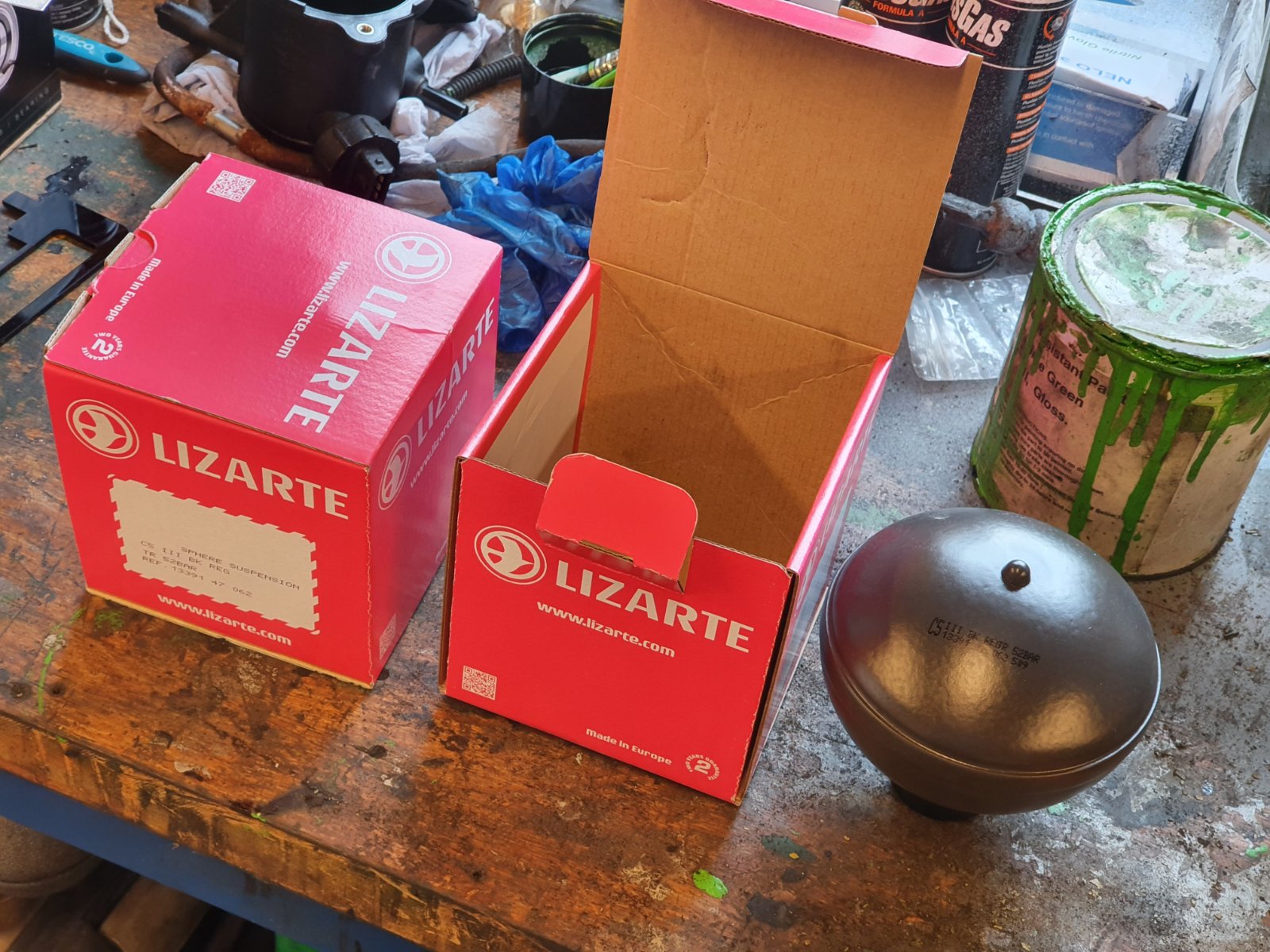

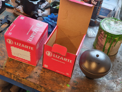

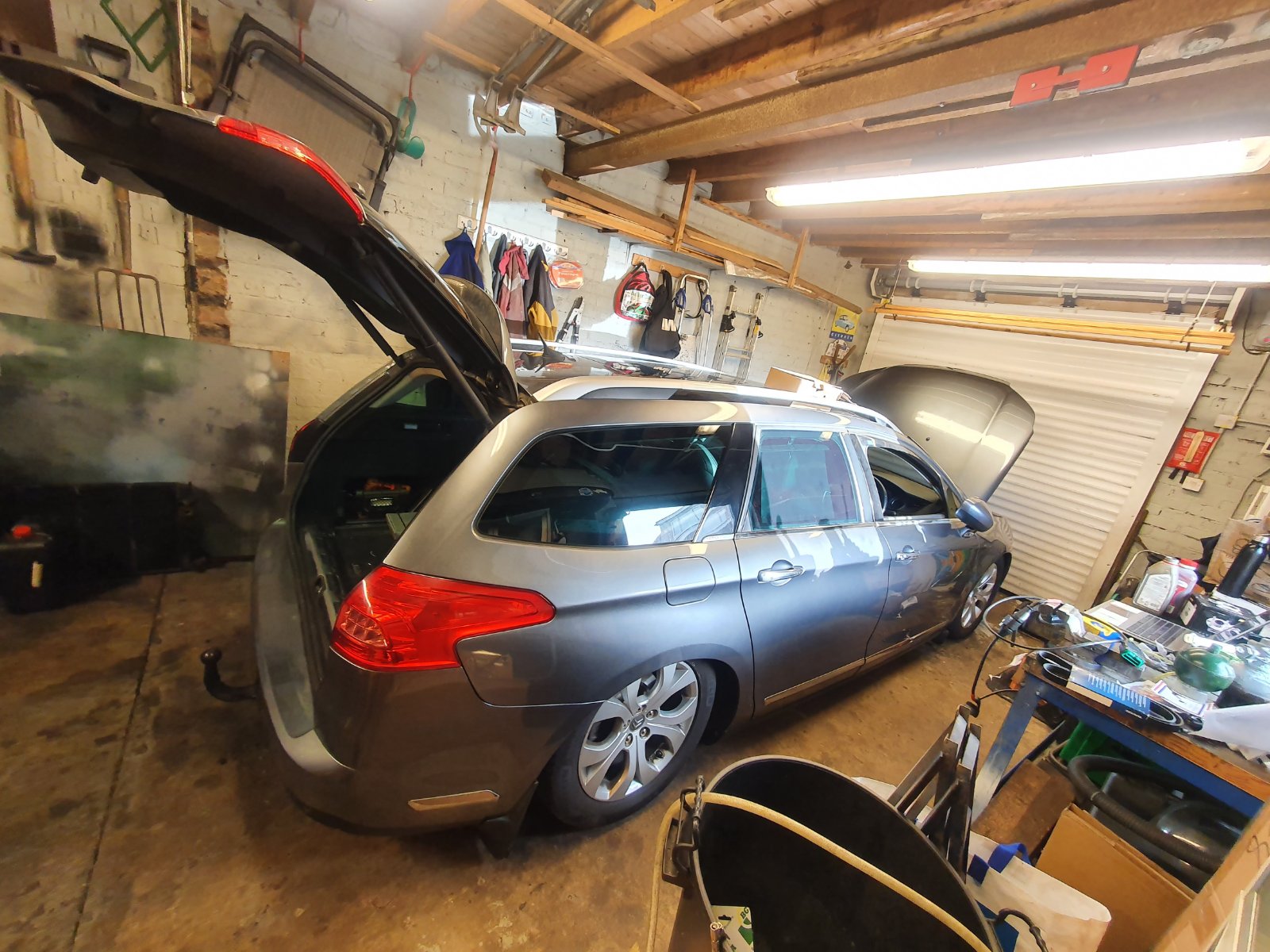

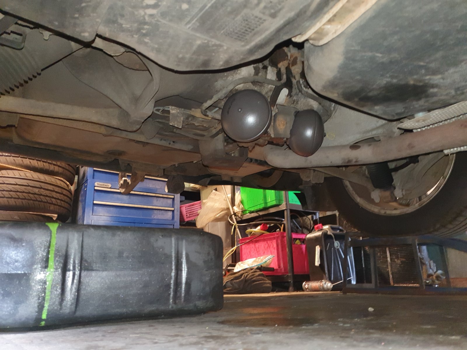

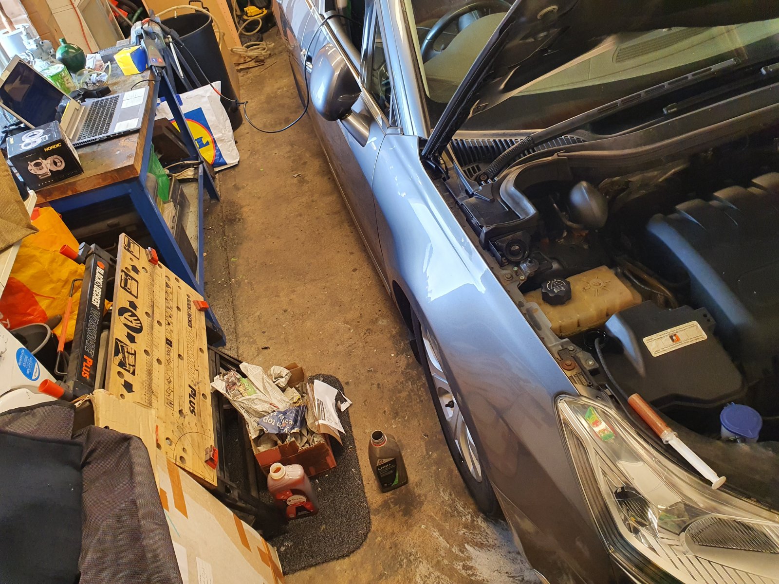

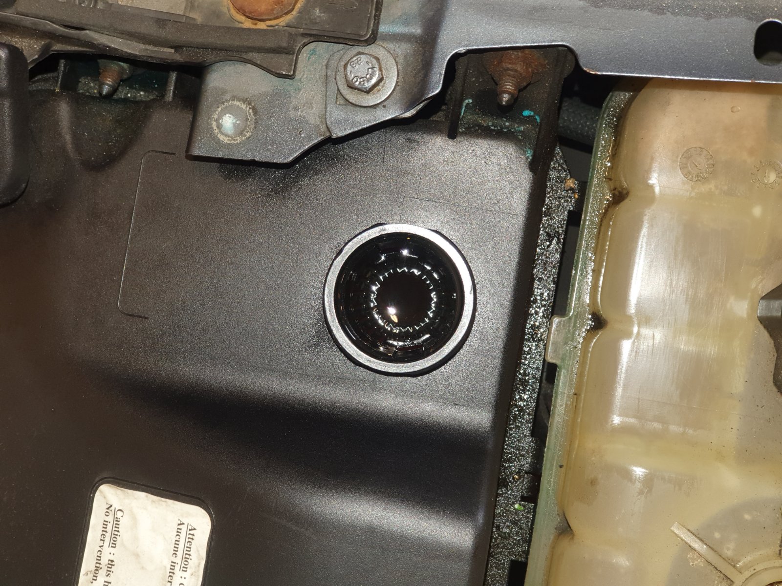

NEW SPHERES!

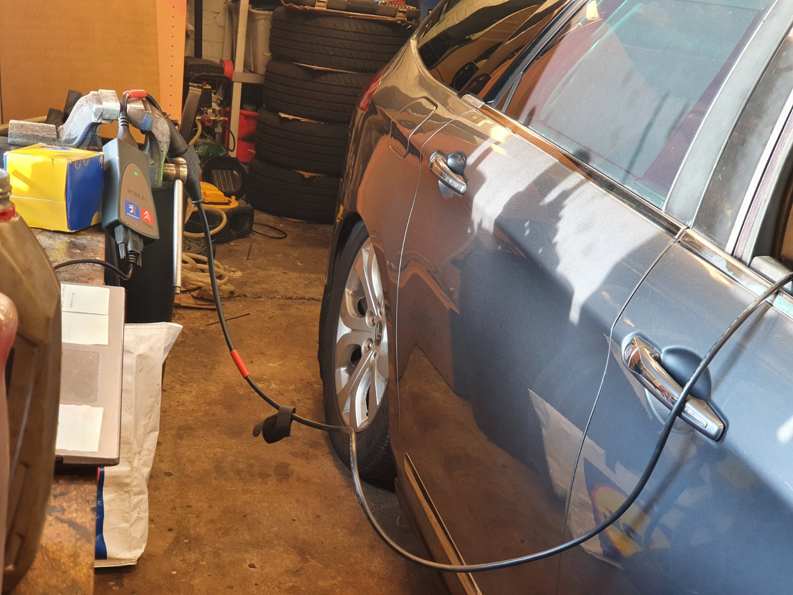

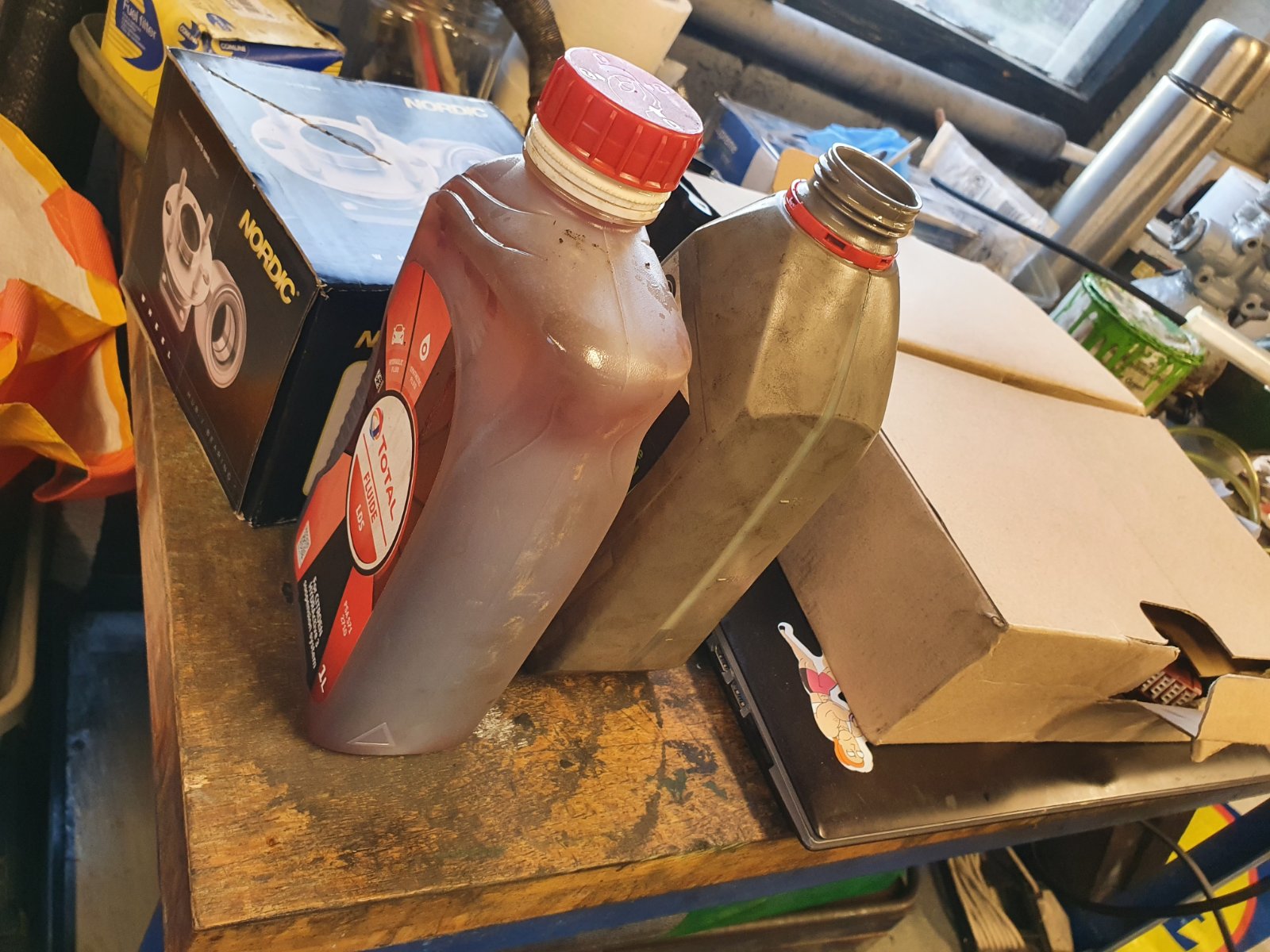

I had ordered 2 rear and one front center spheres in December - the rear pair supplied turned out to be not new and were in fact, front corner spheres with the damper valve removed. I complained and returned these and the seller admitted fault and refunded. The seller offered to supply the correct rear spheres for half price and free postage so I'd be daft not to.. The finally arrived! (I get a bit over excited about spheres). I realised with the rear wheels reversed up on ramps that it might be possible to depressurise the rear suspension alone by using the raise/lower switch in the boot. This worked a treat! just hold the lower button allows it to be lowered quite safely onto axle stands - you can lower in stages to get the stands adjusted better. Keep going until the wheels lift off the ramps showing the pressure is out the system. Sphere change was then simply a 15 minute job.
Afterwards I decided to use the lexia to fully depressurise the suspension to purge trapped air. I also wanted to drain the LDS because the garage who changed the steering rack left it overfilled. I wasn't ready for how much it was overfilled by! I initially used a syringe and diesel spill off hose to draw out the full 1l of LDS/DA before depressurising otherwise it would go one the garage floor!
It's pretty annoying, the garage wrote off the reconditioned steering rack fitting it as I reported, that's bad enough but this full litre and a quarter overfilled fluid tells me they don't know what they're doing. It's disappointing because they are one of the rare Citroen specialists.. other problems are there's been a rattling/ knocking heard when the engine is turned off, a new knocking at times low speed steering light braking (ok, could be my inner bushings wearing - not looked yet) and the suspension intermediate and high settings on the front suspension are not working properly. Paying for over a litre of extra LDS/DA isn't cheap.. I'm back to doing all my own work!!
Ran a global diagnostic and read through the log of historic faults and there was only one new fault and it was the suspension: temporary fault , something to do with no communication. I cleared this but it hasn't changed the front suspension faults.
Anyway, a nice afternoon playing in the garage.

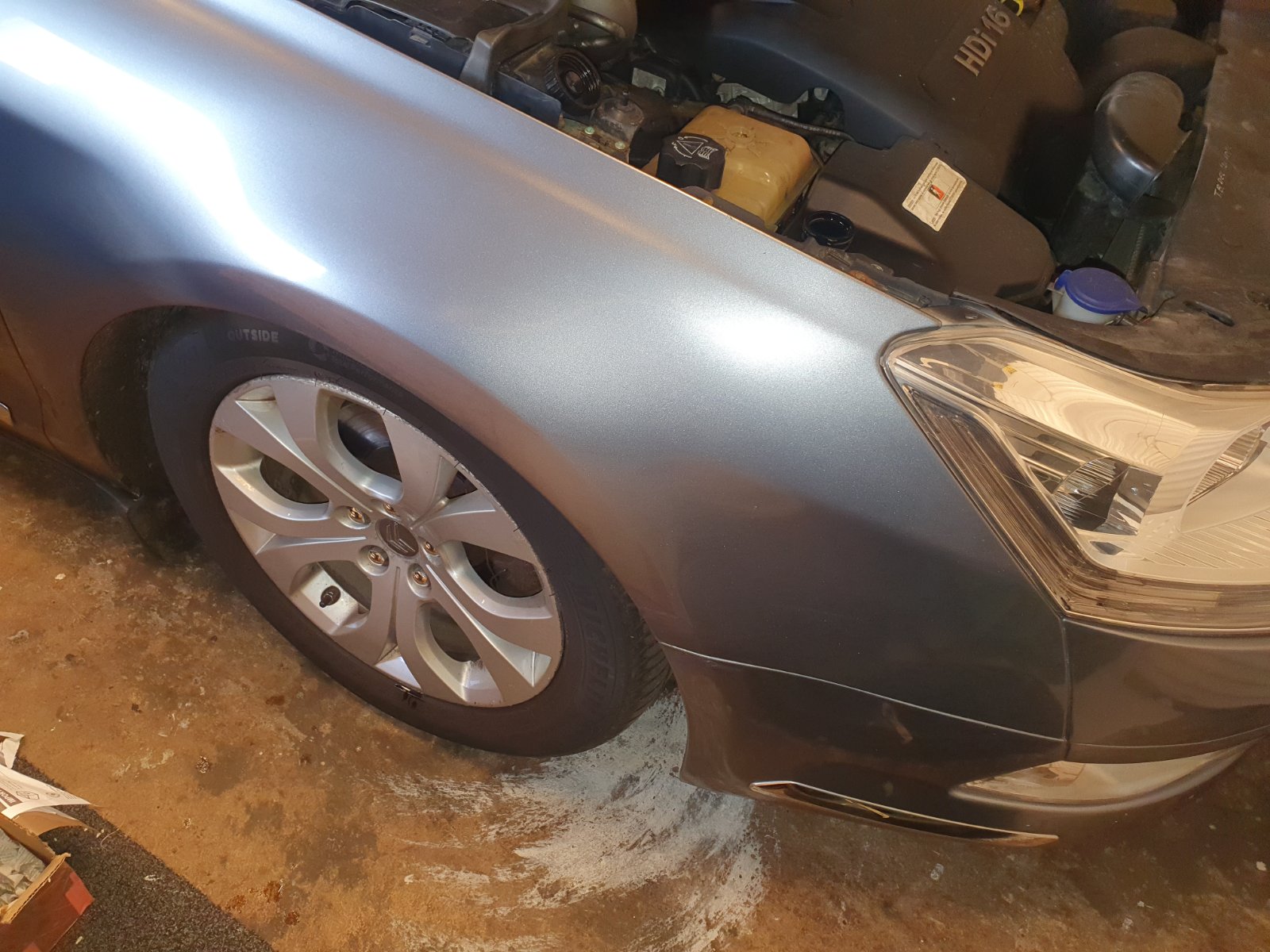

The C5 has developed a knock in the front end and it turns out to be the new steering rack!
Upon investigation the garage hasn't tightened the 2 nuts correctly and the whole track was moving. I've retightened them but don't know the torque. Anyone have the figure available?
I might leave the front undertray off for a while in case I need to retighten these again. It's there meant to be any threadlock?
I have a feeling that the garage having knackered the first rack might have been timidv in tightening the replacement rack. But don't know for sure. I'm less keen to get back in touch with them but certainly will if there's a problem. I've taken a video of the rack clonking loosely as the steering wheel was rocked.
