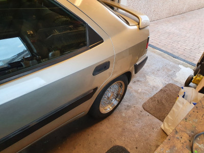

Hi James, yes it's up for sale alongside my Xantia. Basically I am selling one of them and can't really decide so leaving it up to the universe to decide for me.. I'll keep whatever one remains. Ideally I'd keep the C5 but annoyingly that's the only one to have had interest so far. The C5 just passed its MOT today with an advisory on a slight play in the LH steering rod. Incredible considering it has a replacement rack only 6 weeks ago... but I can't be doing with that Citroen 'specialist' I used so I'll probably replace the inner rod in the coming year. I recently fitted BBS replica wheels to the Xantia and it looks awesome now.
