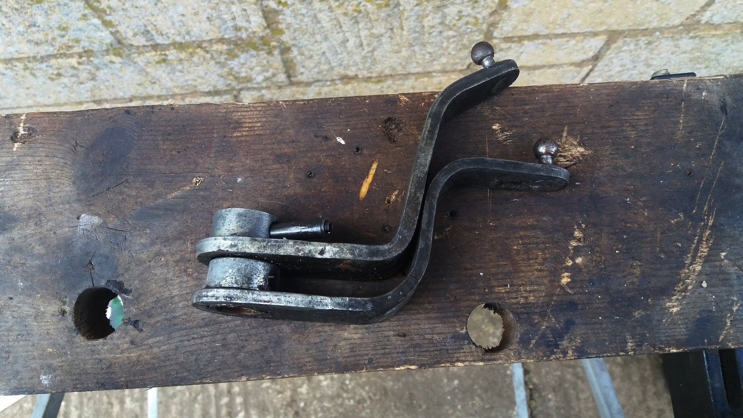

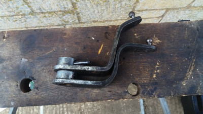

I've discovered the enjoyment (sic) of connecting up various electrical feeds multiple times, having fitted a feed, then found that something else should've been connected first so that the Looms 'reach' and can be kept suitably tidy, free from chaffing one another and away from Heat Sources and I've also learnt that ZX and 405 boxes have different fittings relating to the Gear Selector Rods, this wouldn't've been too much of a problem had I discovered this before fitting the ZX 'box, but in situ it was blooming awkward to sort.

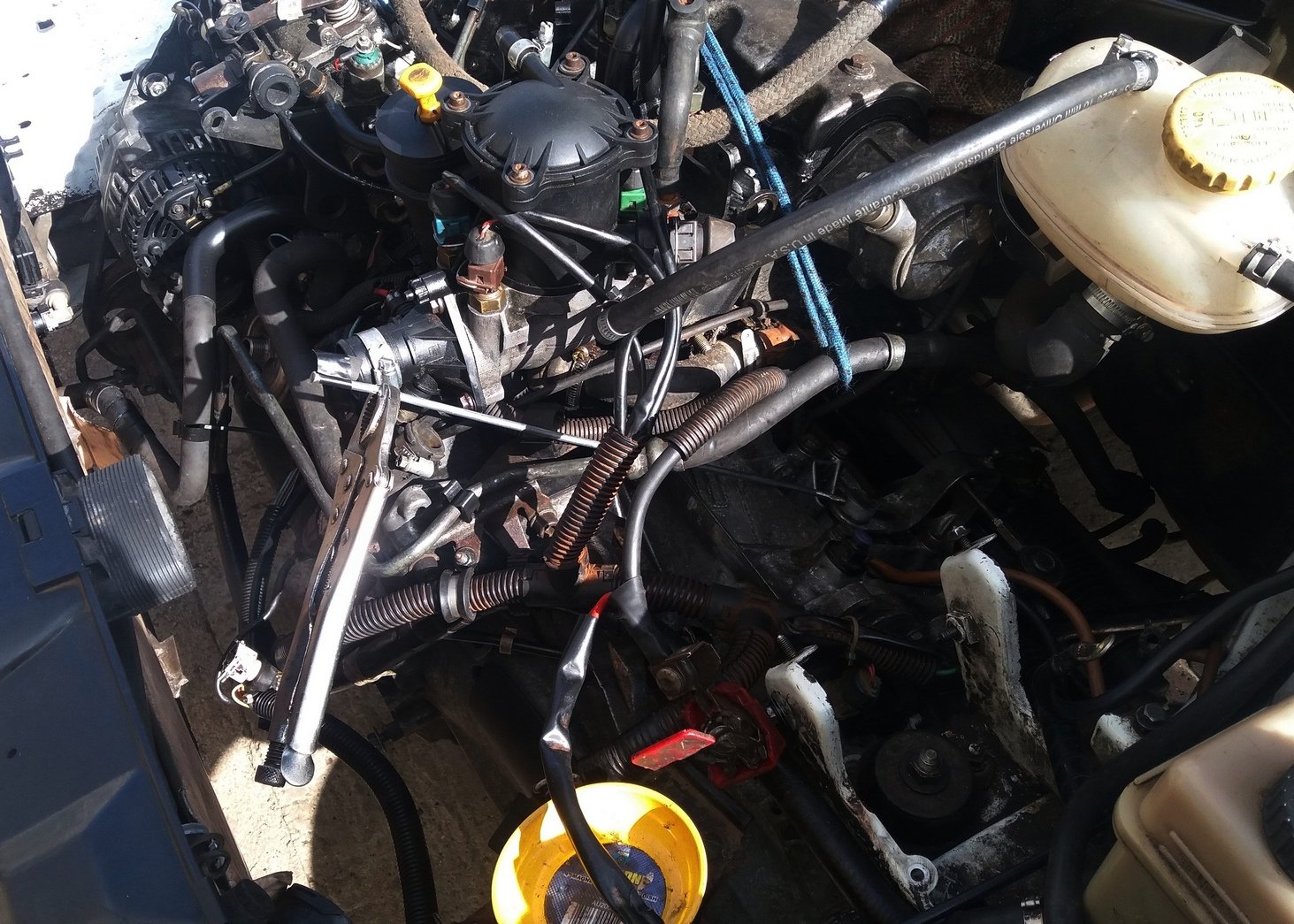

Hmm.... no power reaching the Stop Solenoid. Any suggestions?
Temporarily fixed by running a feed direct from the Battery
tis connected and does have the correct two connectors on it. Solenoid is operating normally but getting no feed.

just a moment's 'revisit' to 'finish' this Thread.
All's well. The issue on March 14th turned out to simply be the Accident Fuel Cut off thingy, where you have to press the under-bonnet Button to restore electrical power to the Stop Switch. The old girl's back to rude health and ready for serious use
...unfortunately Coronavirus has other ideas, so its not doing much mileage at the moment.
