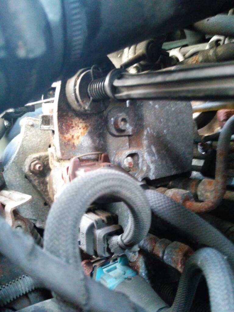

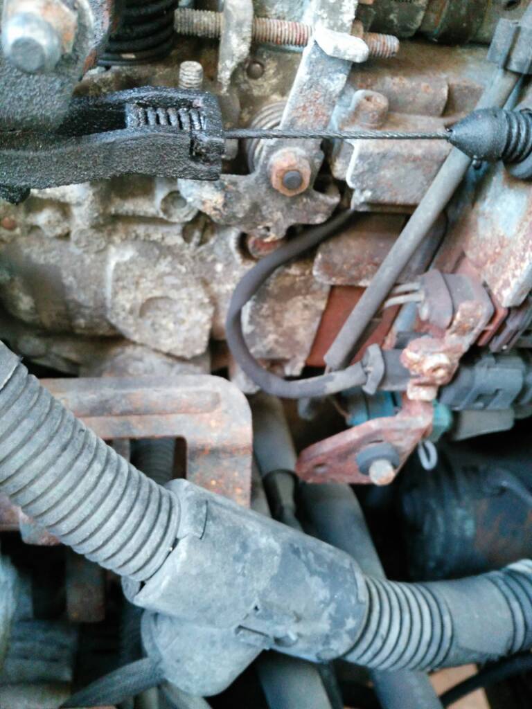

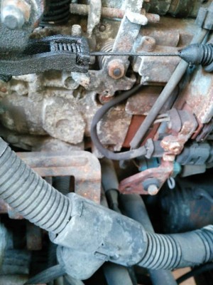

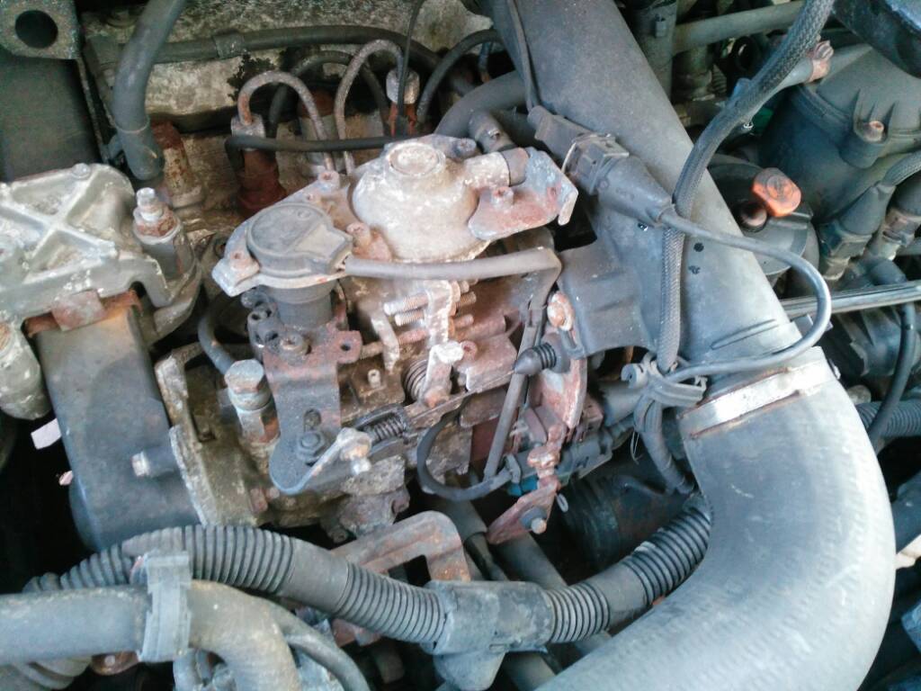

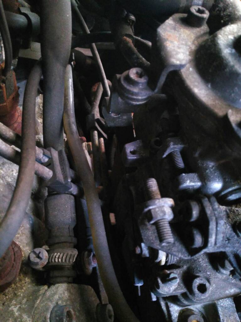

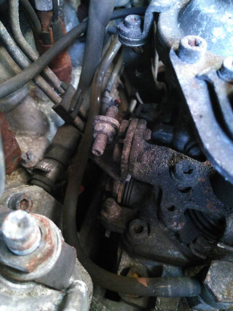

So here are some pics. The throttle cable might be a tad tight actually. I'll knock it back a notch when it cools down. Coming home the rpm crept up to 1000 but then dropped back again. However Its not the most user friendly pump location to take pics.

Taking our poorly grandson home to mommy and daddy today I noticed the revs fluctuating again. He is staying at home tomorrow as mommy has got a few days off work so providing the weather is ok I'll pop out and ease the throttle cable by a couple of slots.

Dave, what's on the other end of the Bowden cable that goes to the fast idle lever on the back of the pump?
demag
- Posts: 1441
- Joined: 18 Oct 2004, 05:03
- x 102
Re: Citroen Synergie 1.9td.
I'm not sure Jim. I couldn't see down the back of the pump I just held my phone there and clicked away. It really is tucked under the scuttle. If it stops persisting down I'll have another look later and see if I can trace it through. It disappears off into the gloom somewhere near the clutch housing.

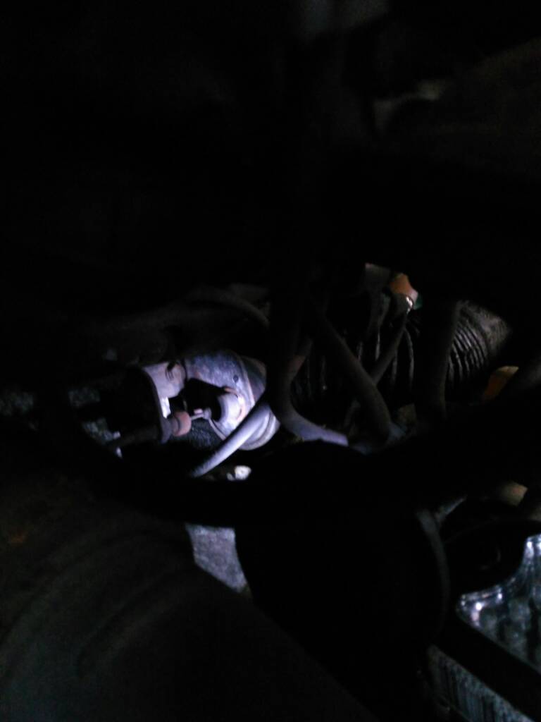

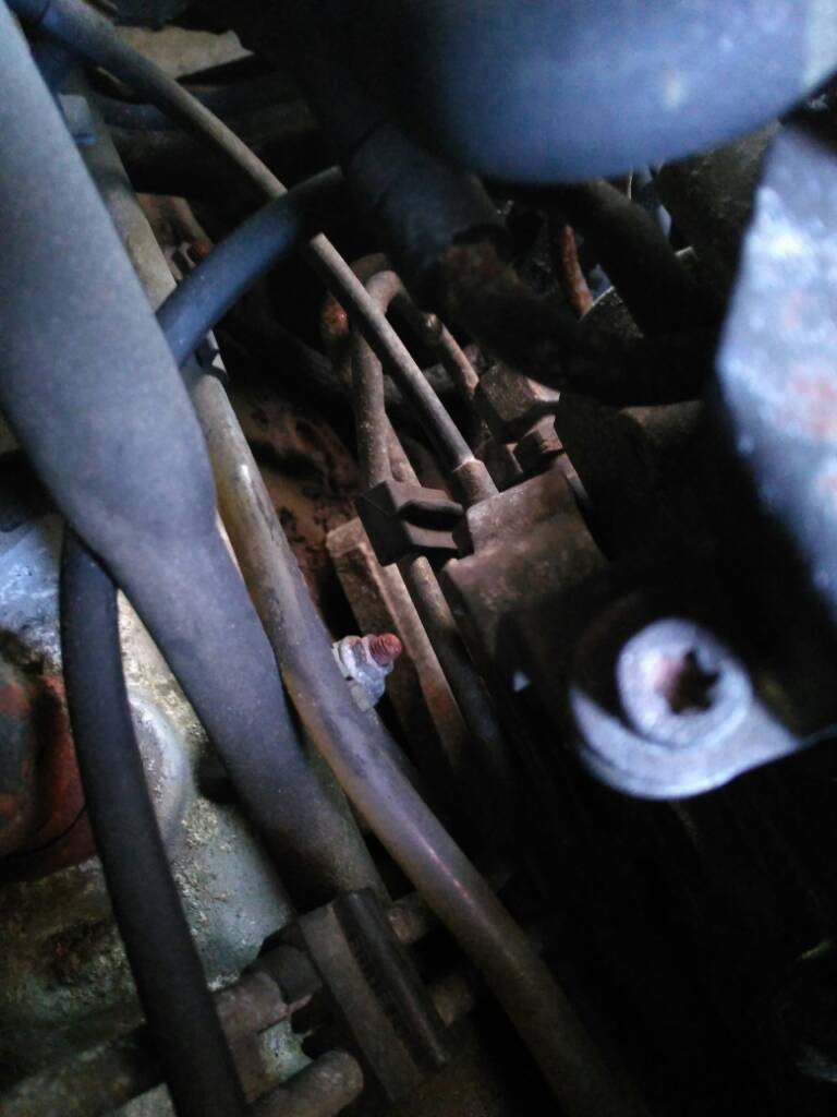

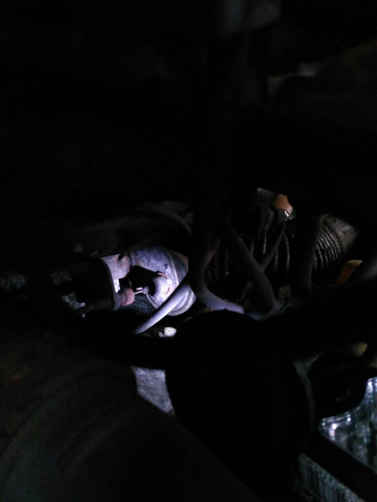

It goes to this Jim! I assume its some sort of waxstat, way way back in the debths. It was a struggle getting those pics. Holding a torch in one hand and phone in the other.
Sent from my Wileyfox Swift using Tapatalk
Dave
- Posts: 55070
- x 8391
If it is remote from the thermostat housing Dave, and has no coolant near it then that is a vacuum capsule. Does it have a black rubber pipe on the opposite side of it?
If yes then it's the same sort of vacuum system as on the later 1.9TD Xantias and I know all about those

I can't see the opposite side of it Jim it is ridiculously obscured. It is somewhere behind the header tank. But it may very well be vacuum operated as its not too far from the vacuum pump.

Excellent...
How easy is it to get some sort of access to it Dave?

I think if I remove the header tank and what I think is the intercooler-turbo airpipe I may get access. Looking from the front into the engine bay it's to the right of centre but left of the battery, sort of above the bellhousing but obviously bolted right at the back on the bulkhead. Strangely today tickover has been steady at 950rpm, yesterday it was hunting slightly to just over 1000rpm and before that stuck on1100rpm for a few days. Most puzzling and most annoying, I don't like racing tickover's except on warm up. On the Bx a cold start would put the engine straight onto 2000+rpm which I thought was ridiculous. After stripping and cleaning the carb I pulled that down to about 1400rpm which is plenty in my opinion, especially on an auto as when I put it into gear it wanted to take off! Very disconcerting.
