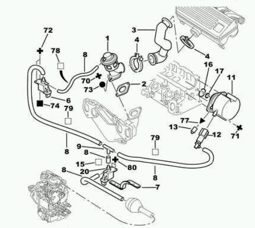

A similar problem to my 1998 1.9td Xantia has yours got egr by any chance? Exhaust gas reburn. I'm betting on the egr being blocked with carbon.

I don't know actually! Don't think so, but could be wrong. Where does it sit please, I'll have a look!

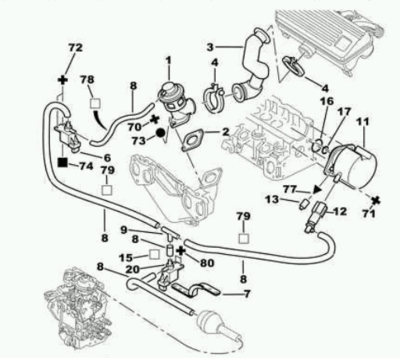

- x 6955
Re: 1997 1.9TD Estate - Re-test on Monday
It's number 1 in the diagram below

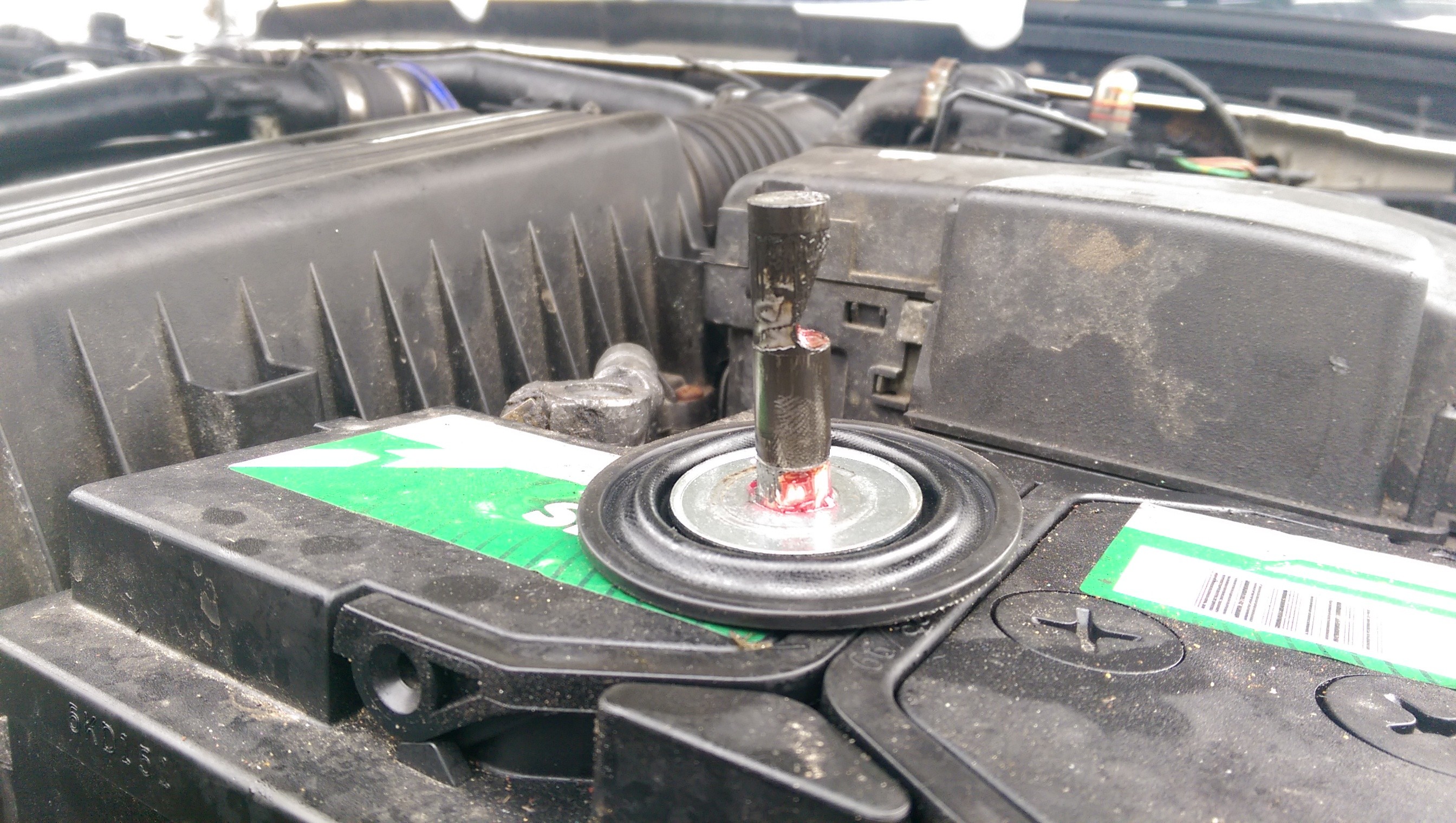

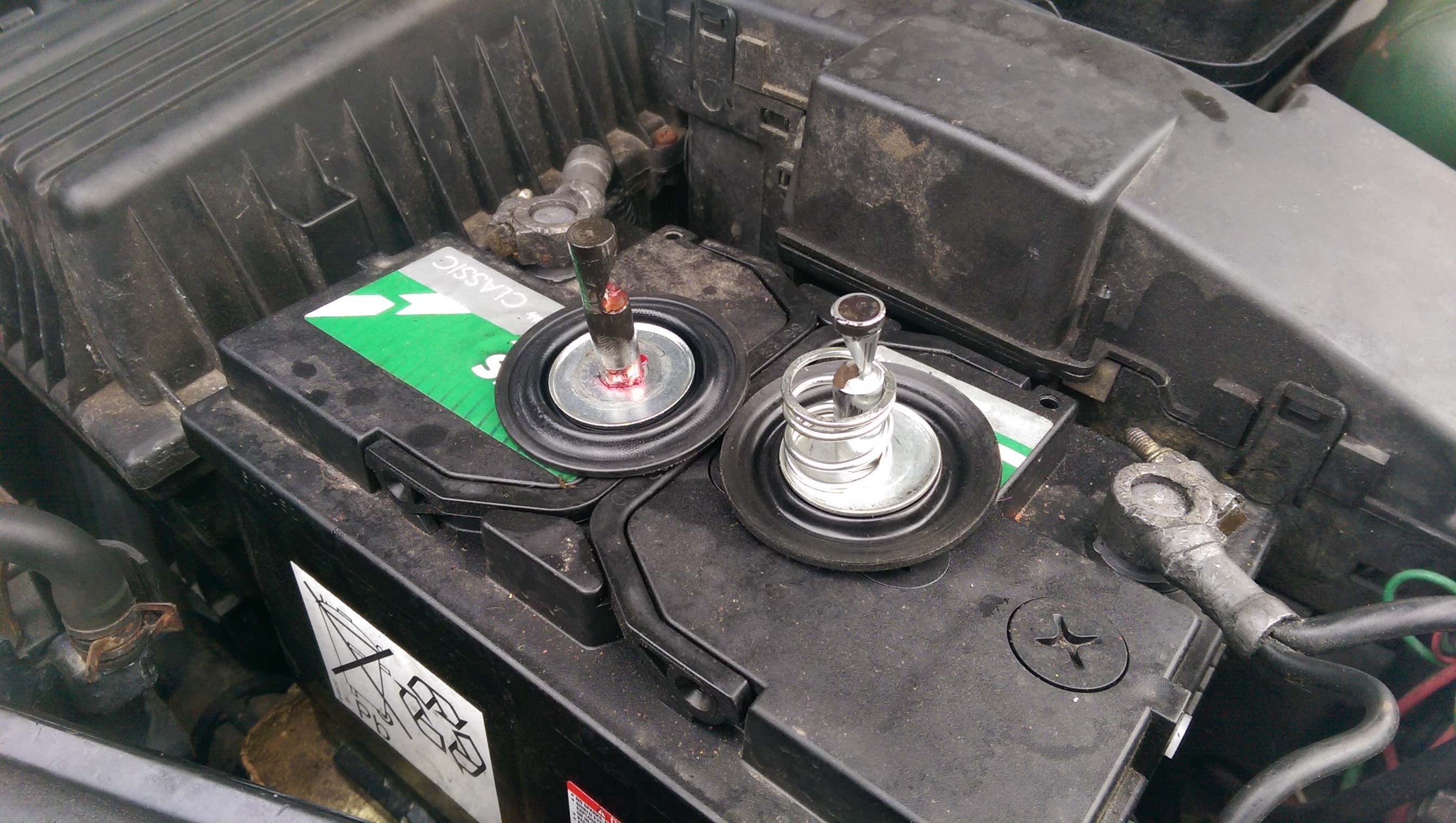

So, after my office christmas party last night, I woke up and went to Chesham to see a chap from Autoshite who was going to look at my fuel pump.
I didn't know what to expect, but it only took an hour, lots of that spent chatting! He took the lid of the UFO off, and withdrew the LDA pin
This is apprently custom made, he's never seen one this hardcore (he used to be well into 306's apparently, and has played with lots of 1.9td setups).
A quick rootle in his shed later and a less modified pin was extracted from a pump. It's been modified, but he said the other side is stock, so he fitted it back with that side on the business side
He marked either side for me so I can switch it round after the MOT if I wanted. He then dialled the fuel out 'loads, I've never turned it in that much, no bloody wonder it's been so rich', commented on the fact that the pump has been rotated, and the bottom bolt is missing. I sort of understand what he means, but only from what I have read.
Chinky - he did look and tell me there is an EGR valve fitted too. Apparently its a fiddly job to change it?
So anyway, what is the result?
Well the idle is ALOT quieter now. It's also heavily down on power to what it was. Before, at 40 in 5th, I could boot it and be doing 90 before very long. Now, I need to drop to 4th to go anywhere. It also boosts with a gently forward motion, rather than the slingshot it used to. In effect, it feels very much like my old ZX, IE standard! It's quite relaxing actually, I do rather like it.
But the big one, was the smoke. He revved it when we were there and declared it fine. I revved it when I got home with it nice and hot and it emitted a thin grey bit of smoke, which dissapated very quickly. No black soot! I did it 5 times and it was the same everytime. I'll try and get someone else to do it so I can see, but it's certainly an improvement.
So the plan is to get it tested next week. It will look slightly dodgy as I'll have to go somewhere else. I have no more holiday left, so it needs to go somewhere near work so I can do it on my lunchbreak. Hey ho, hopefully it will be ok, not much else to do bar give it a shot.
Hopefully it's a bit more economical too!
