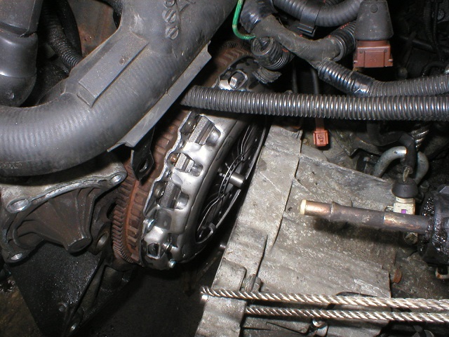

Re: Davie's Activa Clutch
New clutch is fitted
Alignment tool worked well. You can just see it peeking out in the picture... Enjoying a tea break now before mating the gearbox back to the engine... No chances taken with the clutch cover bolts. All six torqued to 20Nm with a torque wrench... Don't want one of those coming loose!
I did the Malcolm CitroNut trick on the clutch driven plate - I filed the leading edges of the centre splines with a small triangular file and then checked the plate was a very easy sliding fit on the gearbox input shaft... It makes mating the gearbox back to the engine easier...
Weather is holding out well
Well done Jim ... makes good reading. Cant see how you managed to torque all bolts in such a limited space though? By the way ... it's tipping down up here and thats the difference between working on the car and waiting till June arrives!
Sadly, false progress today
The position in which I had the gearbox to get the clutch in would not allow the gearbox to rise back so that the input shaft would clear the clutch cover without fouling badly...
I then had to remove the new clutch and try and find the position in which the old clutch just dropped out...
Found that but then found it impossible to install the new clutch single-handed... I tried and tried but failed ultimately.. I need some strong assistance and then it'll be OK... Else that I need to grow a few more pairs of arms, some of them very long...
My two arms I have are now scratched to bits
So, for now, until I have some assistance, job on hold... Sorry Davie
