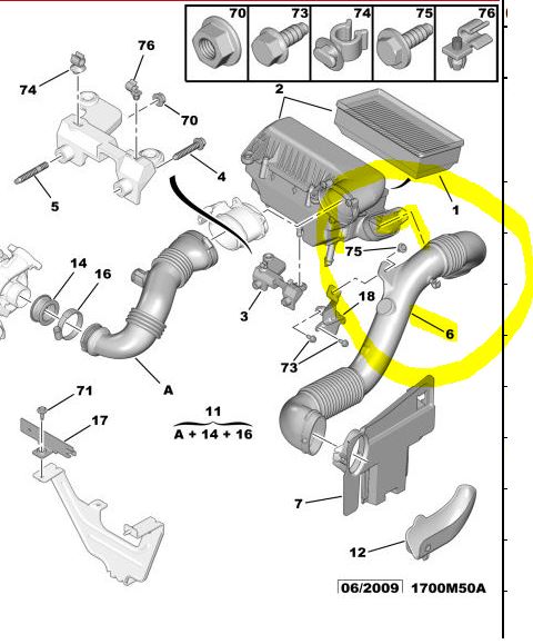

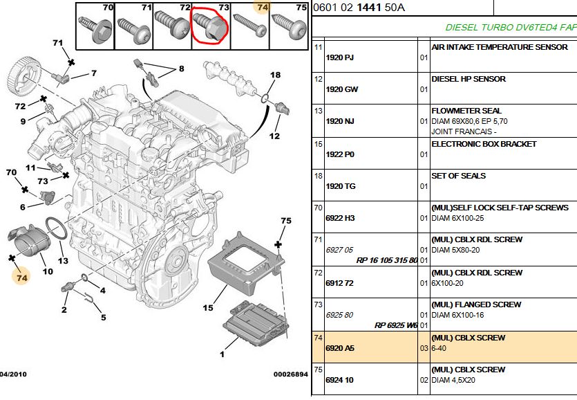

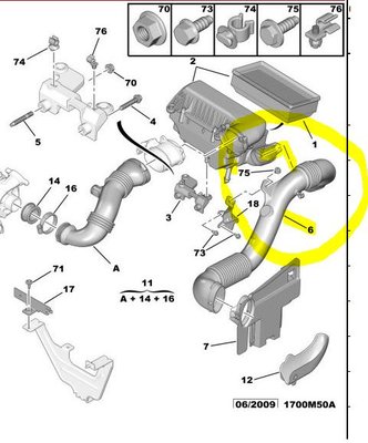

MikeT wrote: 17 Jul 2017, 15:50 Popped into Citroen's to see if I could get the missing sundries - they don't sell the rubber grommets, only a replacement brackets with pre-fitted grommets for £12.63+dreaded. Also, the MAF bolts (of which three secure the MAF) are sold at £2.45ea+dreaded in a pack of four!
Off to the bay of E for grommets (1422A3). Anyone got part number for MAF bolts, I can't find it on Service.Citroen (what section is it?).
ETA - scratch that, found it. They call it the Inj Calculator Sensor. Also, it states the fasteners are screws (no73) whereas mine has bolts and looks suspiciously like no74.
Spurred on by the economy improvements I decided to revisit the air box and the problem the cold air intake has staying connected to it, allowing warm air (and previous exhaust leak) into the air filter.
Thankfully, it was dead simple to swap the rubber grommets from the new bracket to the one on my car. Now the airbox is properly secured and sitting higher up I was hoping the cold feed pipe wouldn't detach so readily but sadly it's not the case as it's been "remoulded" over time to pull itself out at the slightest vibration
