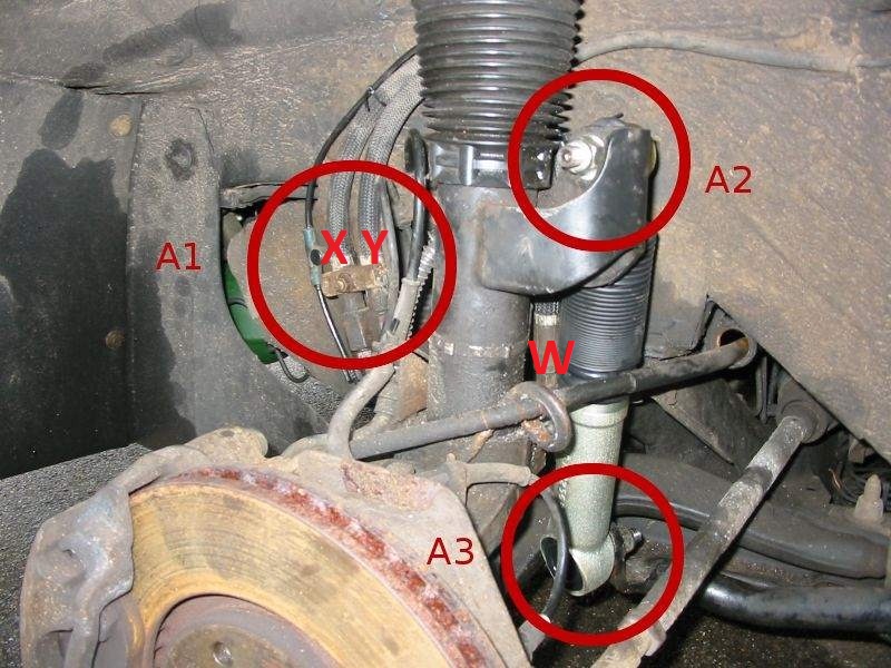

superloopy wrote:gonexantos wrote:Sorry. Repaired. Better?
If you are referring to pictures in the first post I can still see them...
