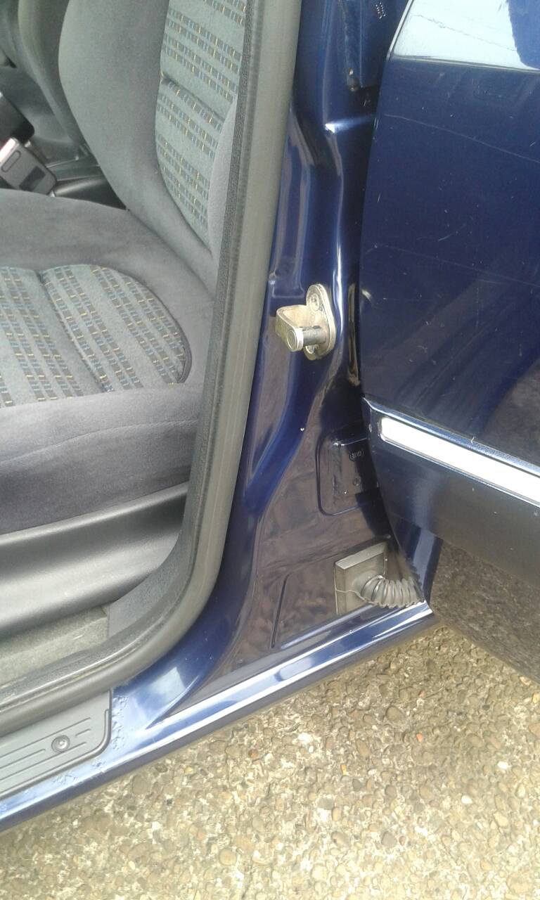

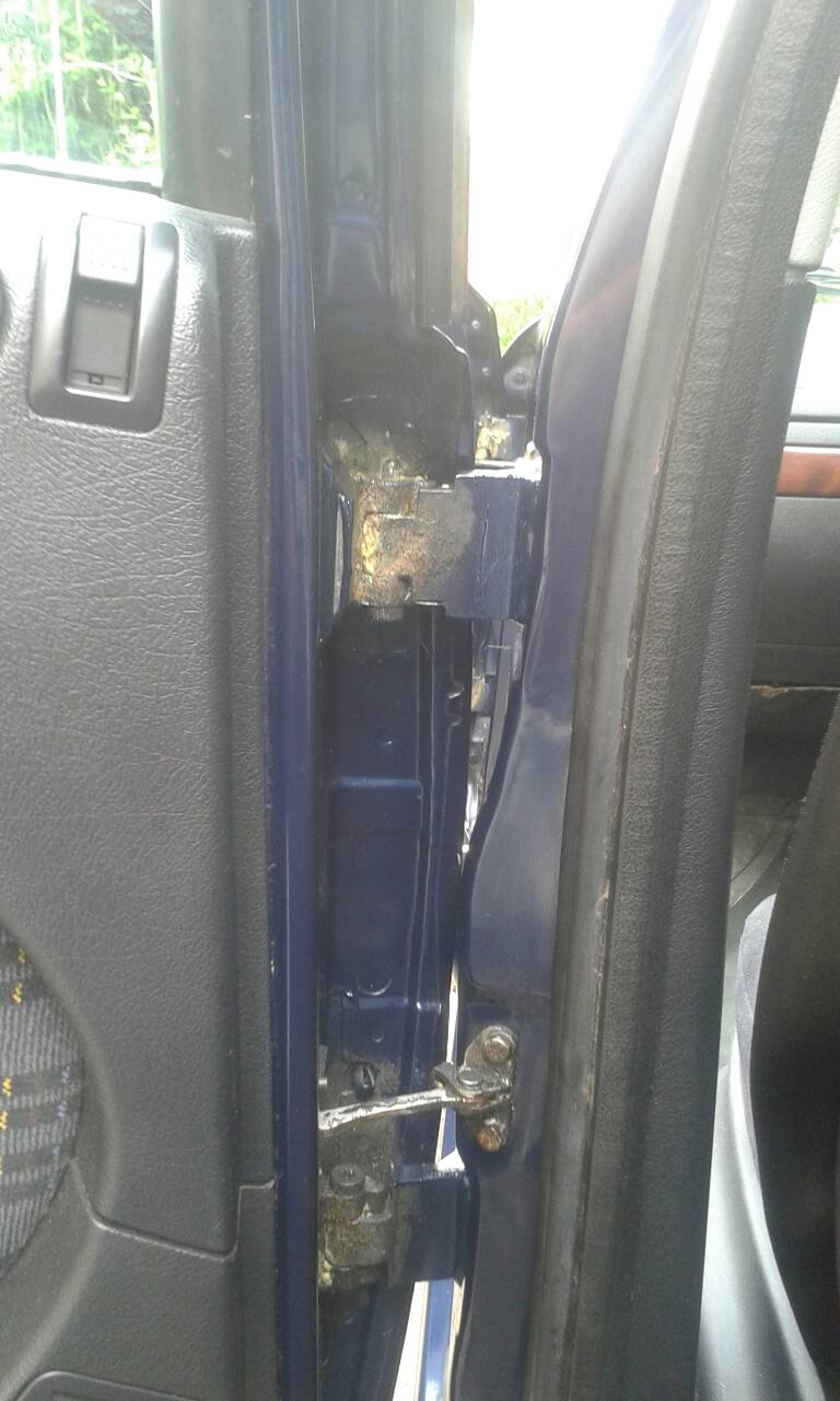

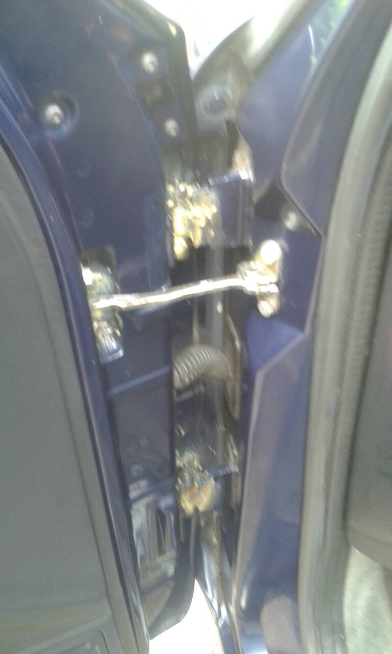

Thought i would give the old girl a bit of a clean in the hard to reach places. And give the hinges a bit of grease

Looking good ... i'll just keep doing what you're doing and she'll be tiptop soon [WINKING FACE]

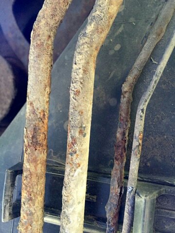

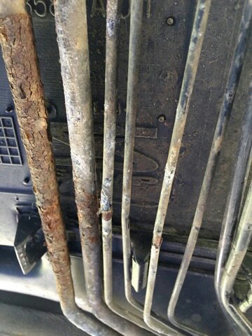

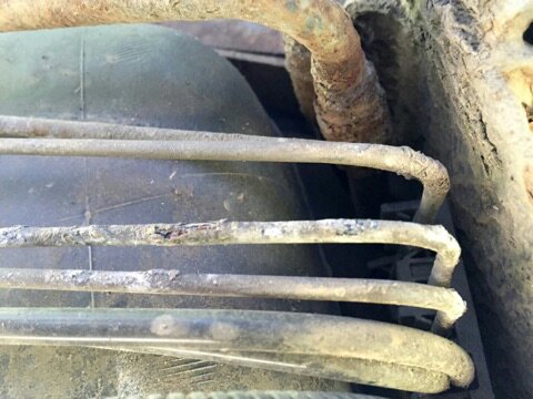

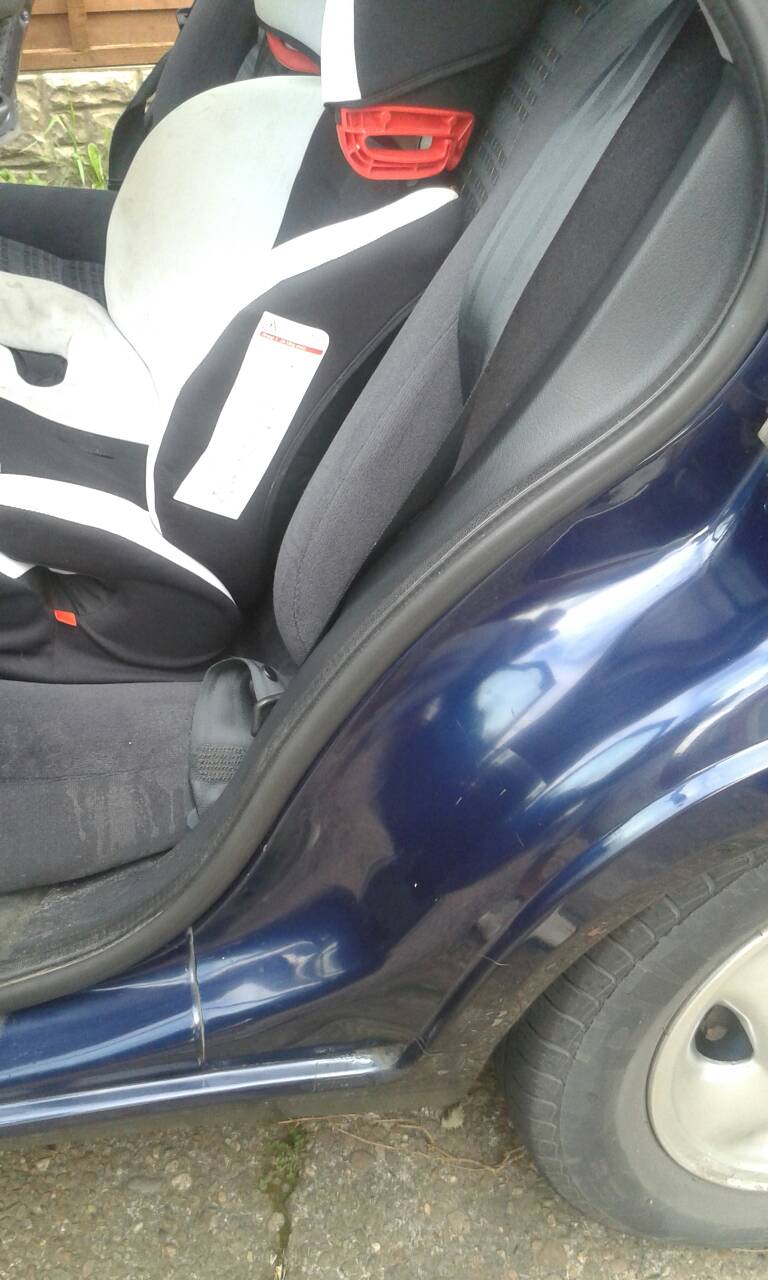

So any ideas where to go from here. Getting desperate now. This was found when setting about to do fuel tank. This is now on delay as don't want to rupture any of these. Where can i get replacement parts cheaper the better.

To be honest if they are solid metal pipes you've had it.
You could try a local hose specialist like pirtek and then clip flexible hose to the body. Ideally id go with stainless braided hoses to replace the fuel.
For the hydro pipes best getting the exact length and speaking to Plaides about some length being made up and sent up to you
Or sell it to me
Or sell it to me

I too was thinking plaides or some hydraulic specialists. As for selling that's a no go. Probably going to take the pipes off the silver Activa and get two lots of pipes made up.

Okay can find plenty of online places to get the 3.5mm and 4.5mm pipes but struggling to find the larger diameter pipes which are the worst. Help, anybody know what the exact size of these and where I can get some from.

Have you tried Pirtek for the larger pipes? Failing that, I'd be tempted to find the nearest size and then make up new runs using the good ends of the original pipes brazed onto the new runs...
I've done that in the past and it is OK.
