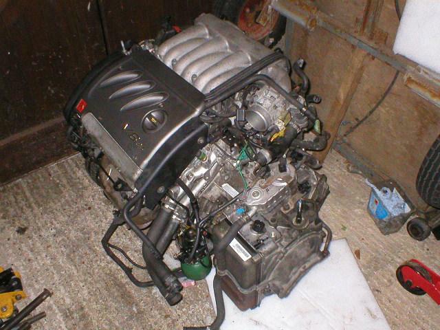

At the end of the job last night I marvelled at just how complete the engine and gearbox is when it is ready for fitting. It'll almost be like dropping in a cassette :D When Citroen describle the assembly as a power unit they're not far off...
I must remember that the flex plate bolts are not yet fitted as I can't get to the flex-plate until the engine is up in the air on the hoist.
I must also remember the engine is currently dry of oil. What a shame it would be if in my enthusiasm I fired up the engine with no oil. That would really ruin my day.
This evening I shall look at the best way of refitting the exhaust headers to the manifolds. The joints are made by the most evil spring clips you've ever seen :twisted: They're like over-grown EGR valve clips but with springs inspired by Arkwright's till :twisted:
The fabrication of a special tool may be on the cards...
Here's another view of the complete power unit..

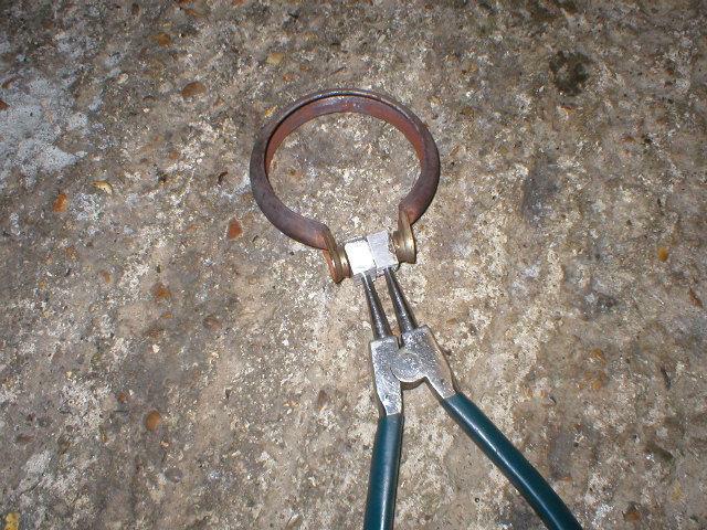

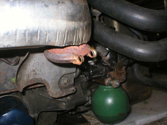

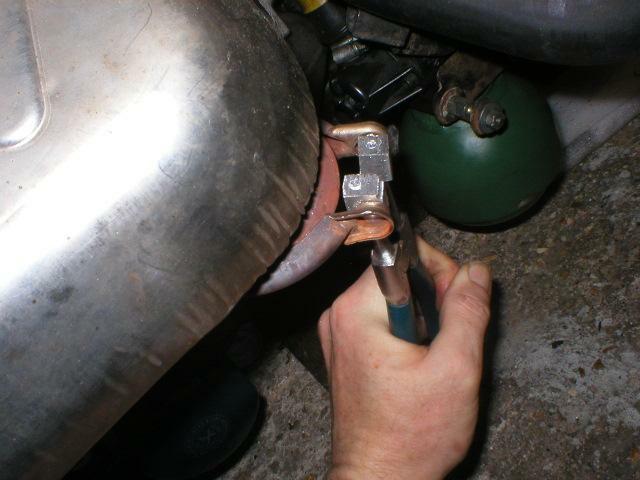

I looked at the exhaust header clip problem this evening. This is the offending clip...
I tried a normal pair of circlip pliers on it but they just succeeded in twisting the clip rather than opening it up as the taper points did not make flat contact with the faces of the clip. I then thought about it and came up with the idea of making a couple of pads out of aluminium blocks that would slip over the ends of the prongs of the circlip pliers. I came up with this:
This is the tool in action:
Works like a dream :D

Good to see its coming together nicely Jim, and good luck for the weekend!!, not that you will need it though im sure :wink: :D
Also, that exhaust header........you could just put a standard split exhaust clamp on it, but im not sure which of the two would be easyier to do up with the engine in though........................

nice simple tool Jim, :D my threaded bar took a while to seperate the pesky thing!

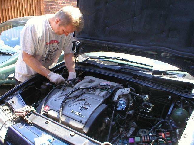

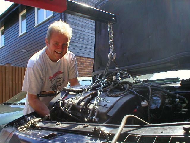

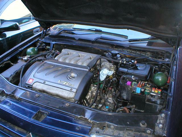

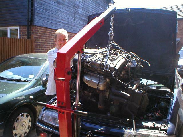

Firstly I must say a huge thank you Richard (DickieG) for all your sterling spannering and help today. The engine is now in and very little work is left before the finges get crossed in earnest and the key is turned. Just the radiator left to fit along with some small items, not forgetting coolant and oil and then we'll know if the car does actually live :roll:
Here's a few pictures of the moemntous occasion.
Richard beginning the careful guide of the engine home.
A bit further in!
It's a tight fit :lol: I wondered if it was actually necessary to remove the engine mounts complete, the fuse box and ABS block but it surely was. To get the engine this far, the crank pulley had to come off :o
Getting close now :D
Nearly done!
And one very happy Citrojim :wink:
A brilliant days' work and Richard, you're an absolute star :D

Excellent work Jim and Richard looks like a day well spent :D :D
Dont worry Jim we will all have fingers crossed waiting for the first key turn :) :)
Colin
Posts: 28653
x 5662
Nice going boys! That is certainly a very tight fit Jim.
Hoping it fires up nicely and behaves itself for you.

It was a very enjoyable, productive day (helped along by a couple of excellent Bacon rolls made by Val) and so good to push the project that little bit further towards completion, as Jim states its now just a few hours away from the nervous moment of turning the ignition key [-o<
BTW Jim I spotted your Activa on the way home (I drove straight past it on the way there without noticing) well its not easy to recognize one of your previous cars especially when its red :roll: :lol:

Does look like a snug fit in there :lol: and the weather was on your side too,
Good luck for the big day Jim.

Pah, looks like Richard was doing all the hard lifting work what did you need an engine crane for :lol:
Nice work chaps, be interesting to see it all working!

This is so good to see! Congrats everyone involved.
I think Jim's expression says it all \:D/
