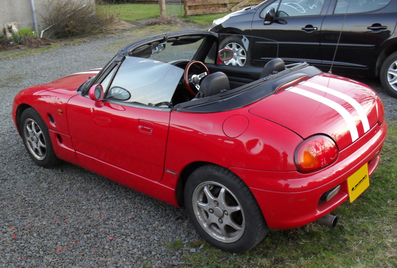

Is the scruffy thing a cappuccino?
Zelandeth
- Posts: 5329
- Joined: 16 Nov 2014, 23:36
- x 1607
Re: Zel's Fleet Blog - Pug 107, Saab 900, Lada Riva, Skoda Estelle & Sinclair C5
Yep.
Sadly had to sell it on when I discovered that the only thing holding the driver's seat in was the fuel line...likewise the carpets looked to be holding the floorpan to the sills. I'd have gladly sorted it, but just had not the time.
Happy to report that it was restored by the gent I sold it to and has been seen on a few occasions. Would buy it back in a heartbeat.
Really surprised me how easy it was to live with as a daily driver, for all I was expecting it to be a "toy" when I got it. I mean look at it... it's the size of a postage stamp.
Only things it really struggled with were shifting large stuff or more than one passenger at a time. Oh, and changing headlight bulbs was a royal pain that involved removing the wheels and wheel arch liners. Other than that it was a reliable, surprisingly comfortable, economical little runabout. Was just as happy to cruise gently as barrel along flat out - though it was rather good at the latter. Especially given the exhaust note when the engine really came on cam at about 6000rpm was somewhat addictive.
...especially in tunnels.
Proper sports car I say. No need for massive power figures (we reckon this one was pushing roughly 90bhp at the wheels), just keep the weight down, get the balance right and most importantly - get the steering right.

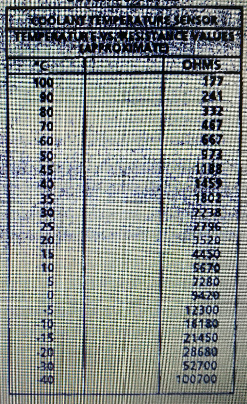

Had a look at the value of the coolant temperature sensor...I measured the coolant temp to be 23C at the time (engine hadn't been run yet), and I got a reading of 3.3K ohms plus pocket change.
Let's look at the chart in the manual...
3520R at 20C or 2796R at 25C, so that number looks plausible.
I did note though that the pins in the connector look quite tarnished, so I've given them a clean up. I also noted that wiggling the connector occasionally had an effect on the engine idle speed - so keeping an eye on that.
I also want to do a hot reading of that coolant sensor in case the values are going way out of whack as it heats up.

Sensor looks OK at 23C Zel but drop it in a bowl of ice and then in a pan of boiling water to be sure it's good at both ends..
Also, bring it up from freezing to boiling slowly using an analogue meter to look for sudden jumps or open-circuits at some temperatures... It's rare but not unknown...

That's exactly my thinking Jim. I've had them show dropouts or noisy readings at specific temperatures before. Also going to attach a meter to the ECU end of that connector and wiggle the loom and sensor itself and see whether there's any variation. That branch of the loom is the only bit of the whole lot which showed damage to the outer cable trunking...so it definitely warrants very thorough investigation.
Need to stick a new D-Cell in the AVO though as the new one I put in there a year back is already dead...they seriously don't make primary cells like they used to...
