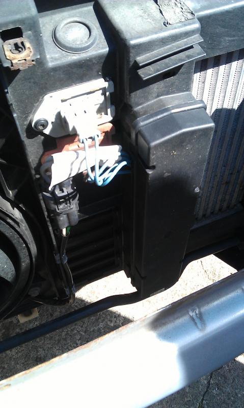

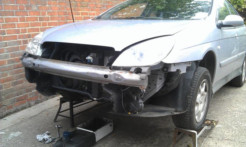

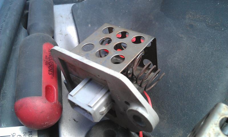

I thought it time to do a few jobs on our eldest C5 as it was due a service and a few niggles ironing out. I had also noticed that the low speed cooling fan was not working. To look at the relays and wiring for the fan requires the bumper to be removed, which is really a job for a few minutes:
After checking the wiring and the relays all seemed to be fine, however the problem was the resistor which lives just next to the fan. The grey and brown panels:
With the heat these seem to go brittle and break, stopping the fan from working.
I crimped it back together but I will be ordering a new pair and fitting them as soon as. At least this fix has got it working for now and its got some towing to do this week so a cooling fan is a must!

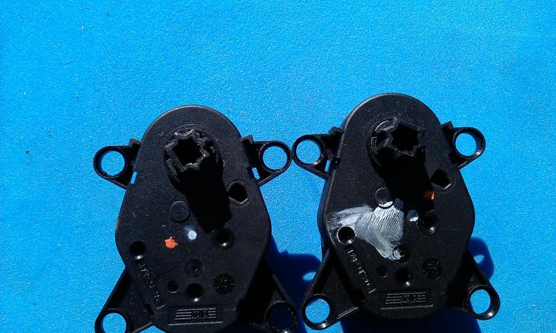

Next to be looked at was the heating system, the typical problem early C5s have of the passenger side of the dual zone climate control getting a mind of its own, usually being stuck on full heat. This is caused by the flap motor wearing away the fixture inside the dashboard, which leaves the cog on the motor free to do nothing but spin on its own. I had thought this is simply a bad design and is part of wear and tear, however there seems to be a bit more to it than that.
I have another motor which came from a low mileage C5, I set both motors to cold and compared them:
The original is on the left, you can see the flat spot on the cog it almost half a turn out from the one on the motor on the right. The right hand motor fits with where the flat is inside the dashboard. I guess the flaps in the dashboard become stuck and while the motor tries to turn the cog spins on its axis, however it is still a tight fit. From then on its trying to turn the heater flaps beyond their stops, rounding off the female cog inside the dashboard.
The fix for this is to buy a motor with a longer cog from Citroen, obviously a remedy for this wear, which reaches further into the dashboard and turns on fresh material. How Citroen can justify close to £80 for this little motor is unthinkable!
