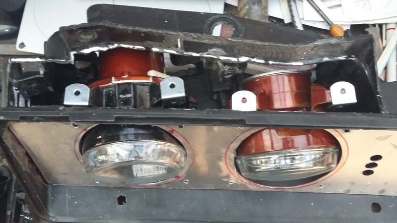

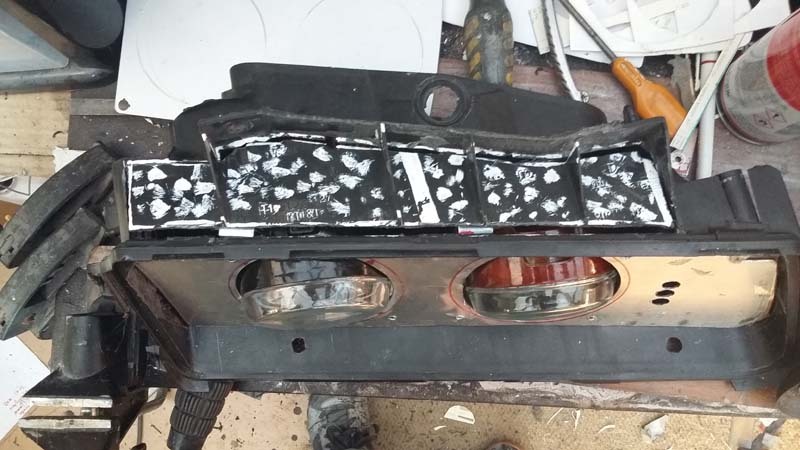

I will cut here.
Using a Dremmel and a large cutting disk I removed the top.
Ones the mounts are set up and metal supports are in place, the top part will be replaced and blended with windscreen sealant and finished to look like it is original.
this allows access to the top mounts and will give the few mm of needed clearance.
(glass will be replaced with clear thermoplastic blow down sheet)

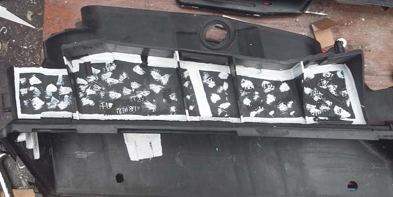

More layup/checking on positions etc.

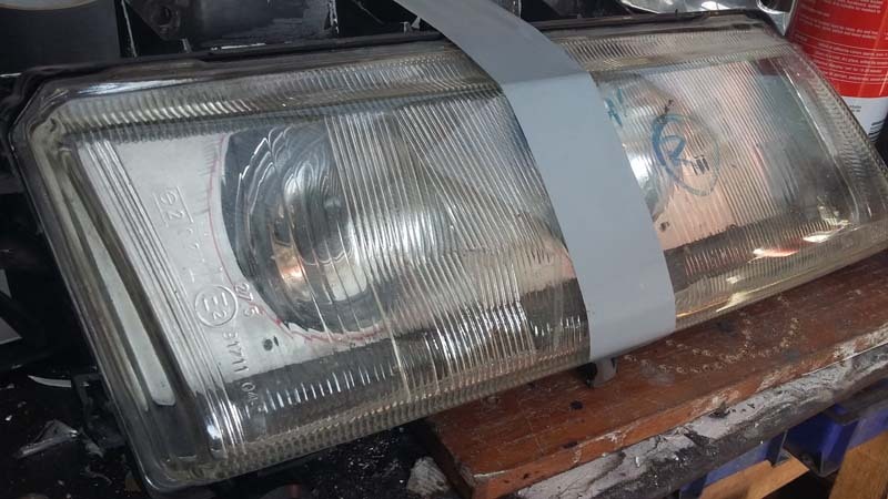

It all looks a little "rough" at the moment, but it is all just in temporary materials and hand cut.~
Re: LeD and Fibre optics, I have been thinking about this to replace the DRL's with a pair of brightly illuminated chevrons :)

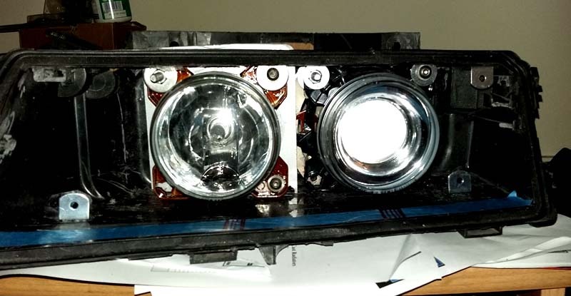

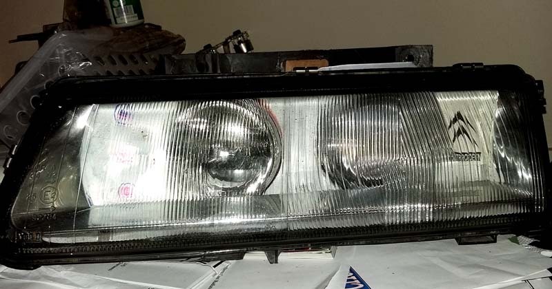

Well, both lamp units do fit (just !)
Mounting method is worked out and will be easy and will also be secure/preserve the OEM look.
Now onto getting the mounts cut neatly/correct thickness of ally, eg NOT with my angle grinder :) and onto the glass replacement.
Dip is inside the main so as to allow good spacing/vision of the indicators

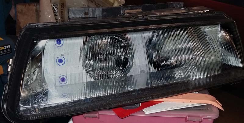

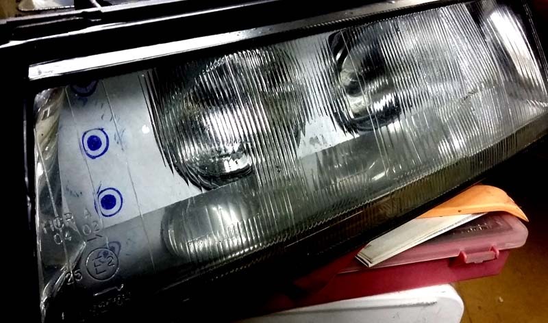

More work on the headlamps.
I have now worked out how to reuse the original headlamp inner chrome trims.

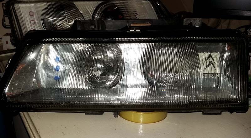

With added Citroen Logo

using foil to simulate a possible finish
