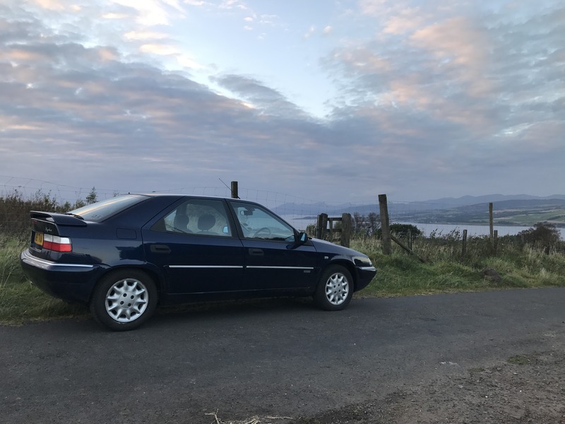

Once I'd topped the coolant up on the C5 yesterday afternoon and given it a quick clean under the bonnet I decided I'd do the rear discs and pads on the Xantia. They started to squeak occasionally a few months ago and then when I was out in it the day before the wedding there was a metal on metal noise from them. The parts were in the boot, the sun was shining and I was in the mood for some tinkering.
The drivers side caliper had twisted a bit so I took it right off, cleaned both surfaces and put some grease between them, the pad on the front was still pretty thick, the rear one was a little wedge shaped and down to metal at the top. After I'd refitted the caliper and bled the brakes, I used two thin bits of wood and worked the pistons in and out to ensure they weren't sticking. The discs and pads I took off were originals so they don't owe me much after 19 years on the car! Once both sides were done I decided that I might as well swap the wheels over.
I'm sick of the Michelin tyres developing flat spots and cracking over the winter. I'd kept the alloys from the V6 I broke 2 years ago to do the V6 conversion, and I'd kept the cracked Michelins that I took off this summer so I fitted them to the wheels, balanced them up and fitted them to the car before taking it for it's last gentle run before it goes into hibernation till next Spring.
It's amazing how it looks like a different car just with a change of the wheels. Whilst the Activa wheels are off the car I think I'm going to have them powder coated as the surface on the originals is bubbling in a couple of places and just around the valves.
Hopefully come Spring next year she'll be on top form for a couple of the rallies
David.

If the car is garaged for an entire winter, David, is it not worth putting it up on blocks/stands? That length of time is enough to put a temporary flat on most tyres, I would think. Failing that, some extra high pressure in the tyres could help reduce the footprint.

Looks all wrong with Exclusive alloys on it David...
Looking very sweet otherwise though
Personally, I've never had any problems with Michelins... My Activa Energys are still looking as good as new and they don't move much at all over winter...
Now, the Contis that were fitted previously were a different story entirely... They cracked up very badly...
