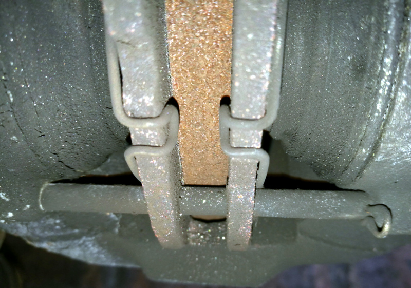

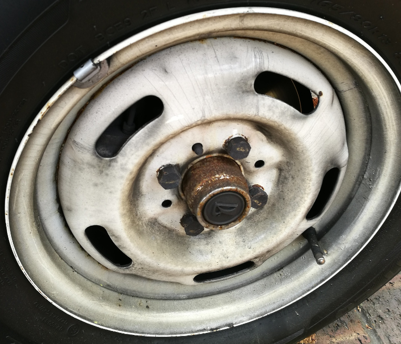

So I had a free hour this afternoon, so figured it was time to attack the brakes on the Lada. We all knew this should be a 20 minute job, but we also know what those estimates are like!
First off, the brake dust issue...This wheel was spotlessly clean less than a month and a couple of hundred miles ago...It's not exactly being caned around the Nurburgring either, even though I do accept that MK is a bit hard on brakes!

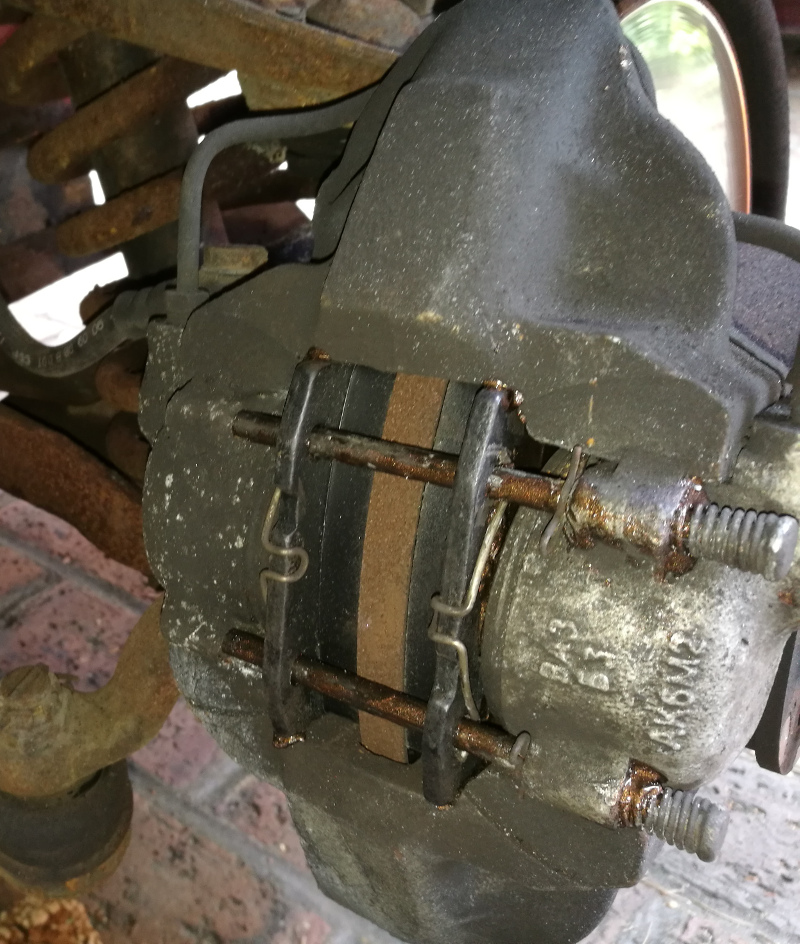

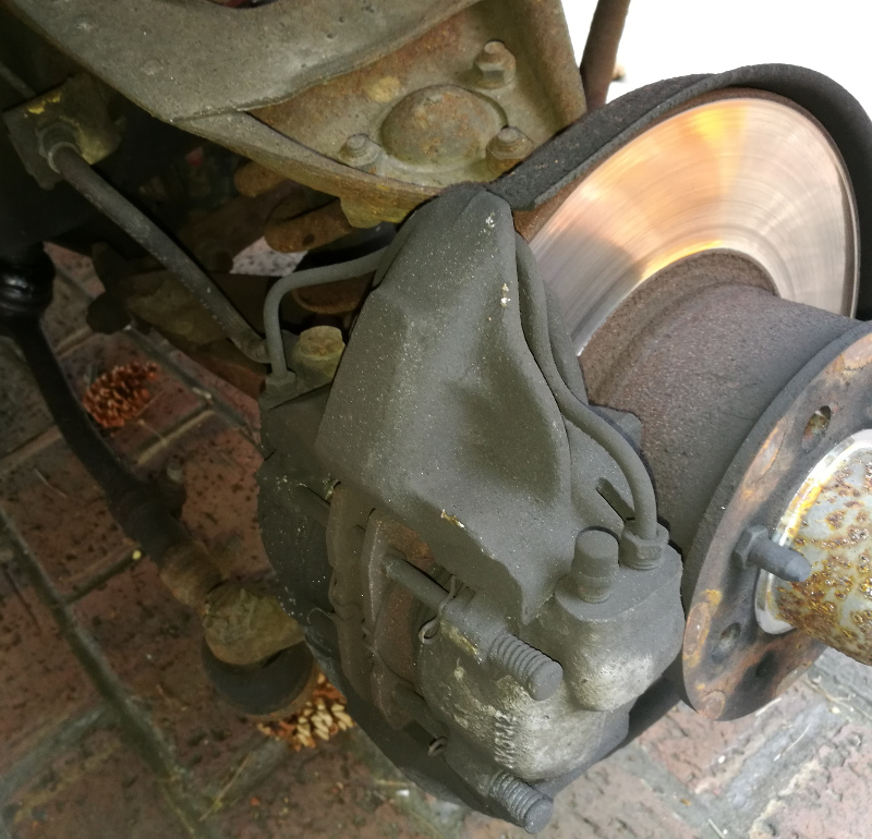

Wheel off, and confirmation as I hoped that everything was easily accessible.
Bit closer, and yep...think I can safely say that the pads have had it!
Actually was dead simple...The little spring clips pull out, which allows the two pins to be withdrawn, then you just lift the pads out (try not to get hit in the face by the anti-rattle springs as they attempt to ping their way off into an alternate dimension - I've done this before so had a hand in place ready to catch them!). Getting the pistons pushed back required nothing more sophisticated than a screwdriver to get it to start moving, then was done by hand once it was on the move.

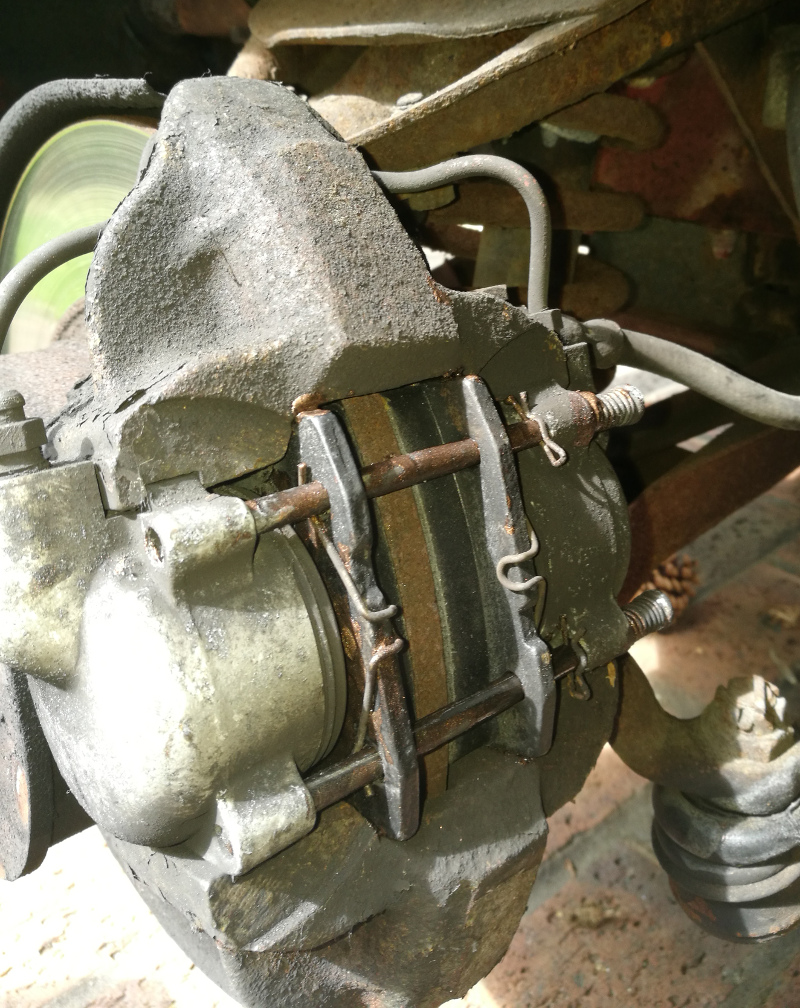

This looks a bit healthier now...
...as does the other side.
Had the wheels back on and was on the test drive in less than half an hour. Pedal travel is a bit better but not *great* but the brakes definitely have a lot more bite, even though they're obviously not bedded in yet. I want to do the flexi hoses as well anyway (just on account of not really trusting brake hoses from 1993), but didn't have time nor fluid on hand to do that today, so that might be a job for next week. The fluid that was pushed back into the reservoir when the pistons were pushed back was disgusting, so time for a change I think! If I'd had my brain in gear I'd have picked some up today beforehand.
Interesting that the nearside pads still had over a millimetre of material left on them, but the driver's side was down pretty much to the backing (though there was actually still a bit of material left - it was just the lip on the disc that was touching the pad backing). Both looked to have 93 date codes on the pads, so I'll keep an eye on balance as time goes on.

Those calipers look very well designed and engineered Zel!
Pleased it was all very straightforward :)

Thinking about it, that may be a factor actually though. Being a taper bearing here with a setup where there's always a tiny bit of play (if you nip it up so there's none at all you'll cook the bearing in no time), so continual heavy loading of the nearside front wheel may have some impact on pad life...who knows! If anything the car tends to pull a little to the left on braking (you'll rarely get a Lada that will brake in a completely neutral way!), so I'd half expected that to be the one that would show the most wear.
The calipers are nicely designed, dead easy to service - though I imagine it could be a right pig if the pins were seized in place. Having said that, the way they haven't been out of these since 1993 and pulled straight out, so that's got to stand for something!
Noticed that the castings of the actual hydraulic components look to be identical from left to right...Just the hub itself that's side-specific. So they've obviously re-used identical parts on the production line where they could get away with it!
