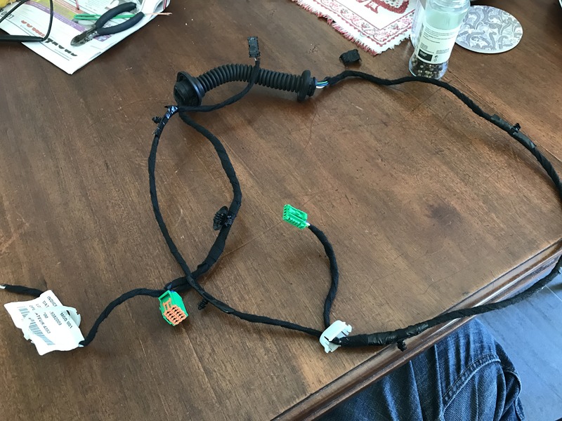

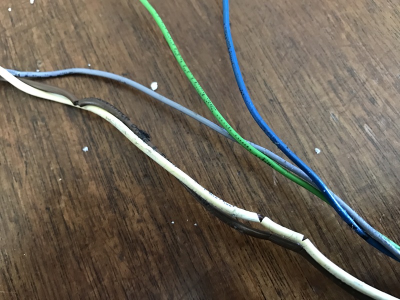

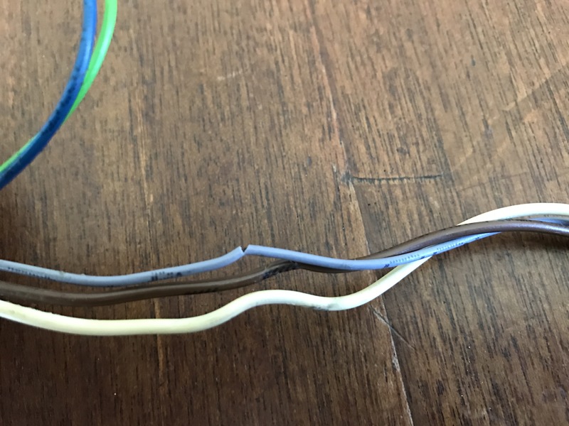

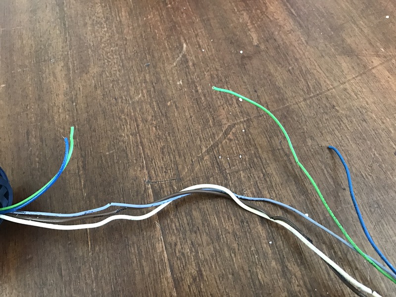

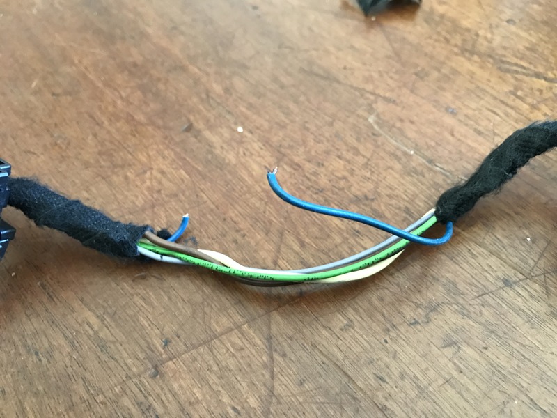

The day before we got married Cheryl said that the boot would no longer open on the 407. Today I got time to climb into the boot and wiggle the loom, nothing happened. I used a screwdriver and opened the latch then removed the loom from the car:
Upon stripping it down I found this:
I stripped back some of the insulation and found another broken wire:

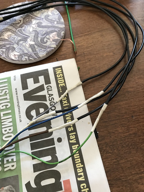

The rest of the cables were just as bad, they were in a pretty disappointing state for a 2010 car to be honest:
Anyway, I cut out the bad bits on all of the cables and replaced them with new pieces of cable, soldered them all up and heat shrinked the joints.
I refitted the wiring loom, tested the button and the solenoid fired perfectly so that's that one put to bed.

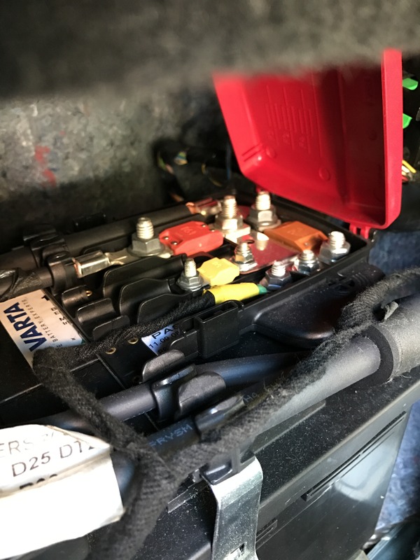

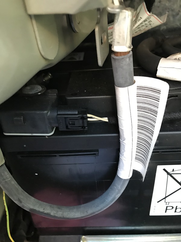

The battery on the 407 is like nothing I've seen in a car before too...
Batteries I know always had one connection to the positive and one connection to the negative. (Well, heavy connections anyway...)
This is the positive terminal on the 407:
The negative terminal has a little multiplug connected to it too!

Zelandeth
- Posts: 5328
- Joined: 16 Nov 2014, 23:36
- x 1607
Re: All Things V6 & a Turbo!
That is quite possibly the strangest battery connection I have ever seen...Well...on a standard automotive battery anyway!
Question does spring to mind as to whether there is maybe one connection there that actually goes onto the battery post and then that box (which appears to be a fuse box) is bolted onto that? I'd be really surprised if it was all part of the battery itself!

DHallworth
- Posts: 2437
- Joined: 20 Nov 2005, 17:05
- x 162
It's not part of the battery. The battery fitted is a Varta battery, that box has a Peugeot and Citroen logo on the red lid that I opened to take that picture. Not quite sure how you'd remove it though!

- Posts: 28764
- x 5679
Is that one of those smart-charging modules?

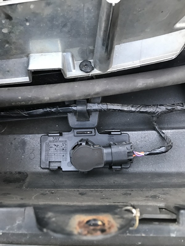

On a slightly happier note then the C5 tales of woe, I've been putting the 407 back together with it's new air con condenser fitted to it.
This car doesn't have the front parking sensors fitted to it so whilst the bumper is off I'm going to retrofit them.
I bought the 6 parking sensors and the wiring loom on eBay. The fixing brackets for the parking sensors are also missing from my bumper so I had to order these from Peugeot.
These are ridiculously expensive for what they are... The two fixings in the top picture that go on the side of the bumper are almost £40, the 4 in the bottom picture that go onto the back of the front facing sensors are almost £50!!
The brackets need to be glued to the front bumper:
Once the brackets have been glued you can then attach the parking sensor to the back of the bracket:
The markings for the front facing sensors are already on the bumper so they just need drilling out. They need to be 18.25mm holes in the front bumper so allow the sensor to fit properly. I'm going to drill these in the morning tomorrow before I stick the brackets to the bumper.
You can see the markings on the bumper for these. The side ones need to be drilled out and fitted using the two fixings in the first picture above.
