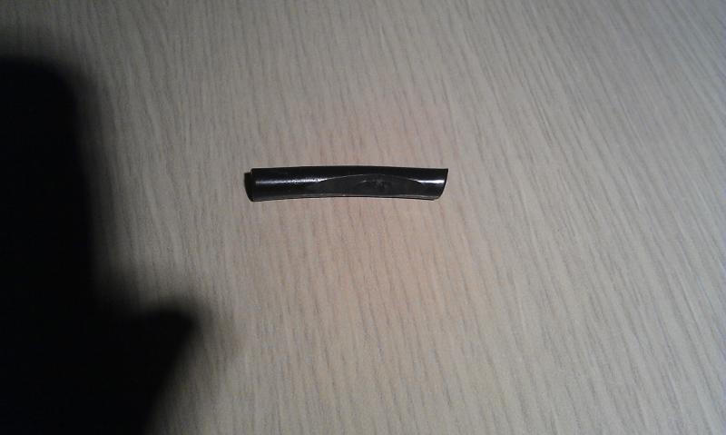

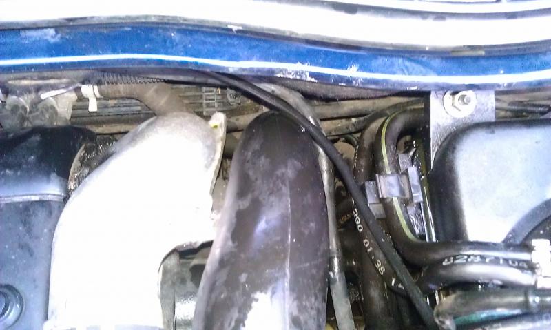

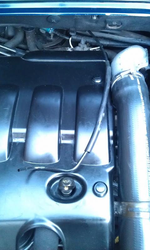

Today I spent some more time looking for the LHM leak on my HDi Xantia and I'm pleased to say it is now fixed. As is often the way it was not obvious where the leak was coming from, as LHM was everywhere. My Exclusive also has its undertray still, which probably hid the leak as it was not dripping on the garage floor until it got worse. I thought the Leak was from the anti sink valve area, so I took out the LHM tank and inspected that area. It wasn't from there, it was wet but it didn't seem to be the source of the problem. I checked all of the top hoses which seemed fine. After cleaning everything up as best I could and blowing the area clean with a compressor airline, I refitted the tank and had it back up on the ramps.
Again it was difficult to see the source and the leak was on the return side. It seemed to be dripping off the air pipework on the underside of the engine, which seemed odd. When I was looking last week, I had noticed a the LHM brake return plastic pipe was against the air ducting pipework. So I removed the pipe and it is the offending sources. It has worn through from touching on the plastic piping, leaving quite a hole.
The LHM return pipe seemed a little short to me, there is not much give in it and not enough to get it away from the intake pipework. So instead of replacing the pipe with a new one I cut out the small worn section, found some tubing which would be a very tight fit on the original pipe and made it slightly longer. To ensure better protection I have double skinned it with a bit of rubber tubing which fits over the extended pipe very well. Not that the pipes will come apart, its only a return and they are pretty well snug. With the extra length the LHM pipe is now not touching the plastic intake pipe.
So my HDi Xantia is now back on the road and as good as ever, what a simple fix
Here is the offending pipe, you can see it touching the larger air intake piping:
The worn section:
Here is my repair, it looks slack there but that rubber tube covers a slightly larger pipe which made the extension:
