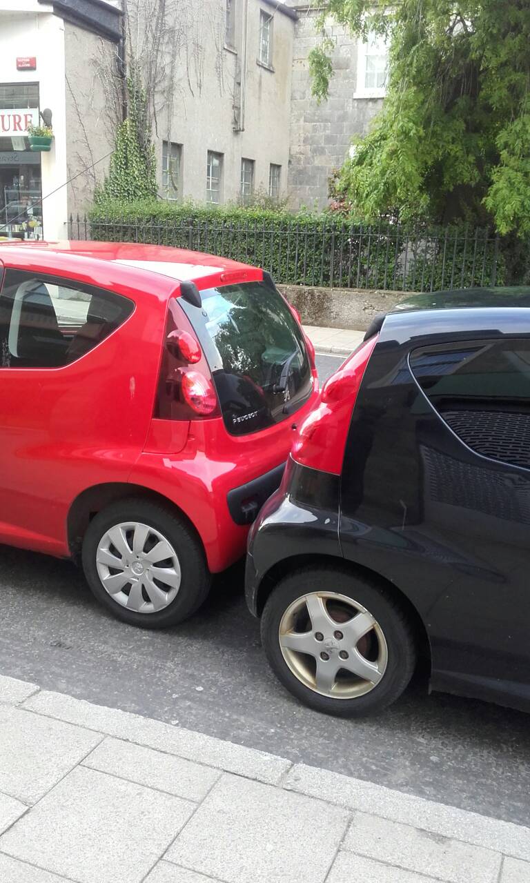

I'm just home after a bit of activa spirited driving. Took son in law into airport for a 5.30 am check-in. 42 miles gentle driving there. 56 miles of fun home. I must say the cornering of it is amazing! I had a good look of the tyres once parked. The pirellis on the front won't be on long.
Of course I hate pirellis anyway, so these wheels coming off and my 17" ones with uniroyal rainsports will be out on when I do the rear brakes. Nothing wrong with the tread of the pirellis but I don't like this cracking around the edge.
There's a pic of the activa and 107 getting reaquainted with other last week.
