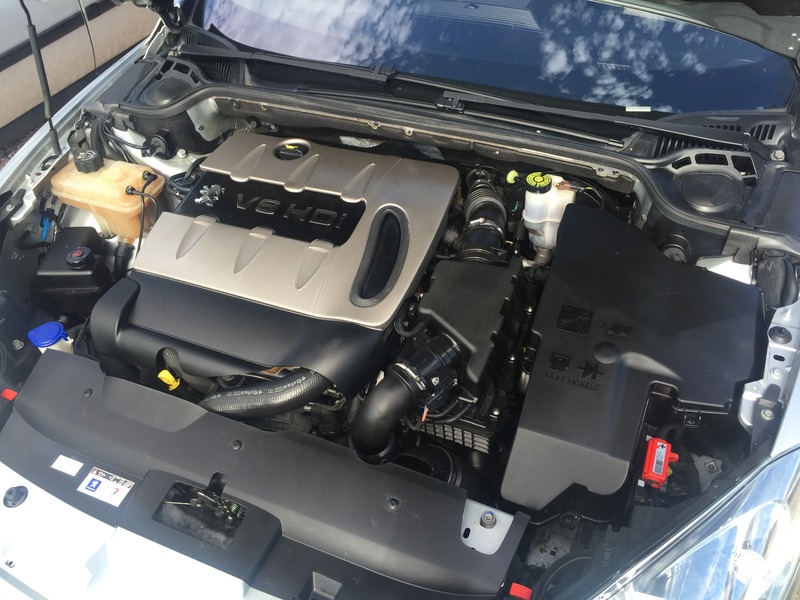

After driving the C5 a few times I decided that I really liked that 3.0 HDi engine, it's a lovely, smooth and economical unit and doesn't have the typically narrow power band that a lot of diesels have.

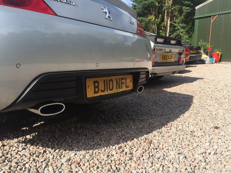

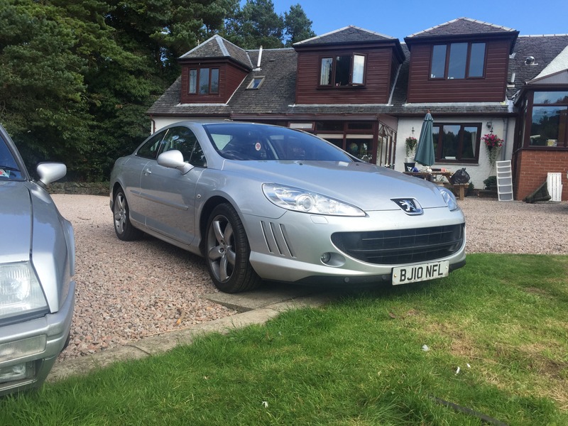

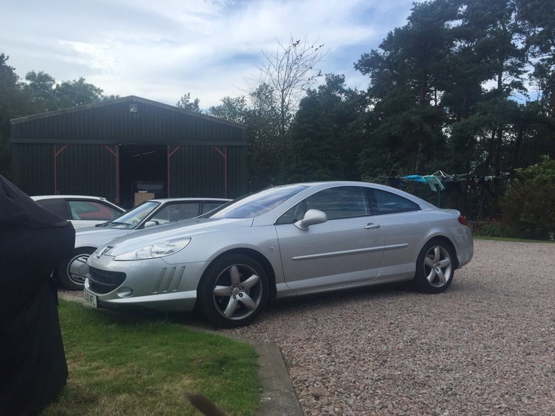

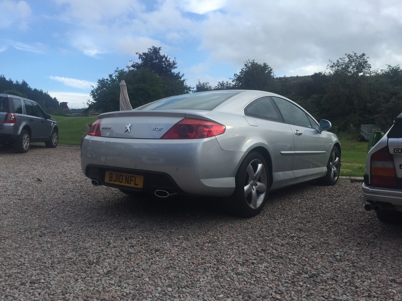

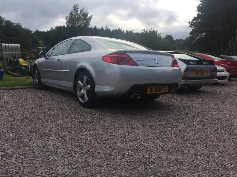

So... last week I ended up with another one! Only this time it's not in a Citroen!!
A plan was hatched as it was the North West Group's technical weekend at NFC Autocare in Thornton Cleveleys. I looked at getting the train to Sleaford to collect the car, however the price of the train was ridiculous. I spoke to Steve and a plan came together. I got the train to Preston on Friday night, then at 6am on Saturday morning Steve and I set off for Sleaford in his C6. We got to the garage at about 8:45 and the car was sitting at the front door ready for us.
We had a quick test drive, paid the man, and then Steve and I headed back to Thornton Cleveleys in convoy. Everything on the 407 is perfect apart from the air conditioning, it was totally dead. Leo attempted to recharge the air con and it appeared to be holding pressure, then we started the car, the compressor kicked in, and then high pressure gas started pouring out from the front of the car. It looked as if there was smoke coming from under the bonnet.
After the under panels were removed it became apparent that there was a hole in the condenser. I've since been in touch with the dealer I got it from and he's agreed to cover the cost of the condenser, the labour to fit it, and the cost of having the system recharged again.

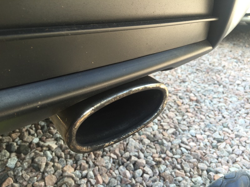

As stupid as it sounds, the only thing was annoying me when I collected the car was the exhaust. It was filthy and the muck was pretty stubborn! I spent 20 minutes giving it a polish and the results speak for themselves.
It makes a change for me to have a car that does sensible numbers to the gallon! Over the 400 miles between Sleaford and Glasgow it averaged 46mpg and only used 2/3 of a tank that cost £75 to fill with premium diesel
It feels a little slower then the C5 though as it's chipped and this one isn't
David.

Despite the 'wide-mouthed frog' look, it's a sleek motor!
Nice addition to your fleet!
- Posts: 55108
- x 8403
Re: All Things V6 & a Turbo!
I like the 407 Coupe a lot David
Side-on it looks like a shark!
Looks stunning in sliver...
Do enjoy!
Do enjoy!

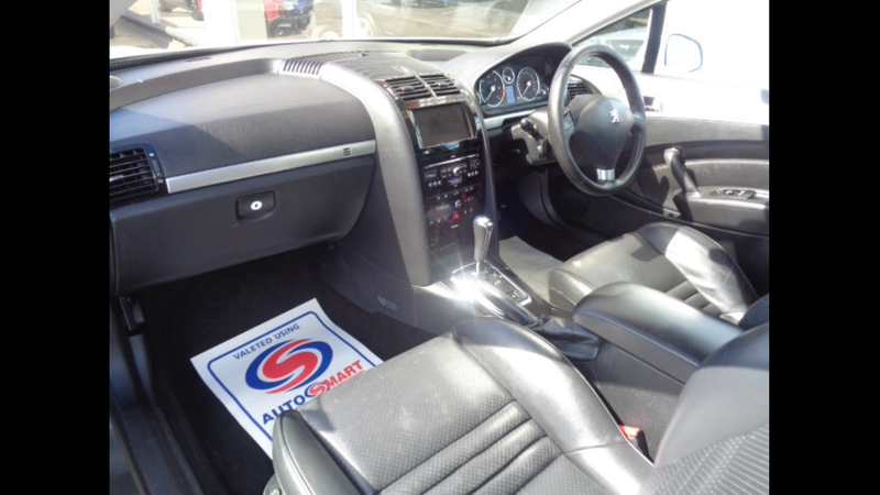

In true Citroen/Peugeot fashion, everything on this car was optional, the same way that it was when the C5 we've got was built.
The 407 has rear parking sensors, but not fronts, and it's got self levelling Xenon lights but not the directional Xenon lights. I had a look around it with Peugeot Planet last night and found out that these can be switched on.
Today, I managed to find a front splitter including parking sensors and the wiring loom on eBay from a car being broken, I also managed to get both front directional headlights too. Interestingly, because the V6 has the adaptive suspension, it's already got the steering angle sensor that the headlights follow and again because the suspension is adaptive and because the old headlamps were self levelling I don't need to retrofit the body height sensors either.
Seeing as the front bumper has to come off to install the air conditioning condenser I'll get these bits & pieces fitted at the same time. They're not essentials but they will make the car that little bit nicer. The adaptive lights are actually very good and once you've had them you do kind of miss them, and when sitting in the car the dashboard is a long way forward and you can't see a thing in front of the windscreen washer jets on the bonnet so it's very hard to judge when parking so the parking sensors will be very handy too.
Once all the parts are here and I've started fitting them I'll post up some more pictures
David.
