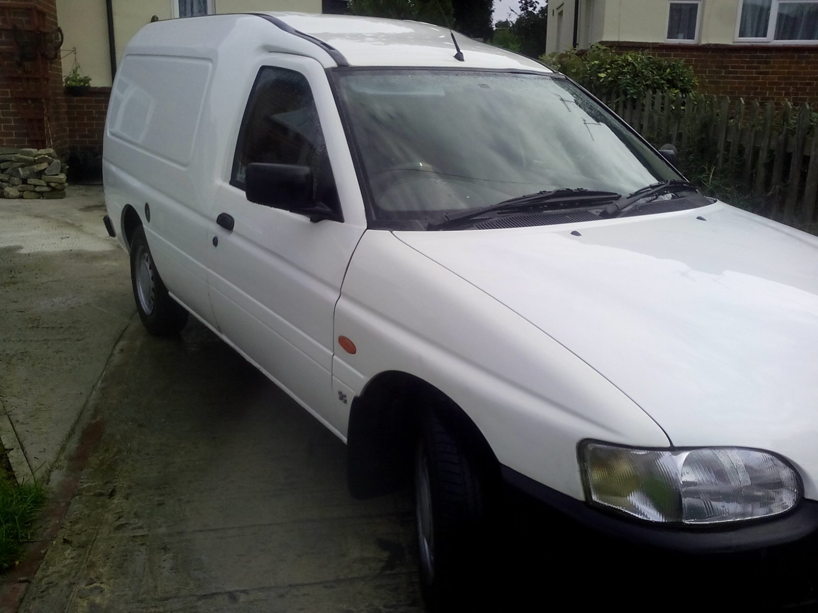

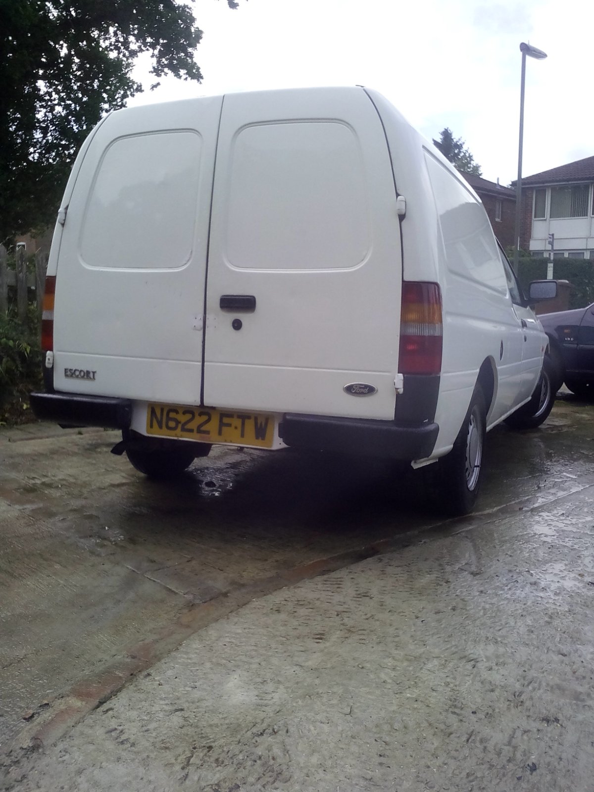

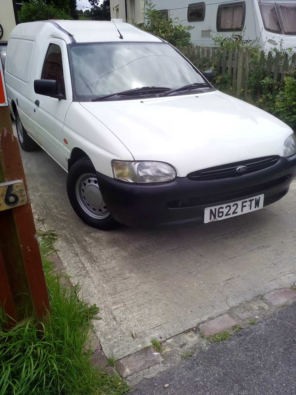

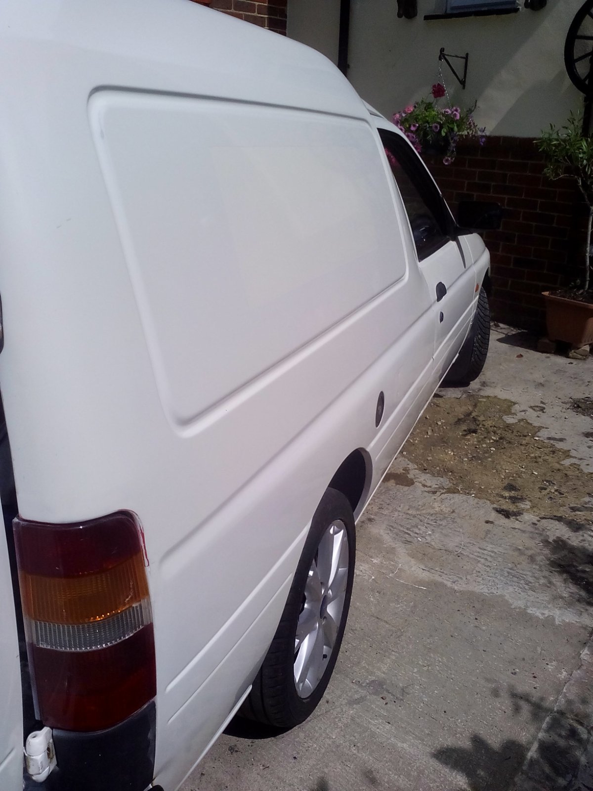

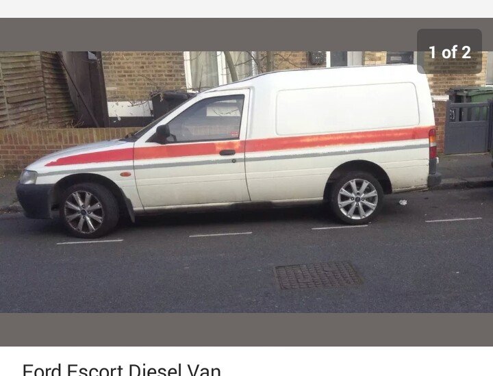

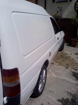

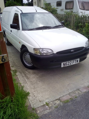

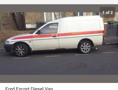

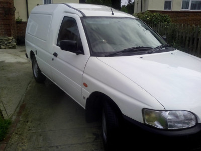

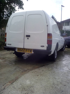

Smells alwful but it's good stuff,think it was made for boats hulls,ive seen land rover groups praising it to the roof tops, thats a couple of reasons I brought it , I was restoring an old escort van, the old stripe photo was the before how i drove it back from East London, work i did as follows,
Replaced clutch pedal and box, new hand brake cables, full service, new primer and fuel housing, it was drawing in air. Cambelt was done by previous owner, and a set of original wheels off Ebay for £50 , van cost 250, sold it for 1250. Clutch and box housing 25 , 20 for handbrake cables, service kit 28, this was 9 yr ago. I wet sanded the whole body, cut the paint, then polished the heck out of it and , I used it for several months , put it up for sale and it went withing a fornite. Yes I miss it , wished id of kept it but back then I was getting old cars 2 a month and flipping them .

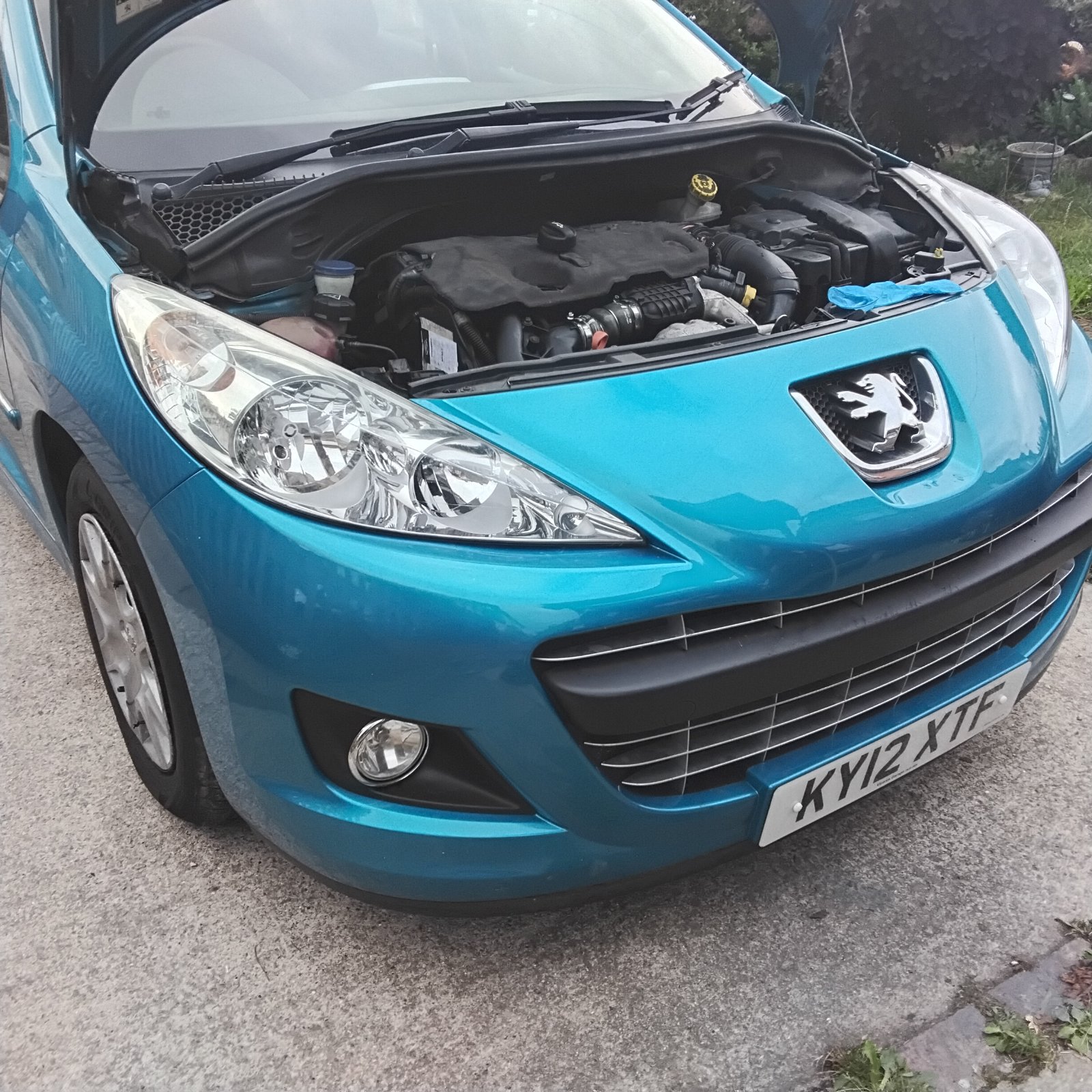

Back on track this was taken just afer I replaced its thermostat housing due to the thermostat being stuck open , pity it can't just be that you replace , but I guess it makes sense to do it by the whole unit .

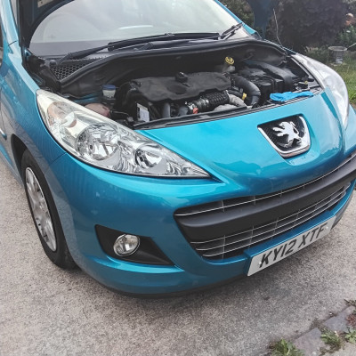

Nice shiny blue car ....tbh its pretty filthy due to the weather but this color makes it still look clean.
Hub nut size 36mm , just dropped that here so I know when its next needing removal.
