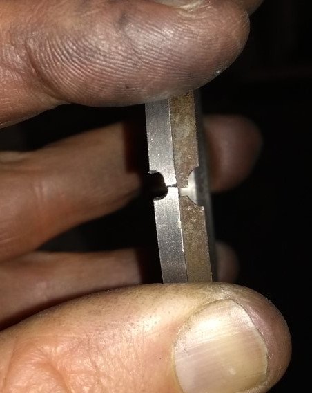

Splendid news, make sure you gap them without the piston in the cylinder before putting it back together. Use the piston to push them down the bore and gap them at the tightest point, using the piston makes sure they stay square. Good look.

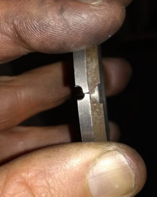

With the bike back with exhausts, working on re-assembly. Got the new rings, so have filed them back so they are a tight fit at the entry to the bore, which should minimise the gap further up the bore. You can see the difference in the length of the rings here....
After carefully blocking off the crankcase whilst I refitted the gudgeon pin clip, I then unscrewed the nut off the barrell stud and promptly dropped it down the crank case
so I had to take the side off to recover it. With the barrel back on, I've put something together wrong as it won't turn over now hmmmm resume that battle tomorrow!

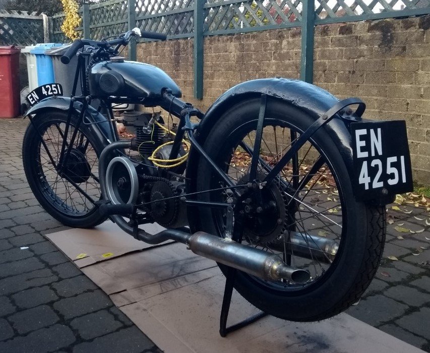

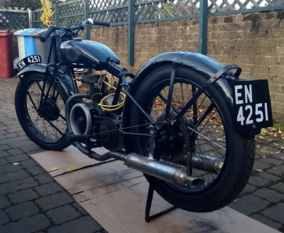

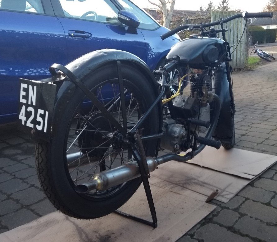

After a day spent on reassembly, it's more or less up together now. I've got to put another coat of paint on the tank, fit the chain, put the saddle on (ready, just need to put some additional washers on some of the cover bolts), once the tank is on I need to adjust the gear change.
It didn't really want to go back together - at least I was working in the garage with the heater on!! Just fitting the rear number plate took about an hour
Not helped by not feeling 100%, and everything I touched fell on the floor, and then disappeared under something!
The throttle is still no good, not sure what to do with that, I may need to go back to the original internal scroll, but I think it's well gummed up. The clutch cable needs making longer.
I've got the lights to put on as well, but I need to get the headlamp re-silvered, and then refurbish it all before putting it on.
I got a quote for chroming the pipes... a grand give or take
So big question, will it start? Will it heck.... no difference really, still no interest at all in running. Even after quite a few kicks, the plug was still dry, so I don't think it's getting any fuel sucked into the cylinder - it was certainly in the crankcase as it was running out the bottom. Still only showing 3 bar on the compression gauge, but it does come up much quicker than it did (2 kicks).

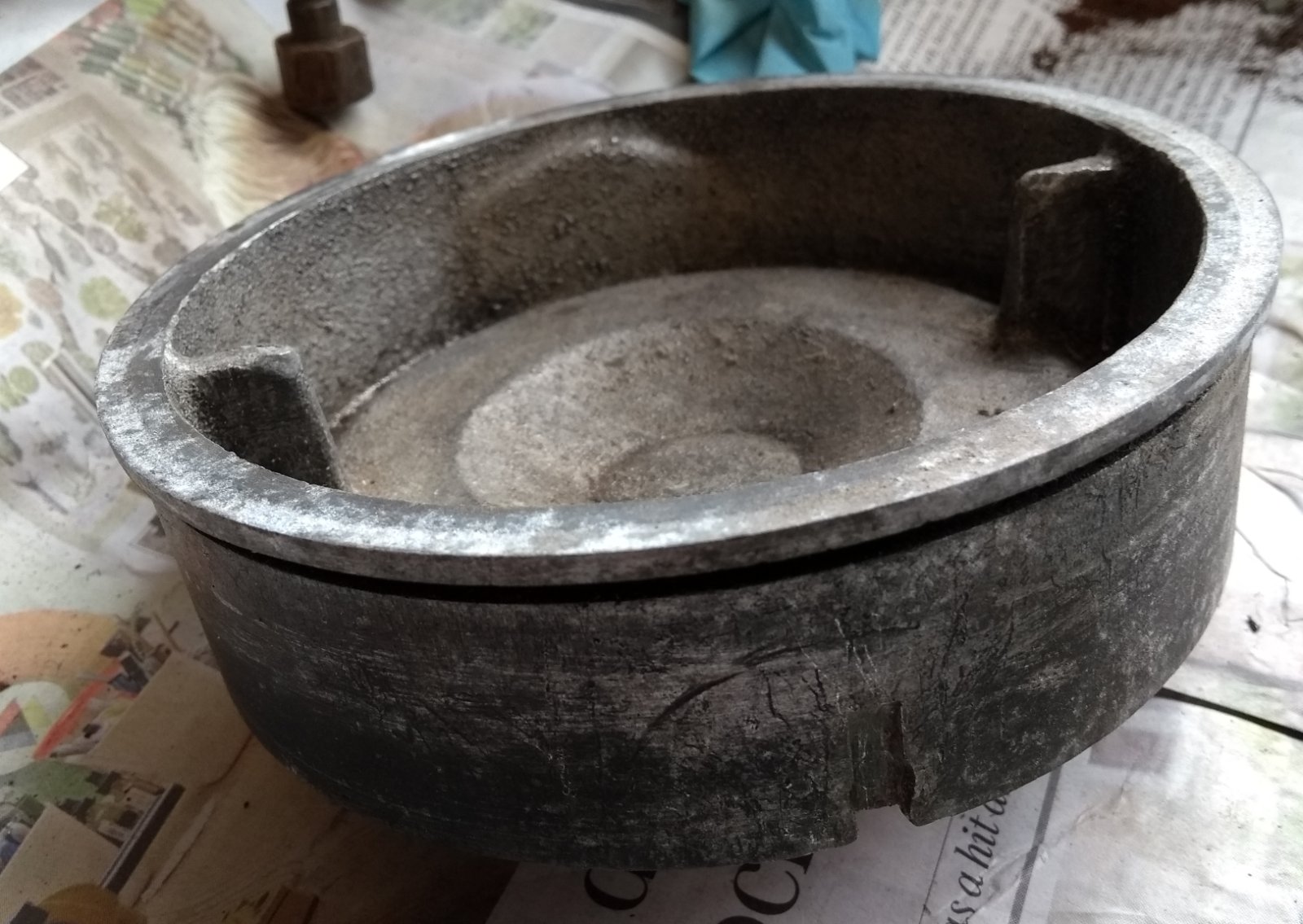

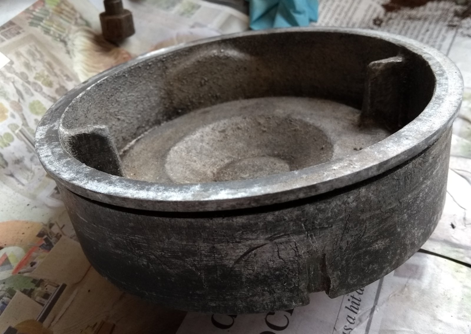

Hmm, what's that all about, surely that will just blow petrol mix out when it's running? Then I remembered there is this insert to go into the end of the crankcase to reduce the free volume
