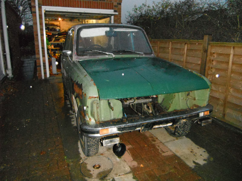

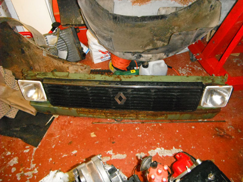

With the engine hopefully timed correctly now there was nothing more to do than get things buttoned up. The weather has been changeable today so I got on with what I could before work while I had the chance. I figured out how to dismantle the front end on my own without removing the bumper or having bits of the car cartwheel down the drive, which was something. The key thing was pulling the face off, which was already unbolted just snagging on things because the weight of the bonnet was holding it when I tried to remove it. Bonnet off and it was much easier to do, easier to store the two pieces separately too.

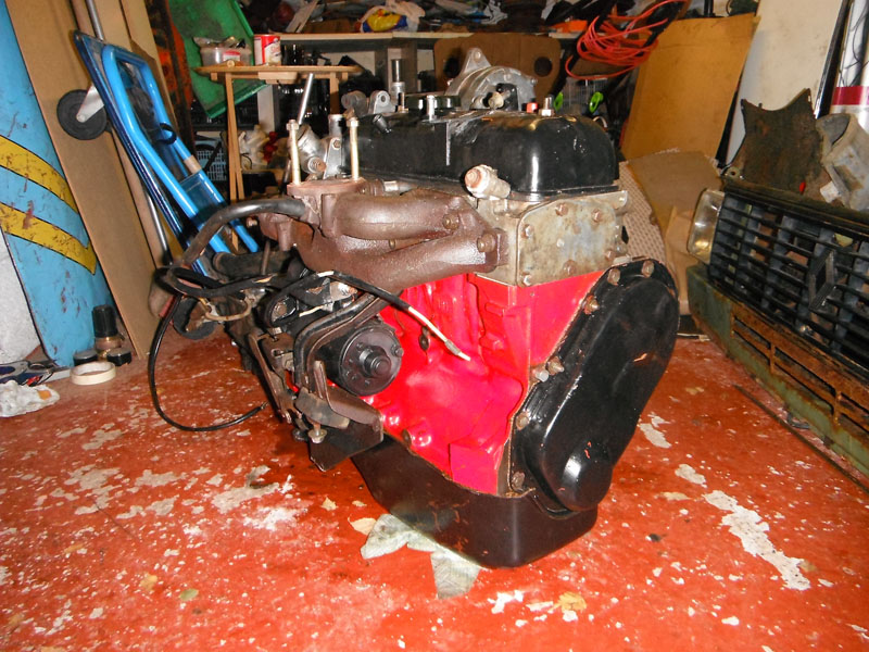

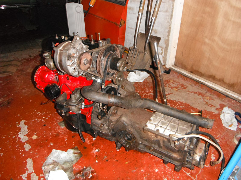

Then the fun task of putting the engine back together. First off I had to slacken the bolts on the sump (which was a chore) so that I could get the rubber seal on the timing chain cover to sit in properly. Bolt the cover up nice and tight and then retighten the sump (which was a chore again) and that was this end good to go.
Then I could do battle with the belts which is also a chore. For the cam pulley to water pump belt you need to undo the cam pulley to jiggle the belt on and then tighten it all up again. Having the tensioner now working did at least make putting tension on the belt easier. Alternator belt was much easier as that's just a case of undoing the bolt holding the alternator so you can lift it, put the belt on and then effectively let the weight of the alternator tension the belt before tightening the bolt up again. While I was working on this side I got jubilees on both of the fuel pump hoses and tightened up the jubilee for the radiator hose. All the other hoses are easy to get to with the engine in the car. I also put the spark plugs back in and put the rocker cover on properly.
With all that done, the only thing left to do before fitting the engine back in the car is to remove the steering rack. It was too dark to see what I was doing and throwing it down so I'll do that bit tomorrow which is at least straight forward. Plonked the bonnet on and called it a day.

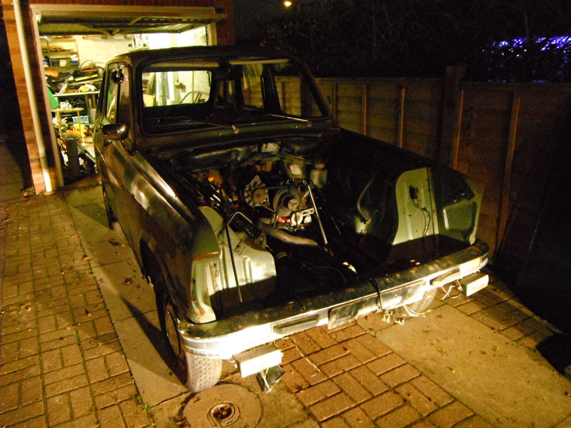

It gained that war wound gallantly transporting the Renault's engine and gearbox to the engine bay so it could be battled into position. A late start and short days meant I didn't get as far as some and had to press on after darkness had fallen. Mike helped fight the last few bolts and such into place and Nugget the Corsa illuminated the scene.
It is in. Finally. There's one stubborn balljoint nut that won't be sensible *spinspinspin* and tbh, it was getting difficult to see what I was doing. Engine mounts and gearbox mounts need tightening up and the various ancillaries plumbing in so a test run can be attempted. All of these are jobs for tomorrow if the weather continues to be agreeable.
It's got to get easier from here, right? It's just got to.
