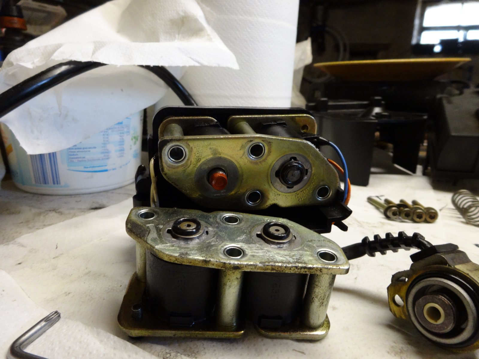

moizeau
- Posts: 1866
- Joined: 12 Jan 2015, 16:08
- x 423
Re: Lucas EPIC Injection Pump Overhaul Guide
Here's a pic I've just found on 'puter
Pete
wesacosa
- (Donor 2021)
- Posts: 101
- Joined: 04 May 2021, 17:34
- x 3
thanks, I think there are also some O rings on the other side too
moizeau
- Posts: 1866
- x 423
Yep, there are a few
Note the top one in the pic is the stop solenoid. It's a different design to the other 3
Pete
