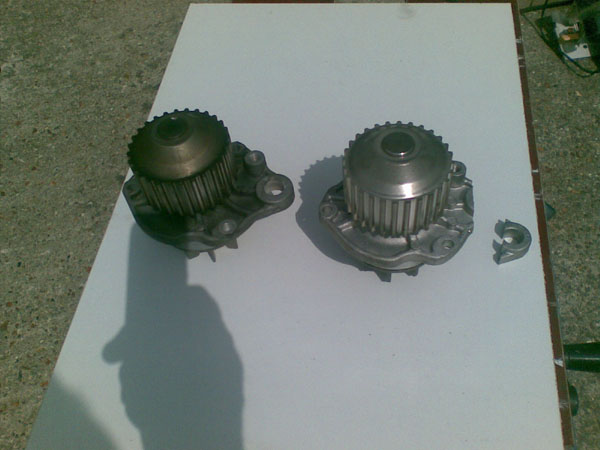

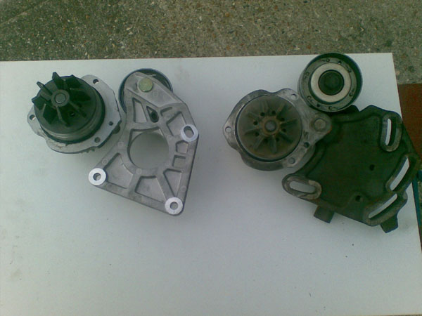

From when I did my belt (first time), having bought an old style pump and a new style tensioner
xantia_v6 wrote:Water Pump (old style) £47 :)
Belt, tensioner (new style) and 3 idlers £135 :D
The Aux belt is a common Volvo part, and was bought on-line for £9.
So other than having to adjust the pump with a hacksaw, it was a good deal.
old and new (adjusted) pumps and tensioners
detail of pump adjustment
