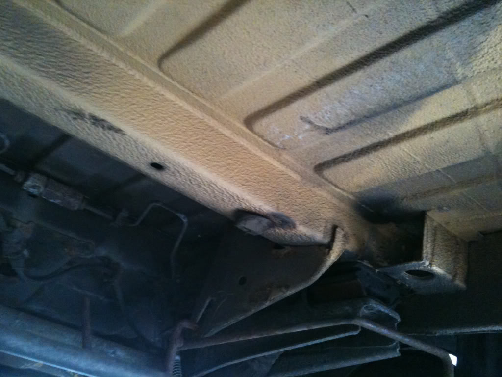

A shot of the rear silencer area , note the creamy/discoloured factory applied protection , this has been steamed and will be cleaned by hand at a later date and possibly painted green to match the car or some bilt hamber UC treatment applied , I'm not sure which at this stage yet .

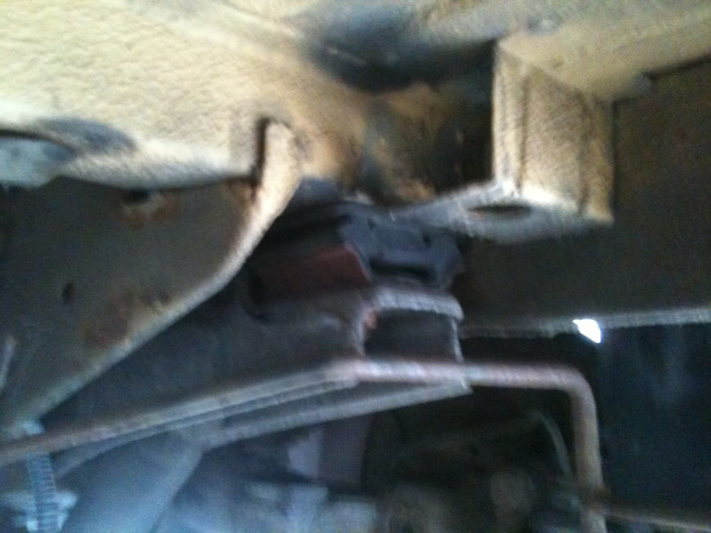

Here's the worst bit of rust on the rear box hanger , the old underseal will be stripped off and treated

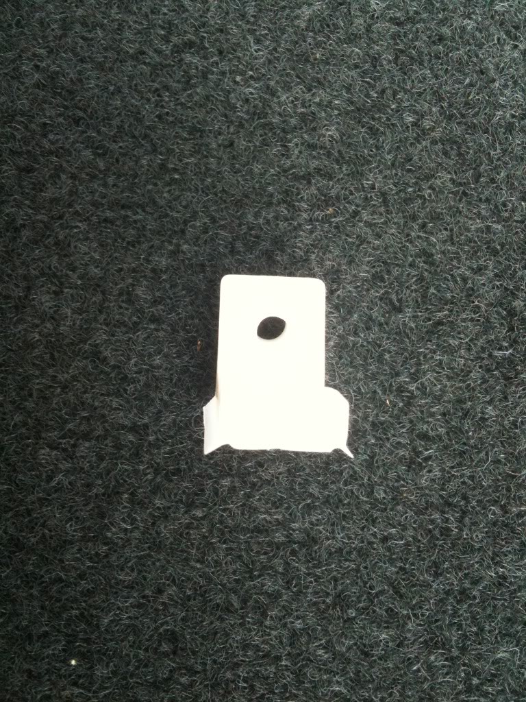

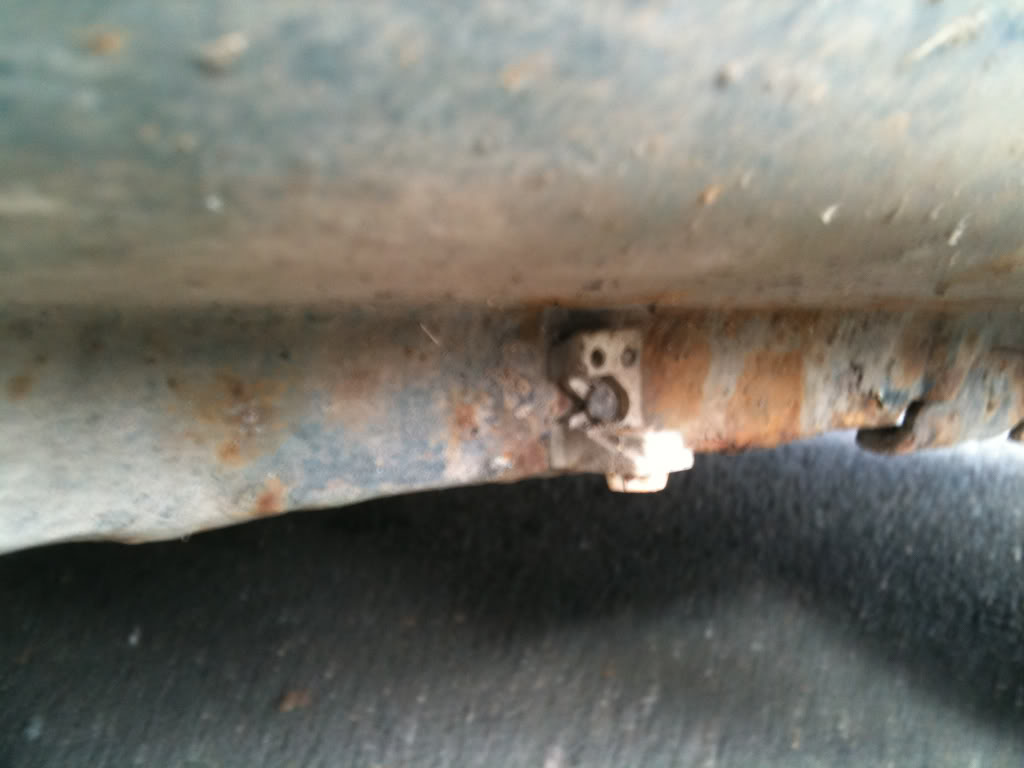

I'll let you know what I decide on Jim . Well Sunday and a little more spare time so what better than to repair the parcel shelf on the Zx as the fabric is peeling on the edges , so out with the spray glue and job done in no time , a quick clean up of any excess with some valet pro tar & glue remover and I'm very happy . I thought while I was out I would have a look at the sill trim clips I have just got , it turns out there are two types on the trim , the ones I have got which fasten onto the car with tiny screws and a second type which slide into a channel and then pop into holes on the sill of the car .Here's the lower ones
These will need the screws drilling out as you can imagine they are past there best , I shall replace them with some stainless ones .
And here's the clip which I now require ( possible 20 ) another trip to the dealer to see if these are still available .
I've got a sneaky feeling these are no longer available but fingers crossed .

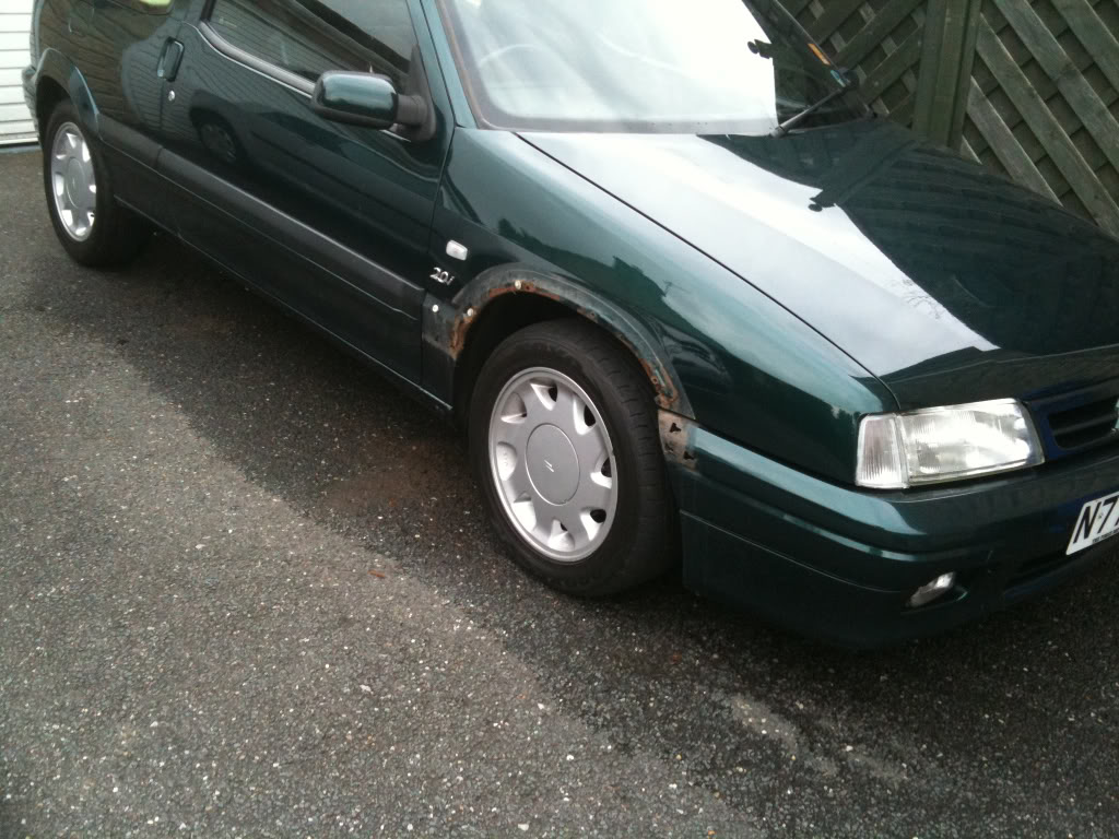

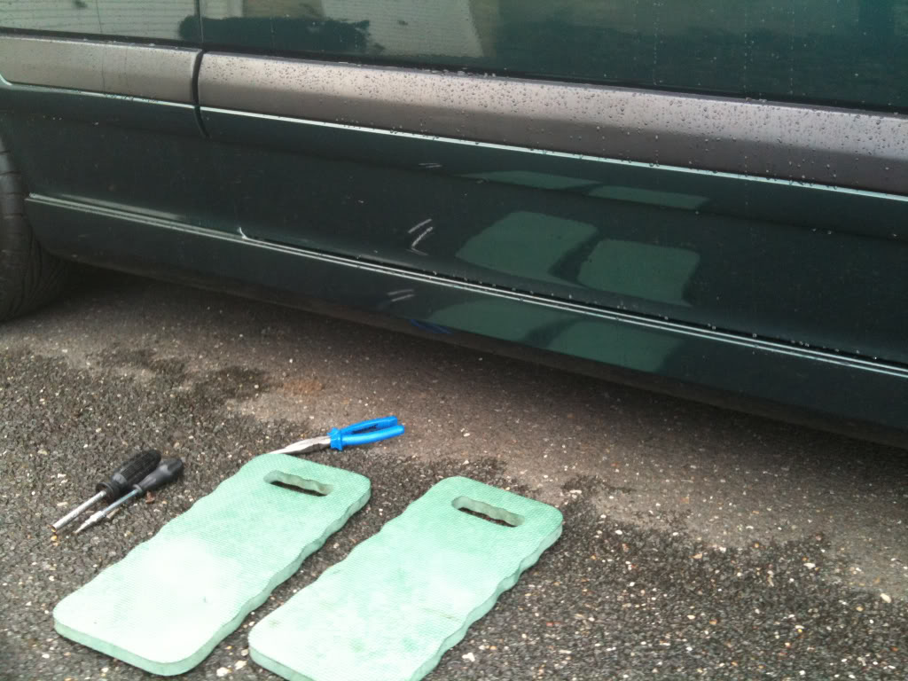

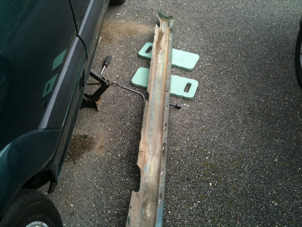

Well after a slight delay I started on removing some parts of the Zx's bodykit today , first job was to jack the car up to gain access to remove the torx screws holding the sill trims on to allow me better access to the jacking points.
Here's the sill trim before removal .
And here's one after removal .

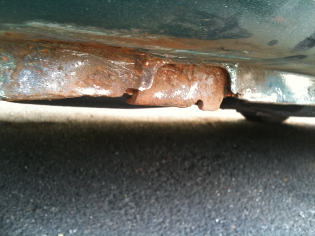

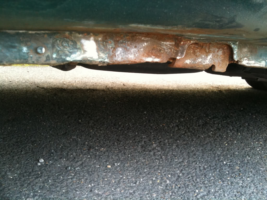

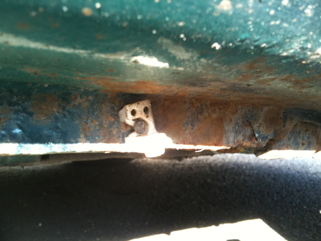

And here's what was hiding underneath , this is the o/s/r jacking point . It's mainly just surface rust but I wanted to get it sorted before it goes too far .
Here's the o/s/f area .

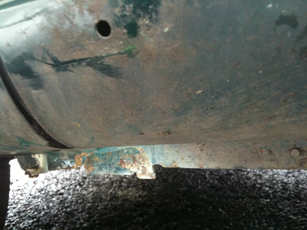

Here's both the nearside jacking points which are surprisingly better than the offside

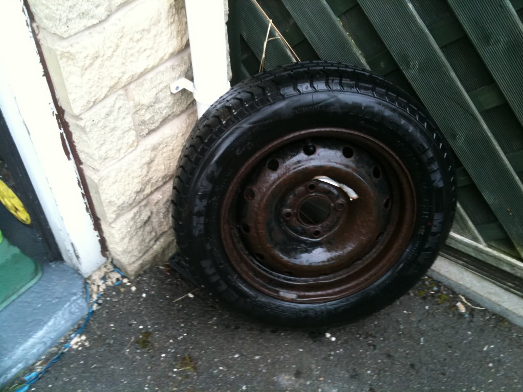

Here's the area above the spare wheel carrier which is in superb condition , it will get a good wash with some bilt hamber surfex Hd , the spare wheel carrier will be removed and shotblasted and then resprayed black .
And a very grubby looking spare wheel , I don't think this has ever been of the car in 17 years by the looks of it . This will be shotblasted and repainted black .
After a quick clean with some bilberry wheel cleaner .

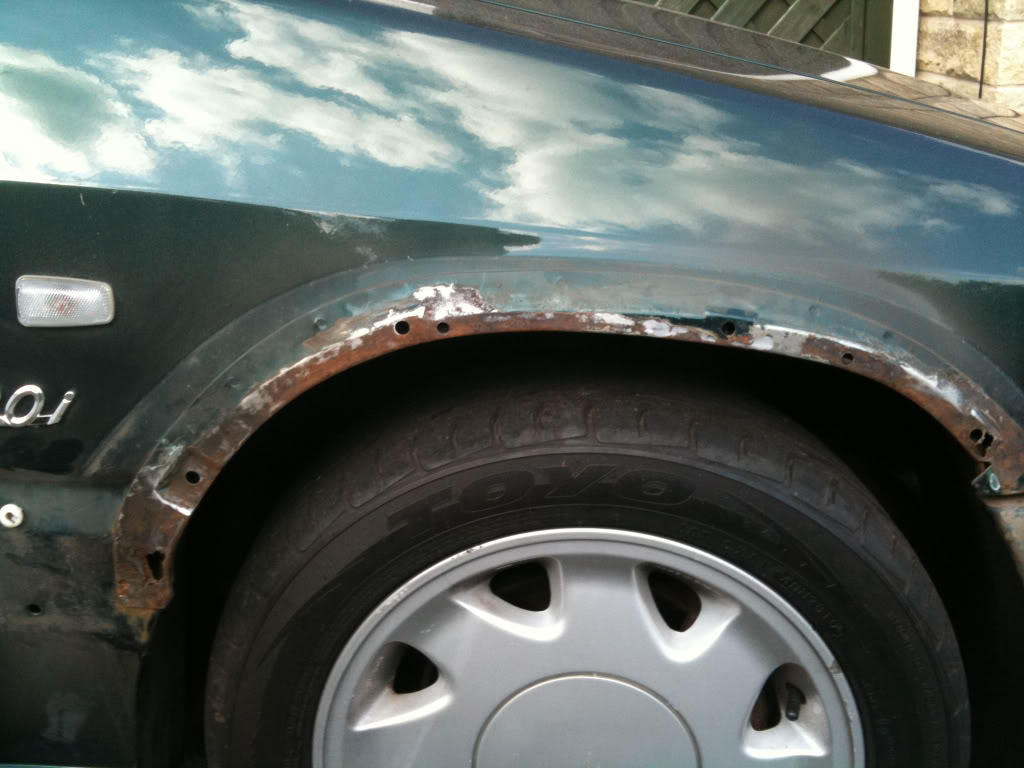

Now the the front arch before removal , nice and shiny

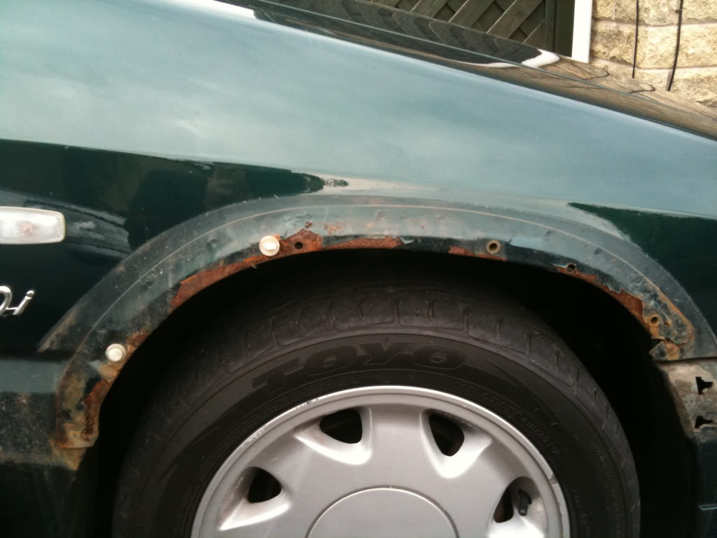

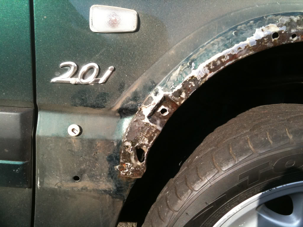

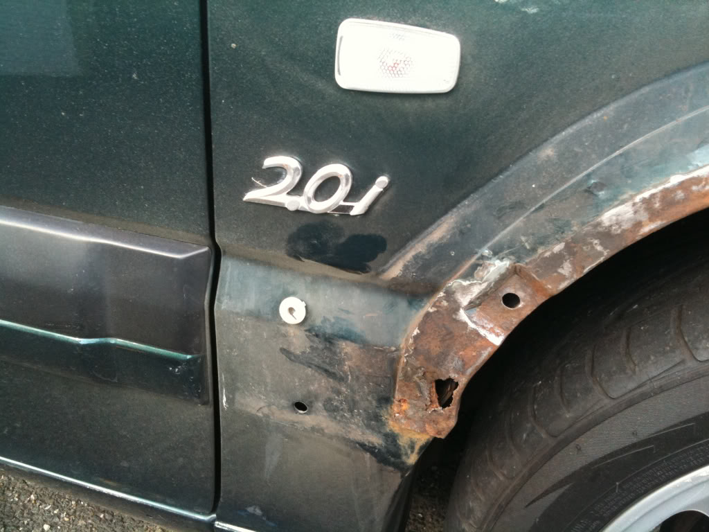

And now after removing it to gain access to be able to treat the affected area . I wasn't expecting it to be this bad but the rust is mainly in the second skin on the arch lip .
Here's the worst area of the arch , there is a small seam which water has got into , this will be treated with some bilt hamber deox gel at the weekend .

The sills are in fantastic condition for the age , it's just surface rust around the jacking points which require minor attention , I will also be spraying cavity wax into the sills through the skirt trim locating holes .
Mark

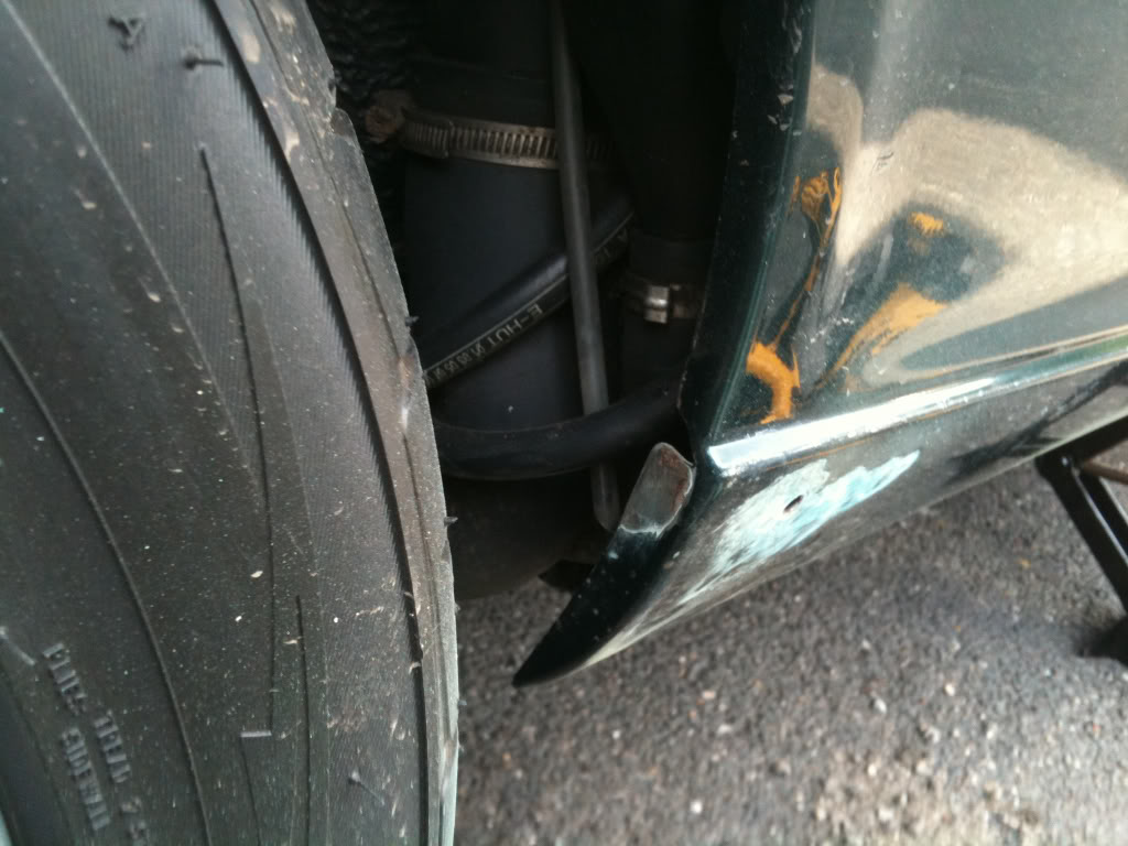

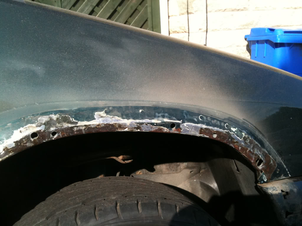

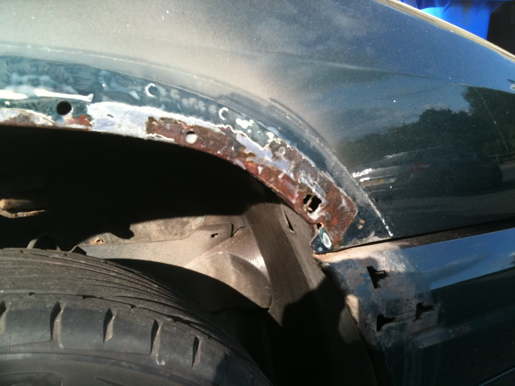

I managed to get an hour or so this afternoon to crack on with the rust issues , here's the front arch area which is the worst area as the second skin on the 16v specific wing was harbouring some rust .
A couple of small holes after tidying up with the flap disc
And now with a coat of deox gel

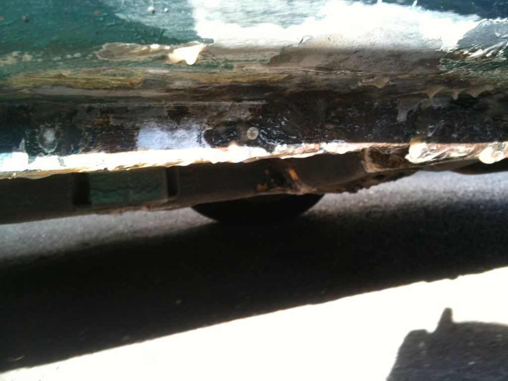

Onto the sills now
Cleaned up with the drill & flap disc
Front jacking point above ^^^
Rear jacking point cleaned up
A small section on the rear lower arch area sanded
And finally a small area which required a little tickle with the flap wheel
