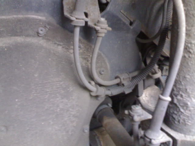

had to take the passenger front arch liner off and found more rust
and a split cruise control hose, and a cable with a section missing
Think that might be why the ABS is out of order!
Might be back to the trusty xantia quicker than i thought...

Hi dave
The wire is for the brake pad wear sensor but trace it to be sure, not essential in fact i took mine off.
The bumper mounts always go on all but the best kept cars, welding here doesnt have to be neat but its not the end of the world at all, try rubbing it down first and getting some hammerite and waxol on there if its still sound but the bumper wont drop off if these side mounts are a tad rusty.
Leave the Xantia where it is
D
D

Dave
Looking at the wires for the abs it doesnt seem familia to me so i dont think your abs is either of the two Bendix systems, looks like it could be teves.........bloody unreliable teves eh Xmexc
(he will message back and tell me its Bendix now you watch
Anyway there is plenty of stuff on the other forum for abs fault finding, start with testing the resistance of each sensor they are mostly the cause of abs failure, that and corroded plugs/internaly broken wires.
D
