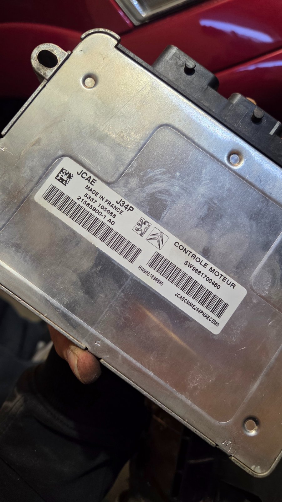

Yeah, car was bought from auction in running condition, no issues. 90k km's on clock, 1 owner, immaculate condition and it really is. I've attached a picture of the ecu for reference.
Update:
I have completed the aforementioned bosch specific "calibration" values EEPROM programming sequence. The ECU infact does the calibration run by driving the throttle valve to its endpoints with that procedure. The car has now worked fine for 2 days, no problems. However when the serv light was on and radio screens says "Engine Manangment Failure" the OBD comms port reader cant find any fault codes. The car just wont respond to the thorttle pedal command and it is running poorly. The Throttle valve does not recieve power at this time when the fault is active.

Moyhentaja wrote: 01 May 2026, 08:42 The car has now worked fine for 2 days, no problems.
Lets keep our fingers crossed.
Moyhentaja wrote: 01 May 2026, 08:42 However when the serv light was on and radio screens says "Engine Manangment Failure" the OBD comms port reader cant find any fault codes. The car just wont respond to the thorttle pedal command and it is running poorly. The Throttle valve does not recieve power at this time when the fault is active.
So the P0122 & P2122 codes disappeared? That's disconcerting. There are a thousand things that can cause the engine to go into "limp mode". I would assume the P0122 & P2122 codes are still there but the reader is not getting data, for one reason or another. I would hope it's not a new fault.
IIRC if there any problems with the engine controls after a drive cycle has started, the engine goes into limp mode, but the vehicle still moves. However, if a failure is detected at startup, the engine will not respond to the accelerator.

The problem was faulty spark plugs, that misfire info would be nice to read from obd. Even the "expert" mechanics at local citoren dealer couldn't find the problem. This was something..
