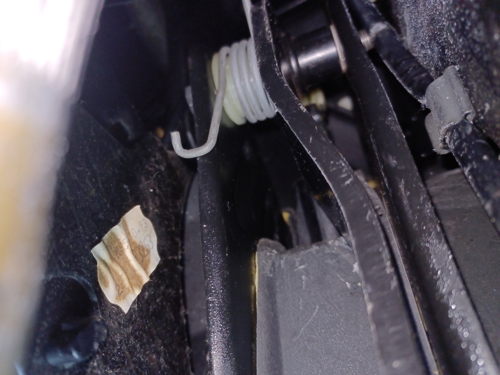

OK, seems I am getting there.....I can work out where the spring sits on the peddle and that the inside arm goes on the lower part of the peddle "leg", but where does the other "tail" of the spring go/engage ??

Above image, spring on the wrong side...bugger, all OUT again.

Ah, bugger... At least it's just unbolt and remove, no need to disconnect the cable! In my linked thread I did mention the spring was the hard bit; no recollection of how / where it fits now though!

Taken out and re-positioned now...
BUT
The bit that is confusing me is : The spring is there to depress the peddle not keep it raised ....is this correct ?
(hence why when the clip/plastic cable housing breaks the peddle goes to the floor as the cable (no clutch pressure) is not not pushing back on it ??)
Update:
On cable clutches the return spring holds the peddle to the floor and is fitted to the RIGHT side of the peddle (looking at it).
There is a little cut-out on the bulkhead bracket (oblong/right side, just below the hole for the cross bolt ) to accept that side of the spring. It can be pushed up into position with a screw driver blade, after that, attach to the peddle arm.
BUT
Update:

Superb work! Yes, the little pedal spring goes in what seems an illogical manner. It's function being to keep a little tension in the cable to stop it rattling!
Sorry I initially gave you duff advice on that - I was half-way to hospital with Steph at the time and my thoughts were off the cuff and thinking logically. Should have known better - it's French after all...
