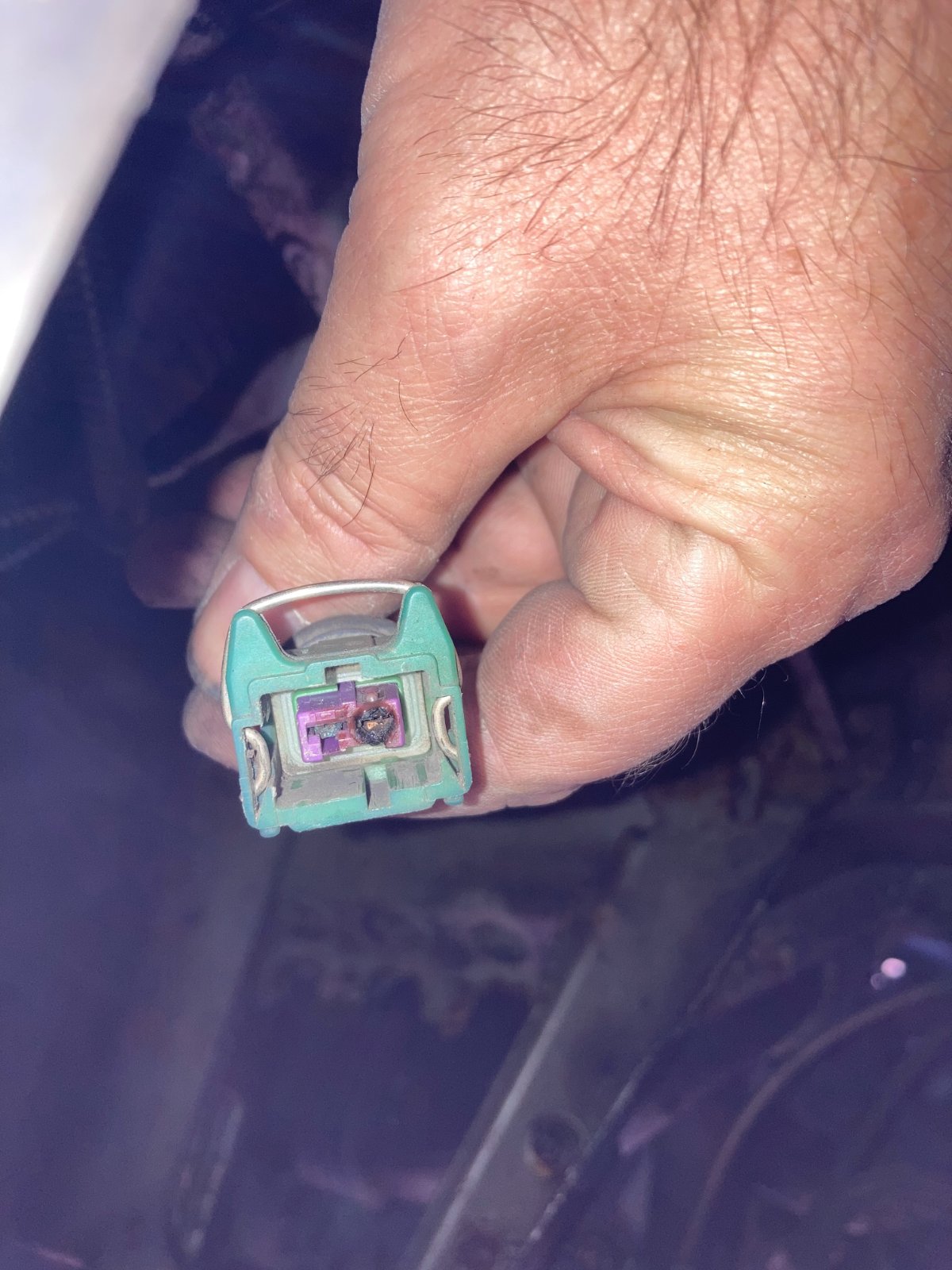

GUYS! It looks like we have finally solved it!
I took it to a peugeot specialist garage. They went for a test drive and after 50km the car shut down, but after being towed back it came back to life.
They started to check ALL THE WIRINGS and connectors in the car, measured all the sensors, and they found out that the connector of the fuel rail pressure WAS MELTED! Not the whole part, but ONLY ONE SIDE OF THE CONNECTOR, CLOSER TO THE SENSOR ITSELF. IT WAS MELTED! (it was probably when the EGR blowed out and the exhaust gas melted the connector..
They replaced the whole connector, including housing, wiring, and EVEN THE PINS(!). After that, they went for a test drive and got shut down again, but shortly after it came back to life. They drove for an other 180km (112 miles) without issue. They insisted to give the car back. I asked them, what live data did you get, when the car got shut down.
They said: "The measured fuel pressure was 0 bar, but after a few minutes it was measured properly!"
I asked them.. Dont you think you should replace the rail sensor? They told me, that they checked the sensor and it showed up okay and working... I said... Nah! Please change the sensor to a new one!
AND GUESS WHAT! IT WORKS!
It was the blinking sensor that started to die since 2024 may + probably the blown out EGR valve melted its connector in 2025 january. The sensor measured crazy amounts of pressure, as you could see above, YET the car only stopped when it was too low fuel pressure. The car NEVER SENT CODES about the fuel pressure being too high, and also the rail sensor - WHEN IT WAS TESTED SEPARATELY - WORKED 100% FINE, and NEVER SHOWED UP AS A FAULTY! ONLY FAULT WE GOT IS the TOO LOW FUEL PRESSURE + when the car stalled the measured pressure became 0 bar!
Since we replaced this sensor it works!
