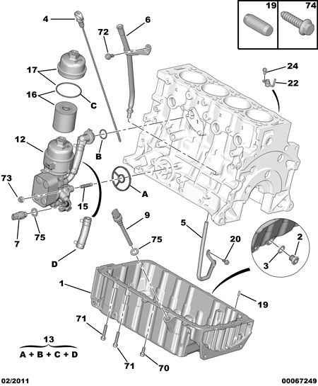

To explain the confusion a little: PSA don't list the oil cooler as a separate part, they sell the whole assembly of the filter base with the cooler attached.
- Posts: 21250
- x 8132
Re: Oil in Coolant?
Aah!! thanks for that Mike, it explains my inability to find it!!

It is a radiator for a gasoline THP engine. It does not fit the 2.0 Hdi.Gibbo2286 wrote: 13 Dec 2025, 11:02 New and used on ebay
https://www.ebay.co.uk/itm/397259072031 ... 7fdaedb114
The corresponding is Nr. 1103T3.

As the engine oil does not appear to be contaminated you may well be ok. I'd advise a full drain, flush and refill of the cooling system once you have fitted the new part and hopefully it will be OK
