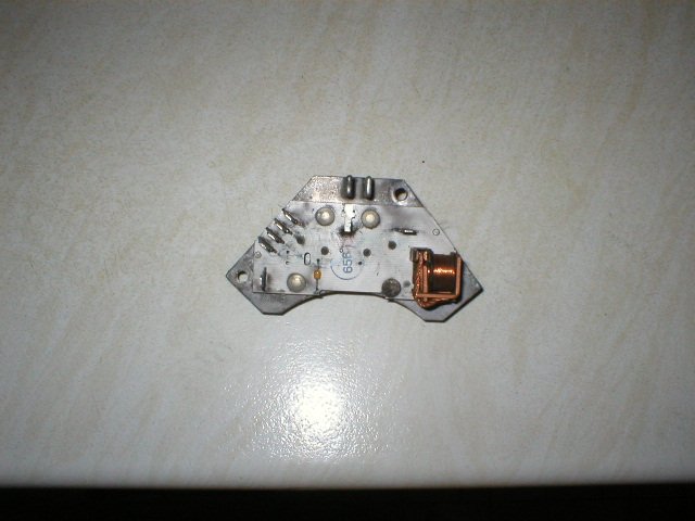

I've had a chance to look a bit into this today Peter. This appears to be the connection to the thermistor on the regulator heatsink.
I can understand if it's open-circuit the blower won't run. Putting 12v on it as a test will give a (sort-of) substitute signal to the aircon ECU.
The thermistor is there to maintain a constant blower speed against changes of heatsink temperature. I'd not recommend using the test method of substituting it with a substitute 12v feed as this may cause a thermal runaway in the regulator transistors if the heatsink becomes too hot. The thermistor guards against this eventuality.
It worth checking the thermistor spring contact. Refer to the picture below. The thermistor is a small carbon-like disc that sits on the heatsink under the circuit board. You can see the spring contact. Check the spring contact is making a firm connection to the top of the thermistor and also check with an ohmmeter between its connector pin and heatsink to measure its resistance. I'd expect t to be between 500 ohms and a couple of K ohms.
We'll get there

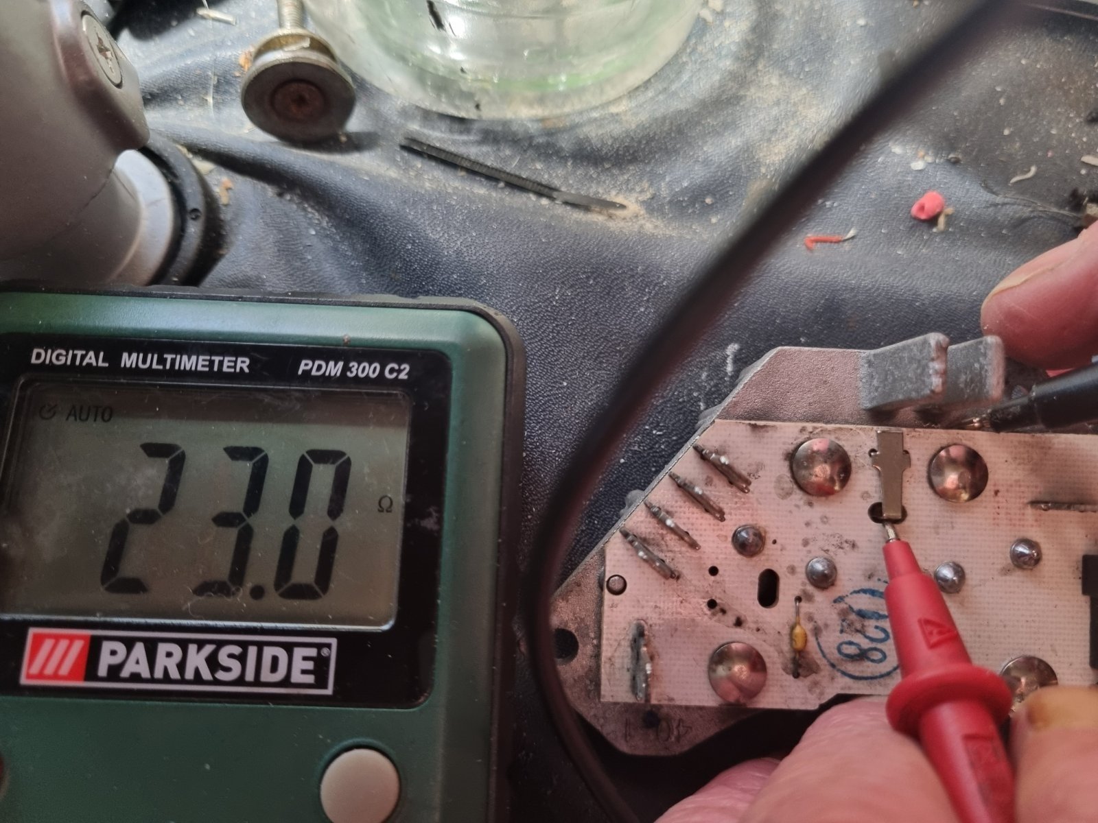

Re: More Heater blower problems
Hello again Jim,
Got the multimeter on it,
that was about the average steady figure,if i slid the probe around it occasionally went higher but would settle back to about that figure.
Reason: Image rotation corrected

That looks OK Peter, I can't confirm it's 100% correct as I have no modules here to compare...
Does it change with temperature?
Hmmm... The plot thickens...

Just warmed it up, resistance gets higher by 2 to 3 ohms

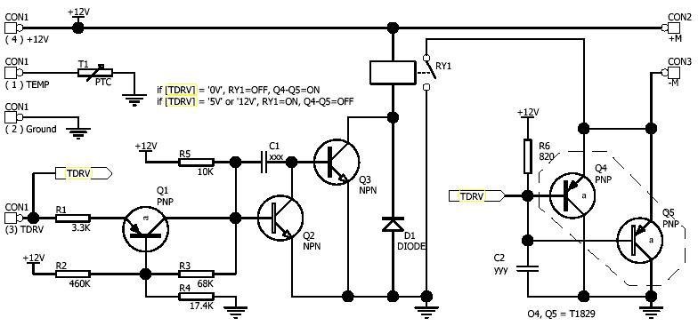

The separate black wire is a negative sense wire back to the ECU. It, along with the thermistor, is part of the speed regulation loop. The sense wire is there to compensate for small voltage drops along the main current carrying wires to the blower that would might cause speed variations.

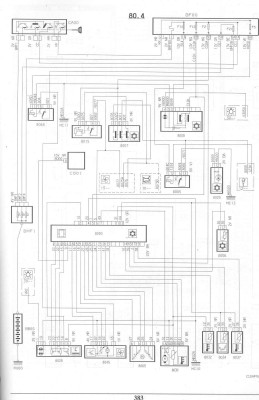

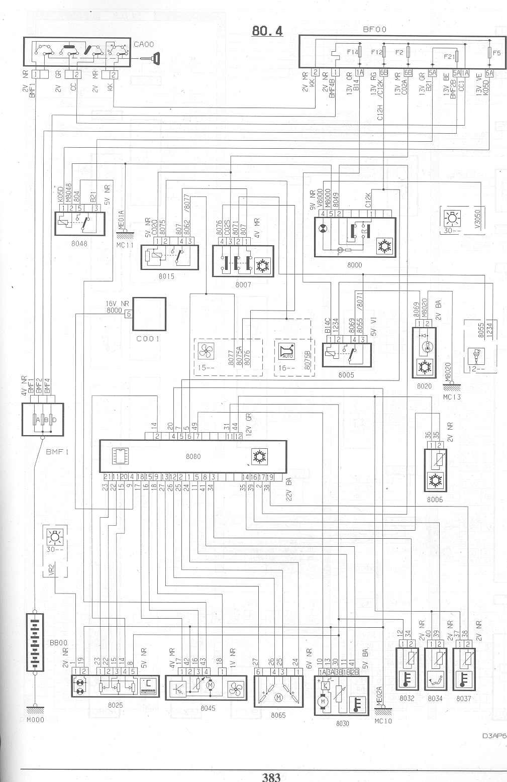

In case you've not see them, I attach circuits of both the blower regulator and the overall aircon wiring diagram.
