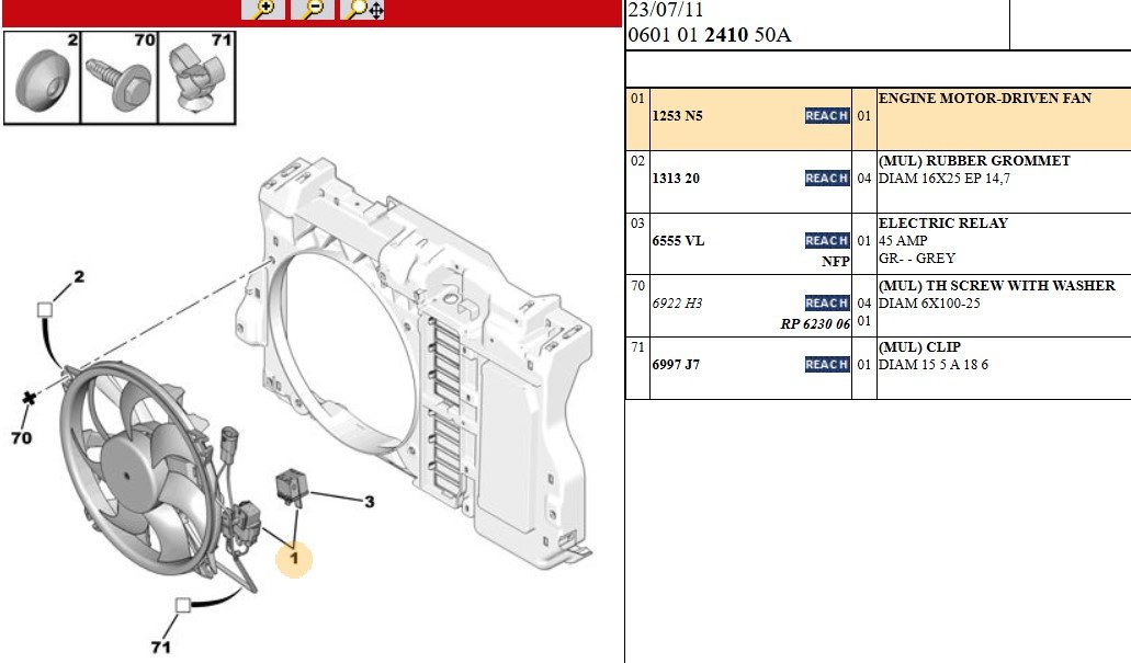

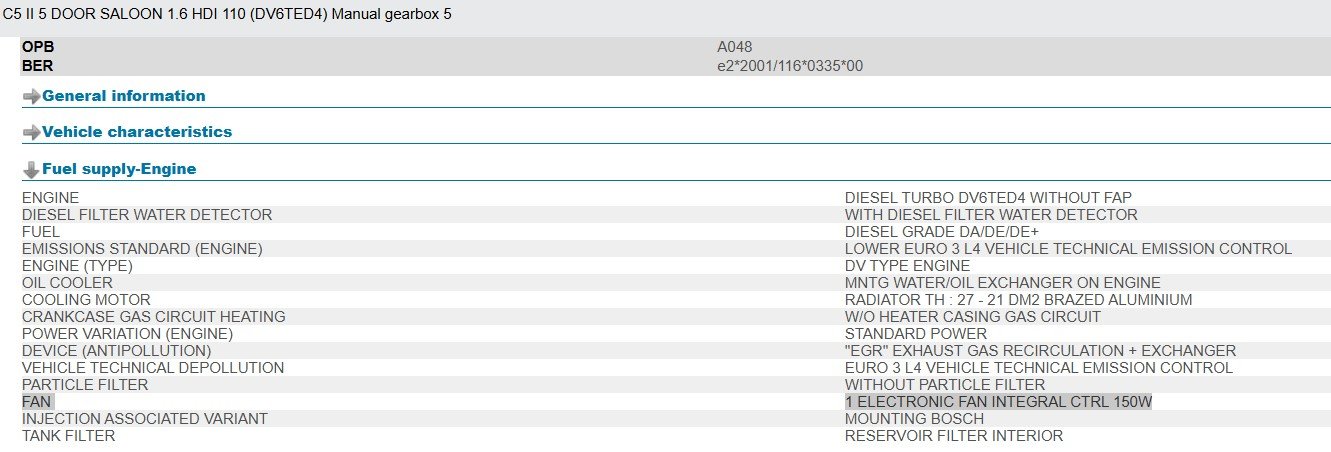

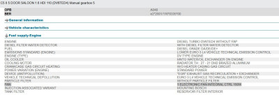

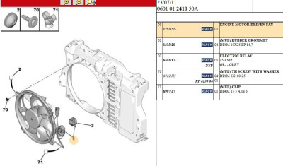

Showing as having single fan with integral control
Parts diagram not showing any resistors.
Will try digging out a wiring diagram.

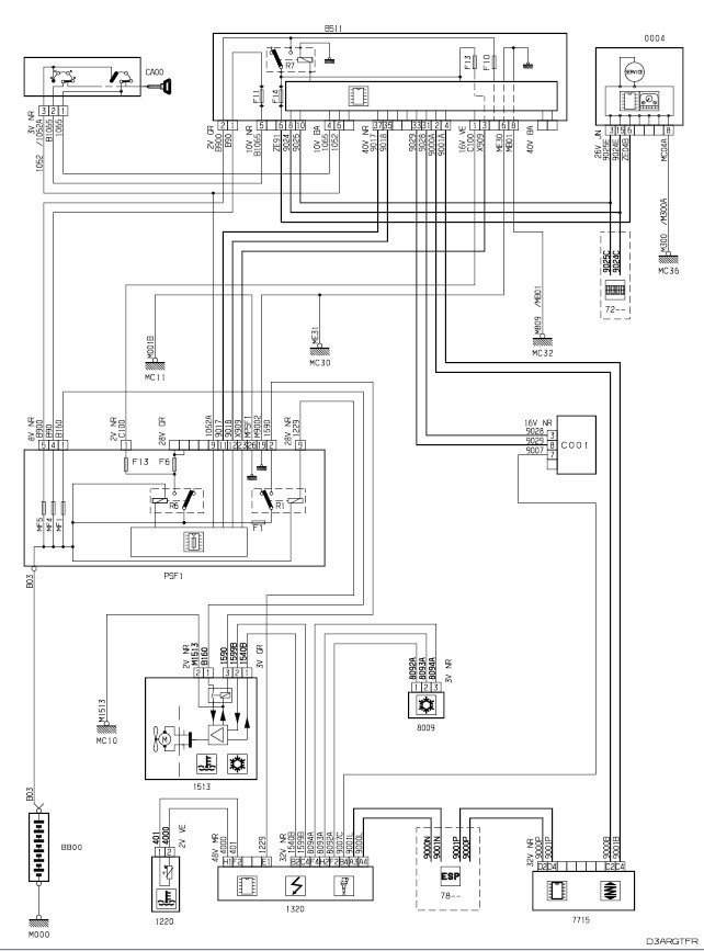

Wiring diagram for system, you can see the speed control is built into the fan assembly

wheeler wrote: 17 Sep 2025, 14:55 Wiring diagram for system, you can see the speed control is built into the fan assembly
This means that there is no fan resistor in this system.
wheeler
Posts: 7931
Joined: 21 Sep 2002, 19:07
x 1055
Re: 2007 C5 MK2 P0483 FAULT
Unread post by wheeler »
Correct, the fan motor & speed controller are the same unit (component 1513)
