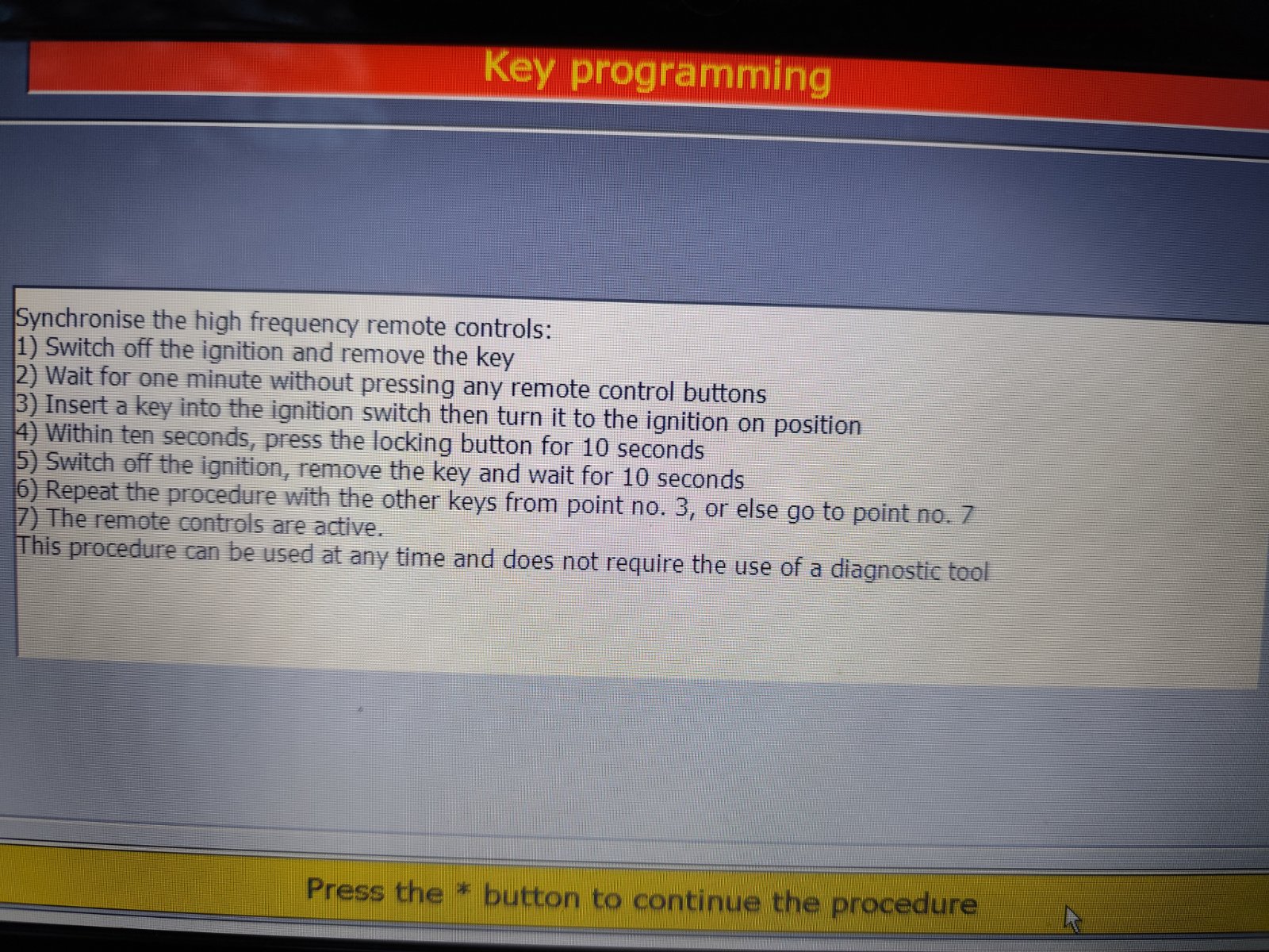

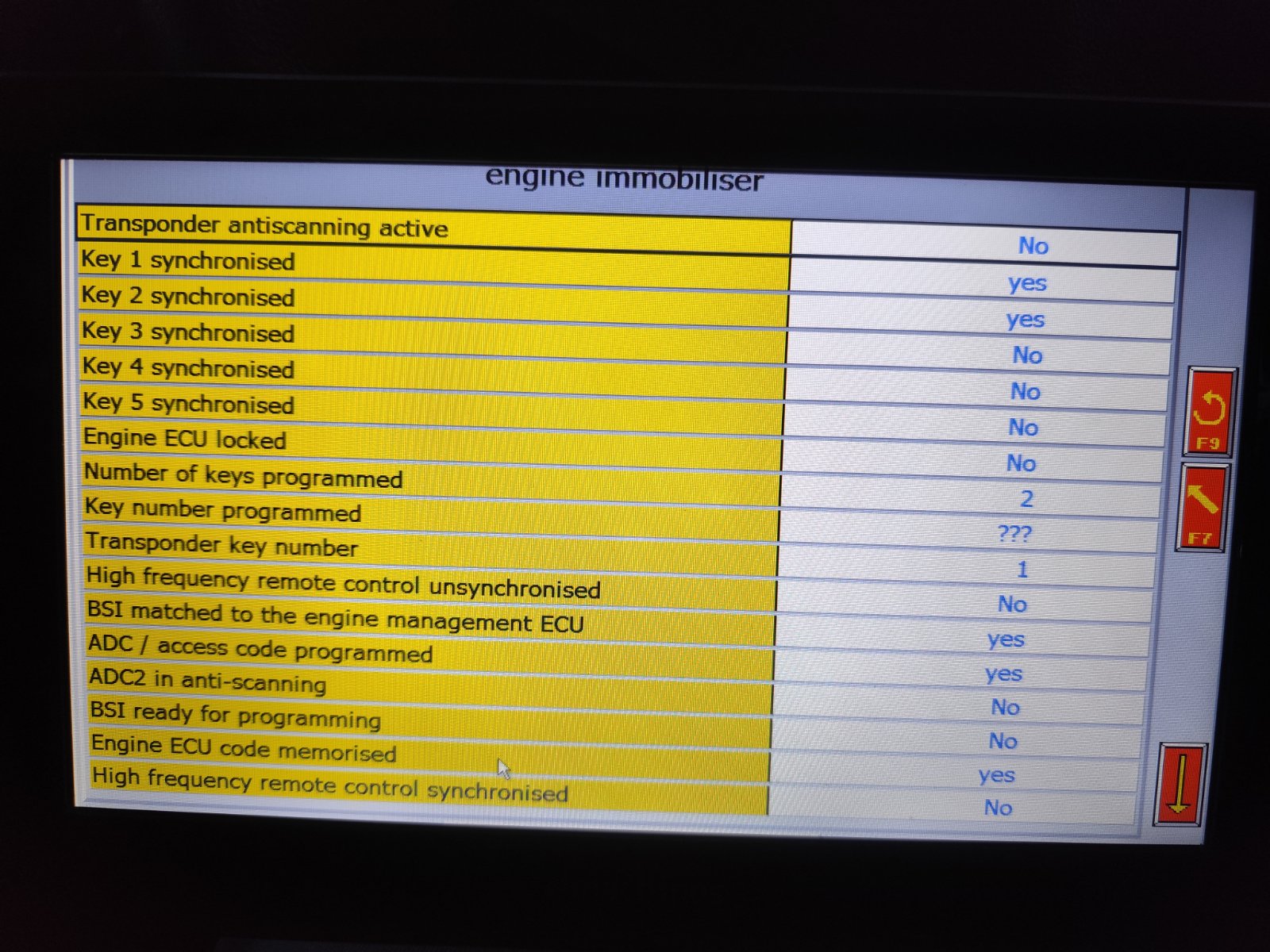

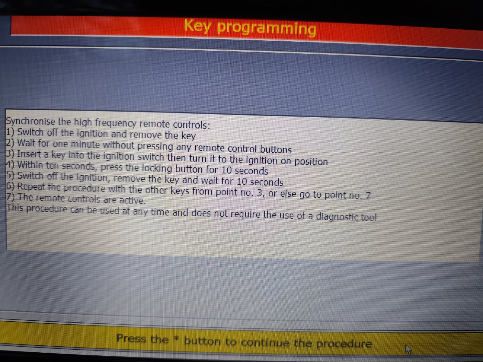

I also had strange issues now when trying to get the key transmitter to work. I recently swapped to a new battery and went to a key copy place to make sure that signal is being sent with button presses - and sure enough some signal is sent. So I programmed my both keys in Lexia, no issues with that. But synchronizing the key fob does not work. I tried multiple times with the instructions displayed in Lexia (ignition, hold locking button, like in the screenshots). Didn't get the FOB paired. But also when I finished with my key attempts, central lock stopped working completely - economy mode. I turned on the engine but lights didn't come on either automatically or by turning the stalk?
So I took the battery out of the car and left it to charge overnight. Today the strange symptoms are gone. Even stranger is that the key FOB started working :-D
