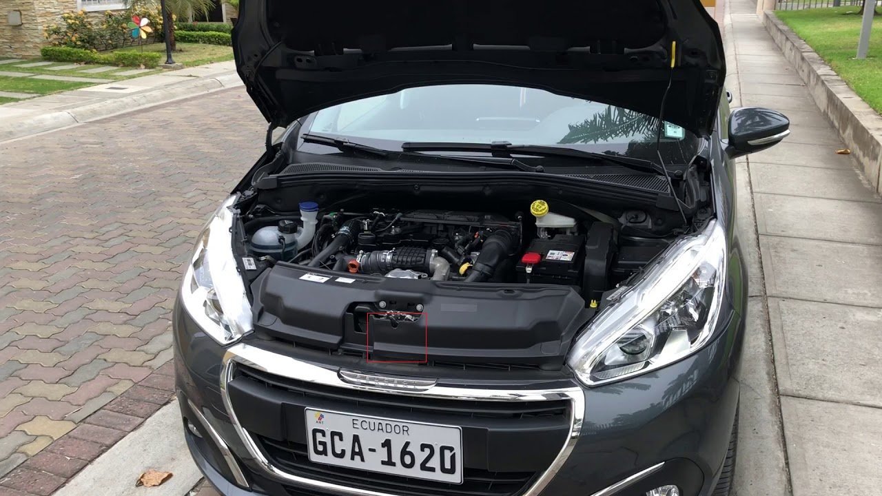

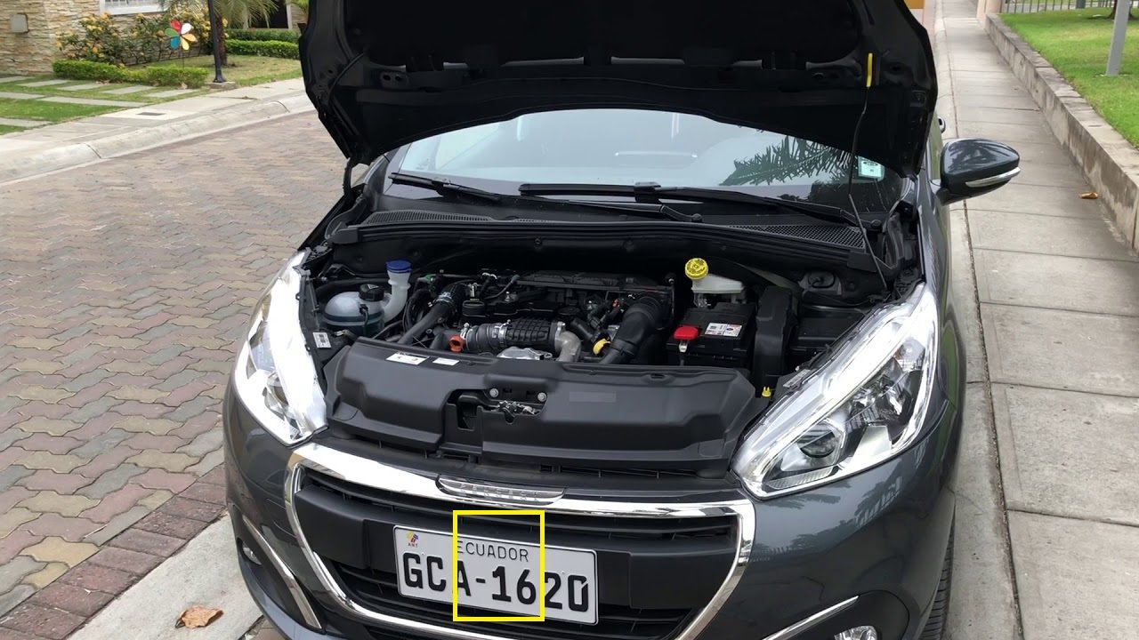

I can already remove the grill along with the chrome surround, which exposes the radiator, that gives me a bit better access, the bonnet ends just above the "PEUGEOT" logo on the front grill, which also comes away when you remove the grill. But the part i need access too is above that, covered by the bonnet.mickthemaverick wrote: 24 Jul 2025, 20:44 I think I would take off the chrome surround, probably prises off with a plastic trim tool, remove the number plate and then cut into the grill, if you can't get it off because the top fixings are under the lip of the bonnet, roughly as I've drawn on the picture. Then you should be able to get a hook up onto the release lever and pull it open.![]()
If you cut it carefully you may even be able to glue it back together afterwards as the number plate will hide most of the join.

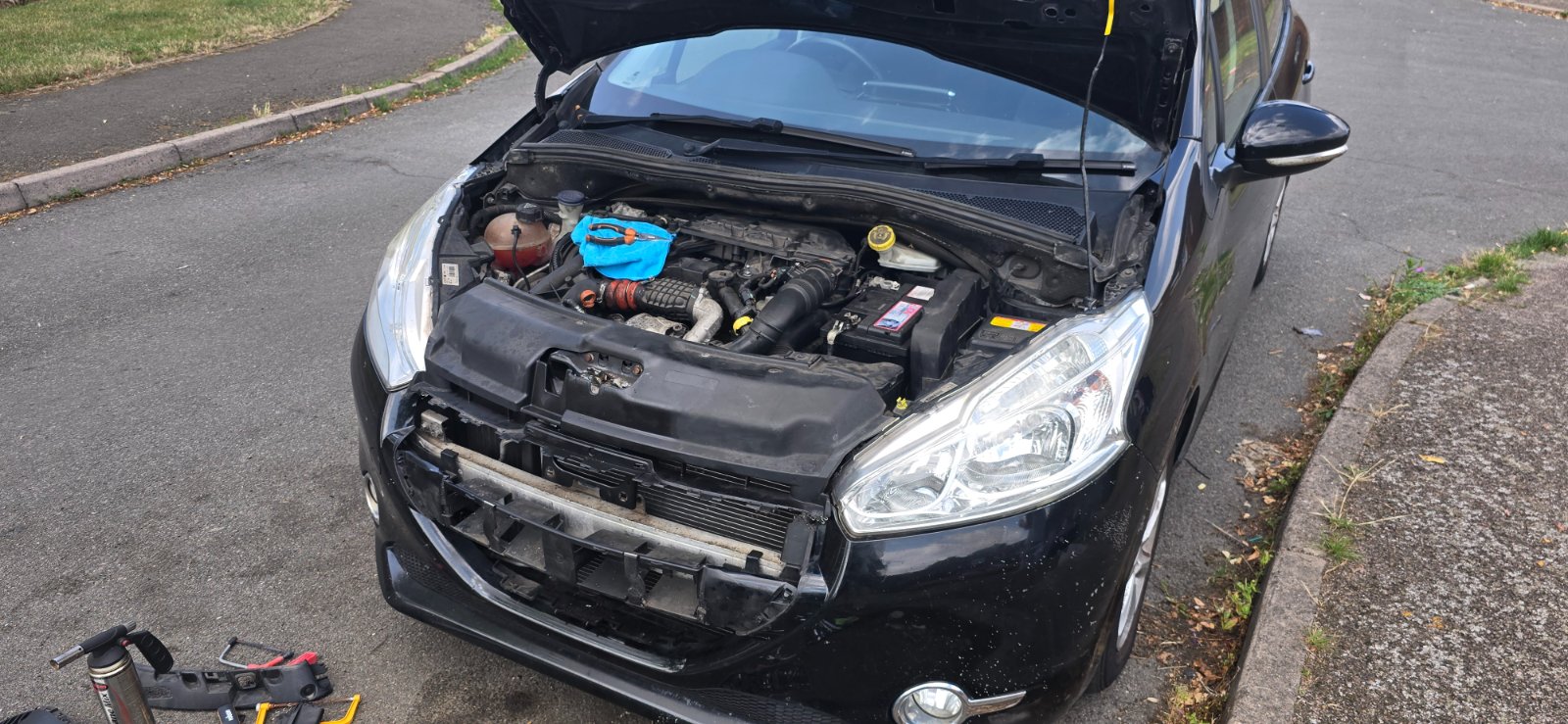

We have success. After a lot of swearing anyway.
Removed the two bolts holding the latch mount, you still cant lift the bonnet, but you get access to the latch. I fed my made up wire in from the left and pushed, as coming in from the right. You cant pull it. Ill get a youtube video up at some point explaining it. I now need to replace the release cable though, but I now have access to the engine bay, now to sort a few things out.
