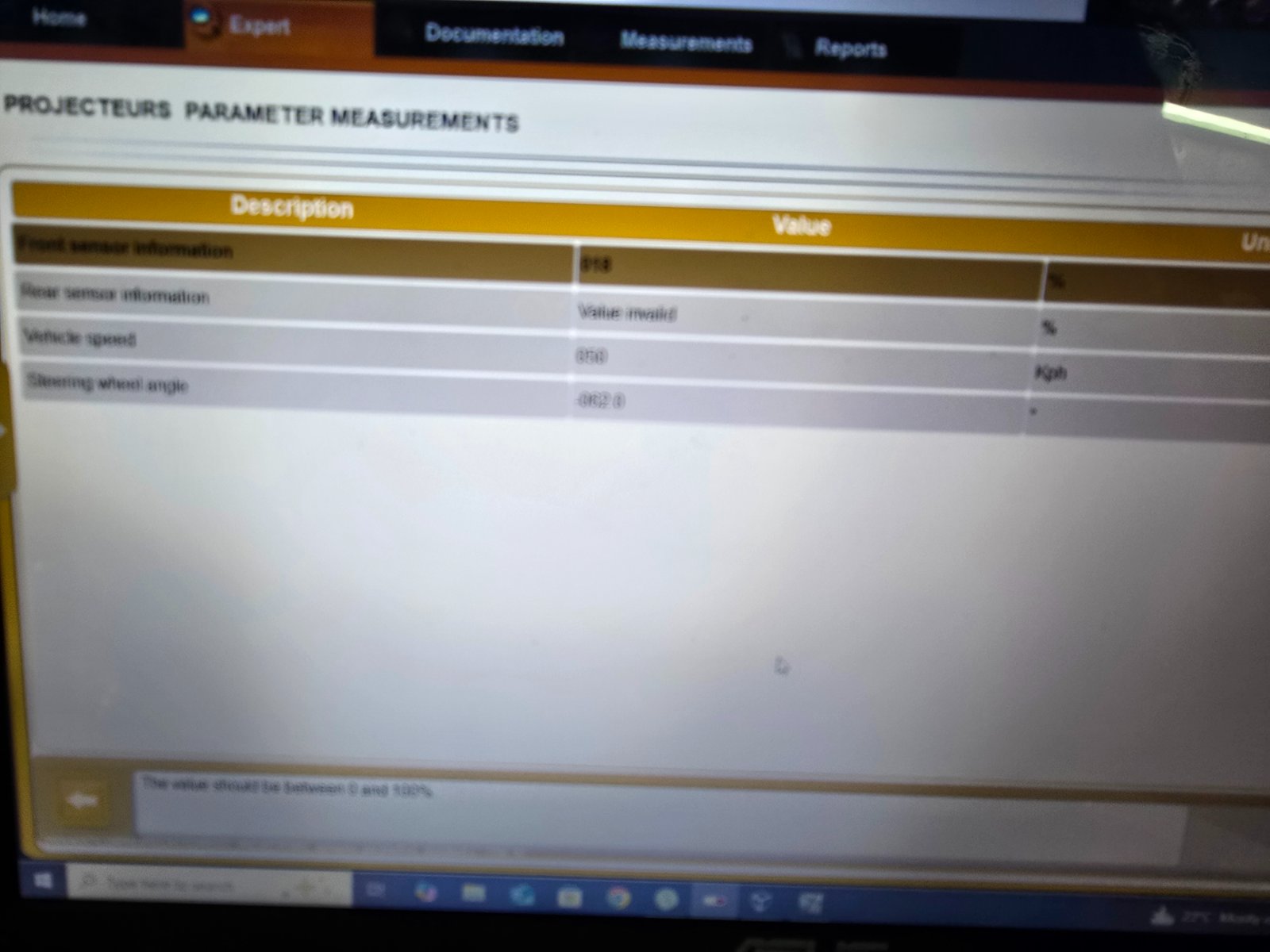

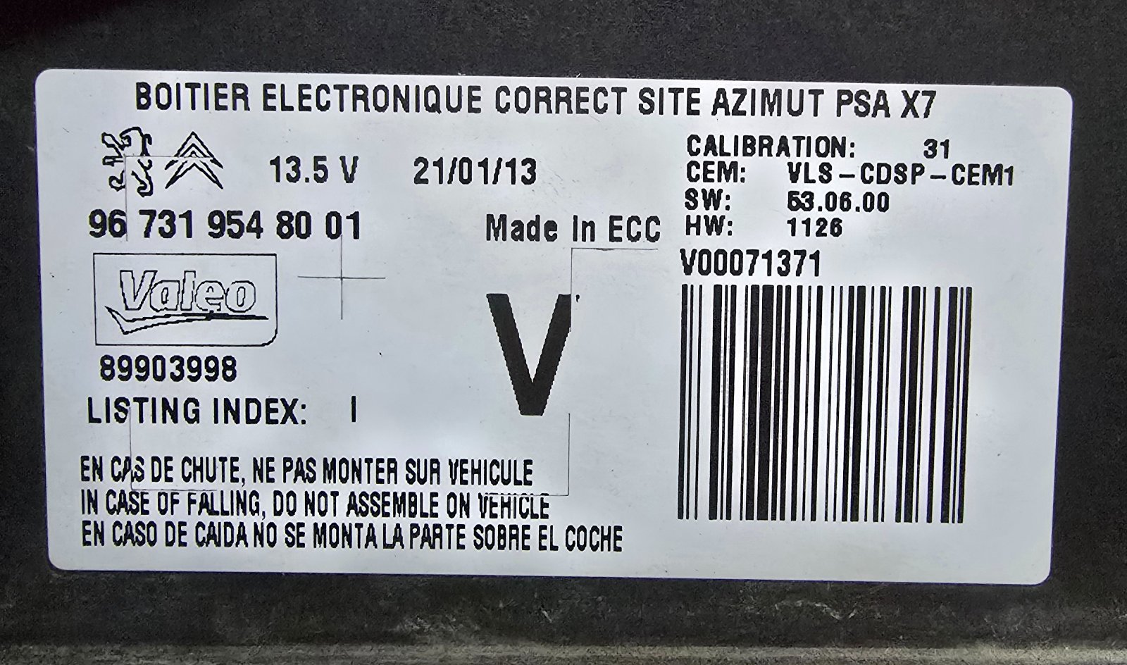

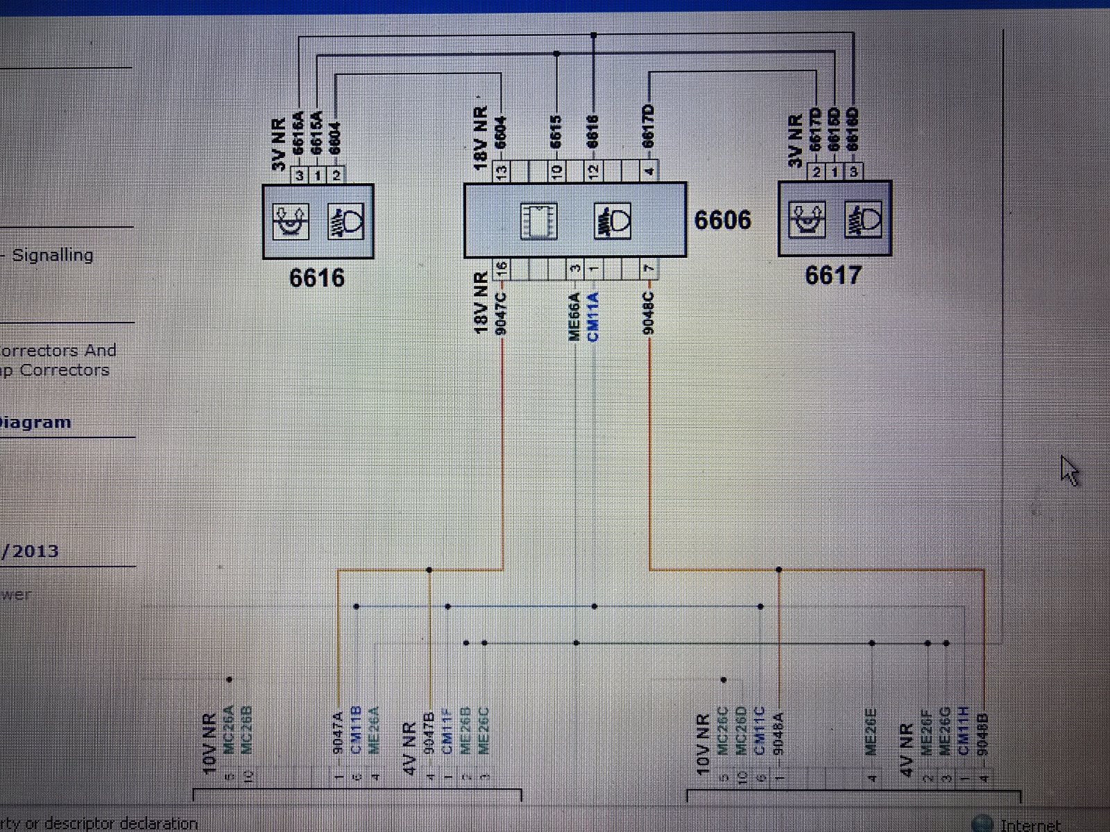

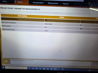

Okay,so the diagram is definitely wrong because when i move the sensors up and down i dont get anything changed in front or rear sensor height but i change speed of the vehicle in diagbox parameter measurement, now good question is how the hell do i get the right diagram part number is 96 731 954 80 01 prod. date 21/01/13

Okay, so I guess I will somehow now need a diagram specified for this headlights ECU.

Little update,
C2 wire changes vehicle speed.
C3 wire changes steering wheel angle.
When changing the angle of the potentiometer (height sensor),
so basically, to me it looks like the car is not picking up those parameters from CAN as it should, but instead from wires, which again makes no sense.
So I'm kinda stuck right now.
At least now it is confirmed that diagrams that I've got from Citroen wiring diagrams are for sure not accurate and the right ones.

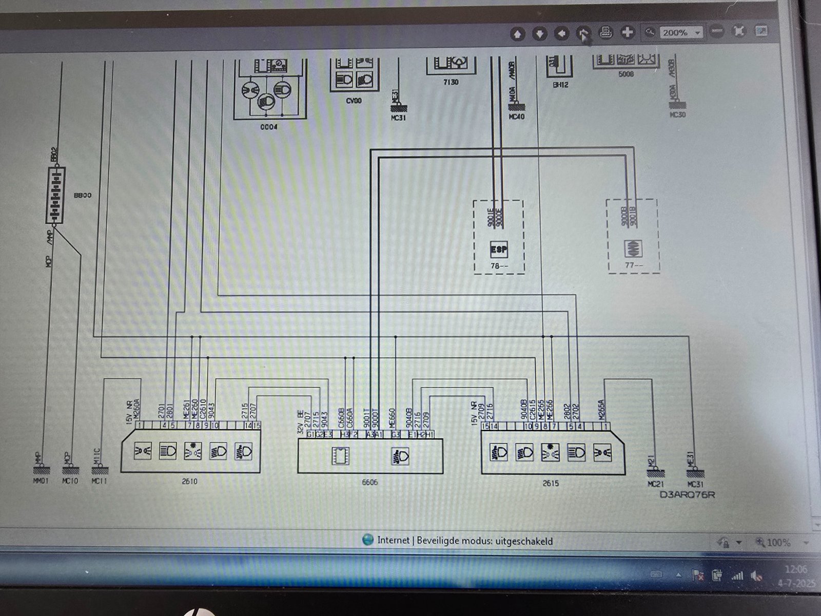

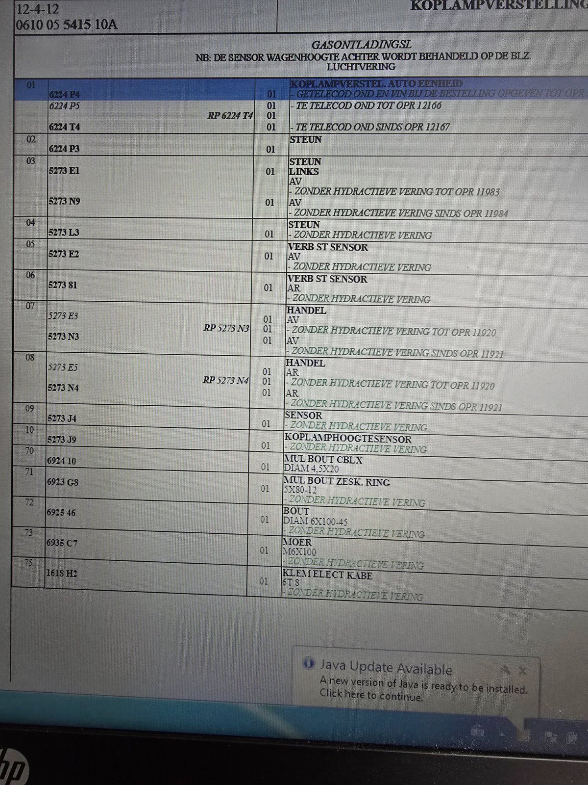

When I search on this partnumber it's seems that it comes from a C5 2.0 hydraulic car.
I find this (see pic) on the forum here is 6600 the cpu, and 77... is the BHI on top of the pomp.
But this means, the info for the cpu comes from the can bus, because the data from the height sensors is processed by the BHI.

Yup, I guess that Xenon and non-hydro suspension is like a needle in a haystack, even though it was factory made (because there is a diagram in the same program u took a picture of)Kees wrote: 05 Jul 2025, 09:25 When I search on this partnumber it's seems that it comes from a C5 2.0 hydraulic car.
Life would be easier if I could find a part number for a non-hydro suspension ECU. But I guess that is also impossible. Hmm, I'm wondering if does 508 Peugeot uses the same one? Since he also has beam correction and directional lights.

The part no# is also in the picture, it's 6224P5,
I also find a part no 6224P4, it seems, this is one is also used by peugeot.
But what I understand is the RP part number 6224T4
This pic below is from the service box #1,are the CPU part numbers.

I am pleased to report that the issue has been resolved.
Here is the final update regarding the work.
Initially, I considered utilizing the available slots on the connector. Despite the fact that adjusting the height sensors altered the vehicle speed and steering angle, the diagram was accurate. However, the diagnostic tool was not displaying the actual values for some reason.
The car was brought in for servicing, allowing me to examine the sensor configuration when the vehicle was on level ground. I then adjusted the rear sensor to a nearly identical position and attempted to clear the fault, which was successfully accomplished. Subsequently, I measured the signal wire from the rear sensor, which indicated a reading of 2.6 V. Following this, I measured and set the front sensor to 2.6V and attempted to clear the fault codes; the faults related to the signal wires were resolved. I then proceeded to learn the vehicle height, and the procedure was completed successfully. Therefore, the only remaining step is to position the car on level ground and adjust the sensors to achieve a signal output of 2.6 V. Everything is functioning as intended, just as if the car had been equipped with Xenon headlights from the factory.
As an additional note, the number on the headlights correction module is unrelated to the issue I encountered; it functions correctly on both the V module I had and the one labeled Q, which I subsequently purchased.
I would be very pleased to answer any questions from those who are considering retrofitting their vehicles.
I am very grateful to everyone who has taken the time to assist me with the retrofit.
My next reteofit is the sunroof and a Phillips hi-fi sound system next, so keep an eye out.
