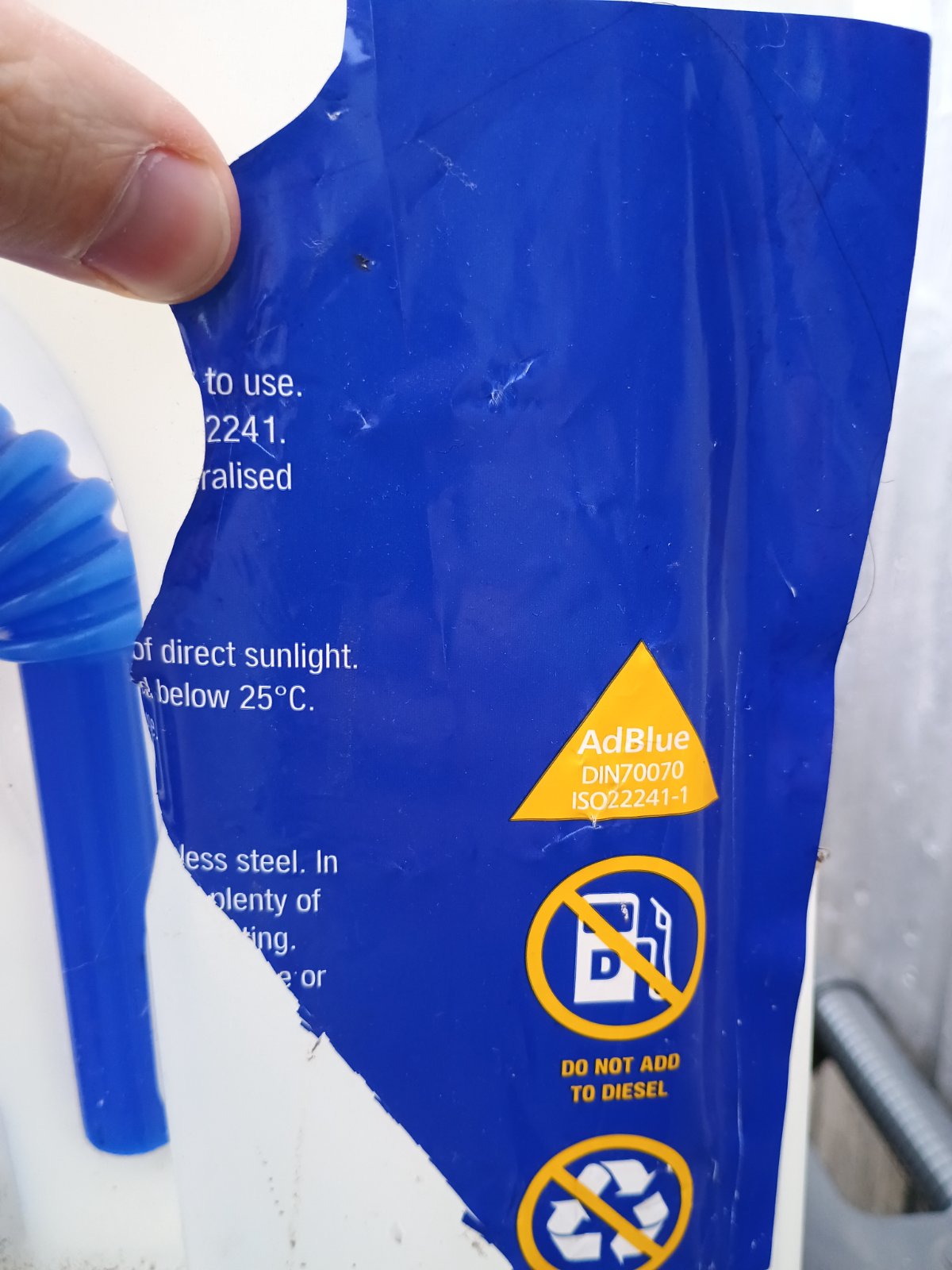

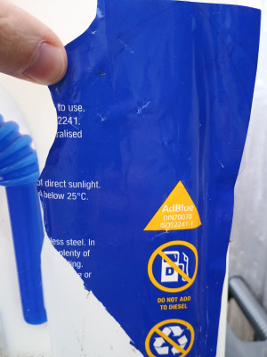

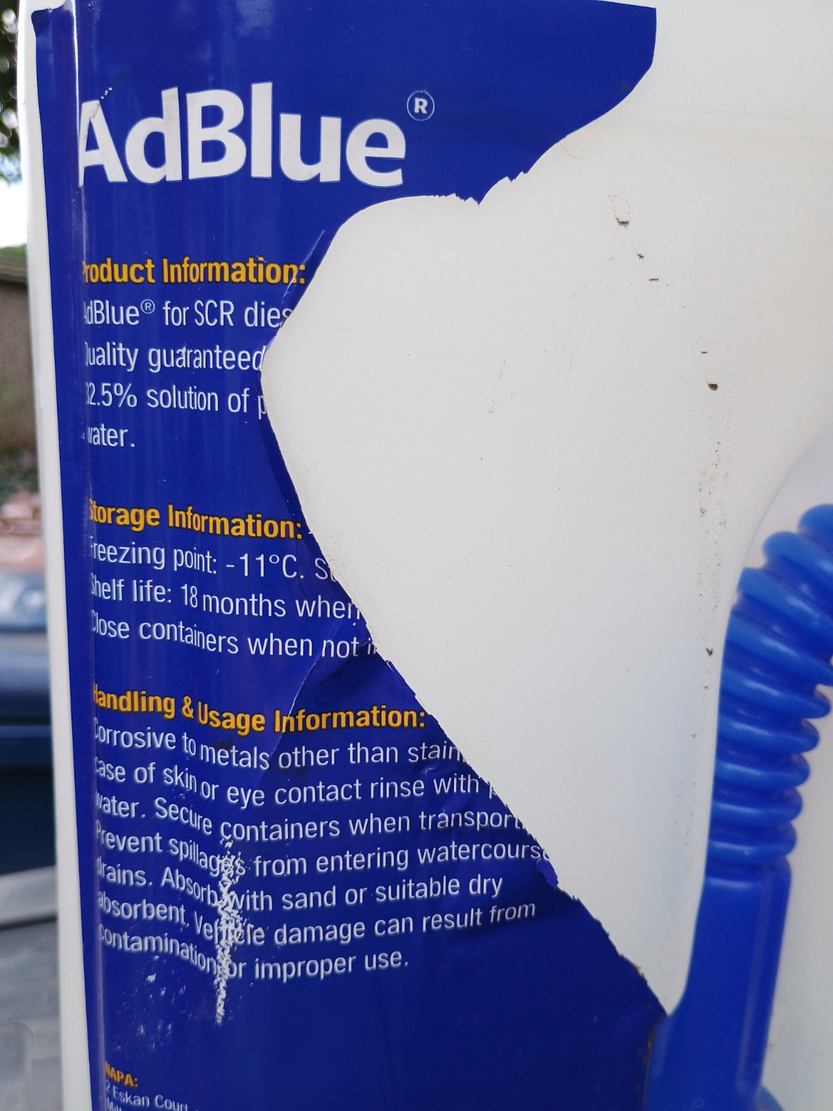

I forgot the label was torn!
Storage instruction the freezing point - 11°C. Store out of direct sunlight. Shelf life: 18 months when (sto)red below 25°C.
Close containers when not in (u)se.
Bracketed bits are my guesses what's missing!
