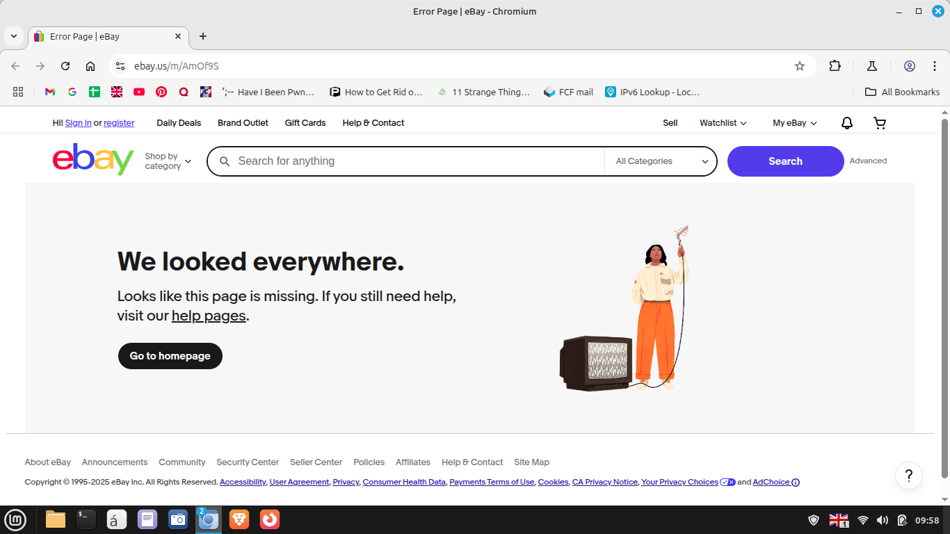

something wrong there!boristhespie wrote: 23 May 2025, 09:09 Seen these.
https://ebay.us/m/AmOf9S
I aint mechanically minded
- Posts: 9386
- x 1939
Re: Suspension collapse and p1shin what I guess is hydraulic oil
I got that message as well. And then I tried again and it worked!
