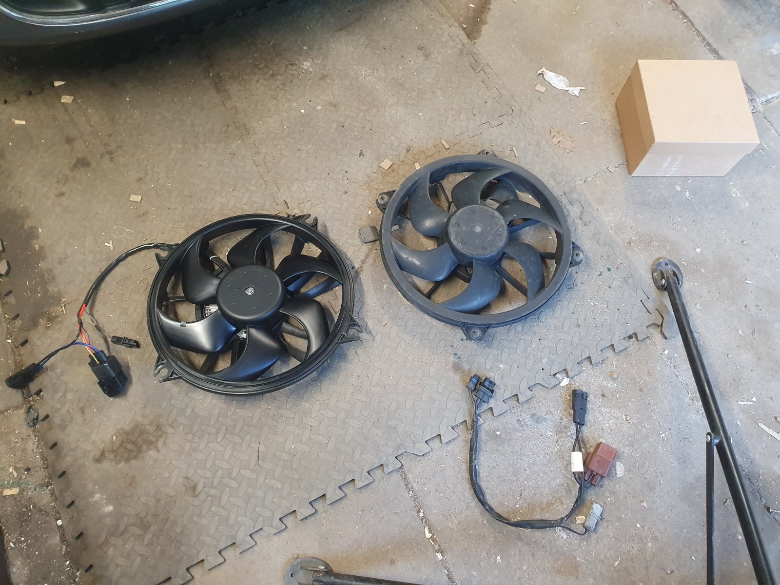

I had ordered a replacement radiator fan from autodoc and that arrived this evening. Fairly easy fit. But still something is wrong. Lexia actuator test fit the fan gives two options: low speed fan and high speed fan. Activating low speed fan nothing happens and the lexia says "component not started"
Activating the high speed fan and the new fan starts very slowly and gets faster until it's apparently at full speed then the test times out. I think the new fan works then? Not sure what the low speed fan option was about.
Had the car running up to temperature and idling for an hour and the fan did not come on at all. The a/c being on similarly doesn't make the fan come on.
All the time with the rad fan not working the engine never overheats...
I do notice that the fan does come on slightly when I unlock the doors. Not sure what that's about either.

The fault code related to the fan was P495 , a fan speed coherence thing. Is still there after new fan fitted.
The other fan fault P691 temporary fault 'High Speed fan control SC. To earth' had now cleared since fitting the new fan.
Not sure what this fan business is about. I think the old fan was definitely duff but the new one doesn't seem to be activated by the car running. Only the lexia makes it run. I was hoping the a/c would start working with the new fan but it still doesn't.

Ha, OK although the fan wouldn't turn on engine idling last night for an hour it seems that it was running as I pulled in the drive returning home this afternoon, it's cooler today but was a bit of traffic. Possibly it is working OK. The fan is smarter than me :lol:
Graeme M
Posts: 5338
Joined: 25 Apr 2022, 09:03
x 2356
Re: C5X7 2.0 hdi auto just stalled twice. No clue
Unread post by MattBLancs »
Ha ha! flipping technology!
I did think it odd Diagbox could tell the ECU to run the fan but the ECU didn't seem keen to do so itself. Mind you an idling diesel does not produce much heat at all, so perhaps it just wasn't getting hot enough like that

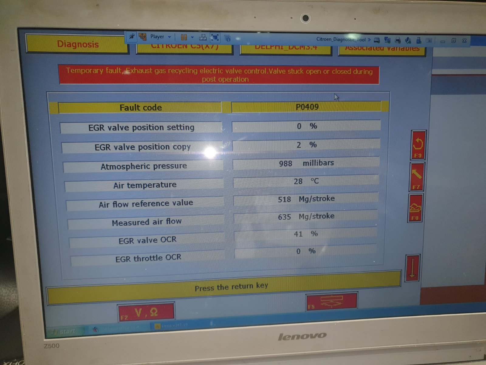

Hi all, problem has returned! Idling the engine goes off. Always seems to restart and raised revs seem to prevent it, can even 'catch' it before it stalls with the throttle much like in a carburetor engine.
Only fault is P0409 to do with EGR valve.
Colleague suggested it could be stuck causing air intake imbalance or such. Does a grotty or sticking egr cause stalling?

Still doing it. Drove fine all the way to work. In car park. Idling it dies after a minute. Restarts, dies. Repeat. Then find that raising the revs and holding it runs OK.
Return this afternoon home. Heavier traffic. Makes it with not a hint of poroblem. Idling in the drive while I open garage it dies... seems to be when it's done a journey.
I changed the fuel filter (in the middle of doing service items anyway) old filter black but less than 18 months old. New one in. Running but the stalling soon shows up.
Kind of sounds like the engine knocks before it stalls. No other fault codes since yesterday so perhaps it is this egr valve sticking.

Thanks matt, I ran the actuator tests via lexia an seemingly everything was clicking or buzzing as intended. I'm still tending toward the EGR valve at this point

Well ifitted a egr blanking plate to see if anything changed. Its still doing it when hot
