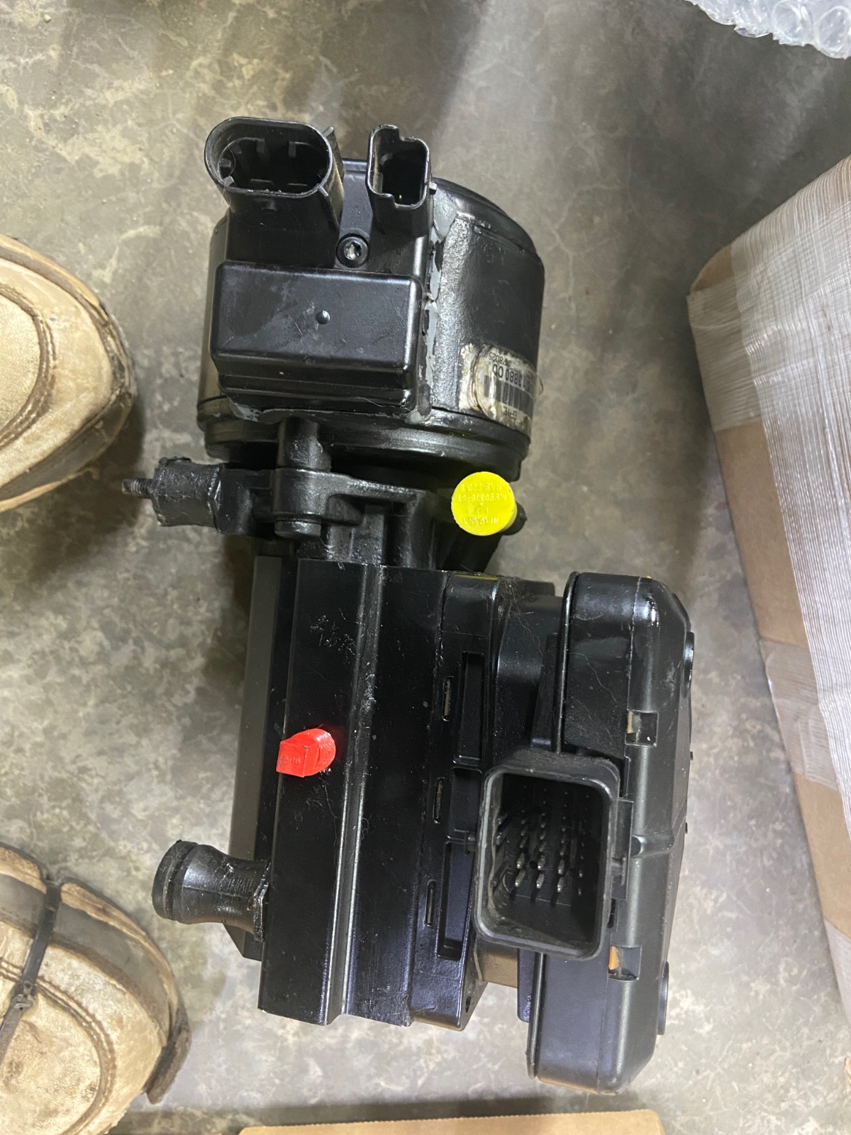

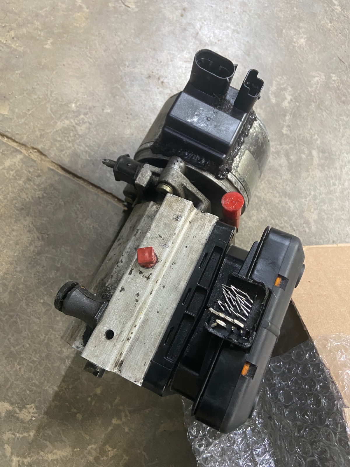

Here are photos of the 3 Pumps that I have. One was from junkyard in Europe (messed up pins) the black one I believe is a refurbished unit and the one that’s on the car now

It’s the part numbers on the units (original and current) that need to be checked to confirm match ok.
Do you have access to a Lexia/Diagbox and if so, what happens if you command the pump run etc. from that - does it?

If there are no numbers visible anymore, and you don't know from what type of c6 comes from i think it's better to replace the original pomp, because the BHI on top of the pomp is different from other C6 types without AMVAR system.

It's oke, no problem the Citroën has several computers the main is the BSI.
The BHI is on top of the compressor behind the pomp and calculate several signals and commands the valves to let the pomp pressure to the struts or just release the pressure.
This is why I say several times this one must be the same as original mounted on the car.
So it's not a problem to mount a pomp unit from a different car, but then you have to replace the BHI from this unit with the original one from the car.
