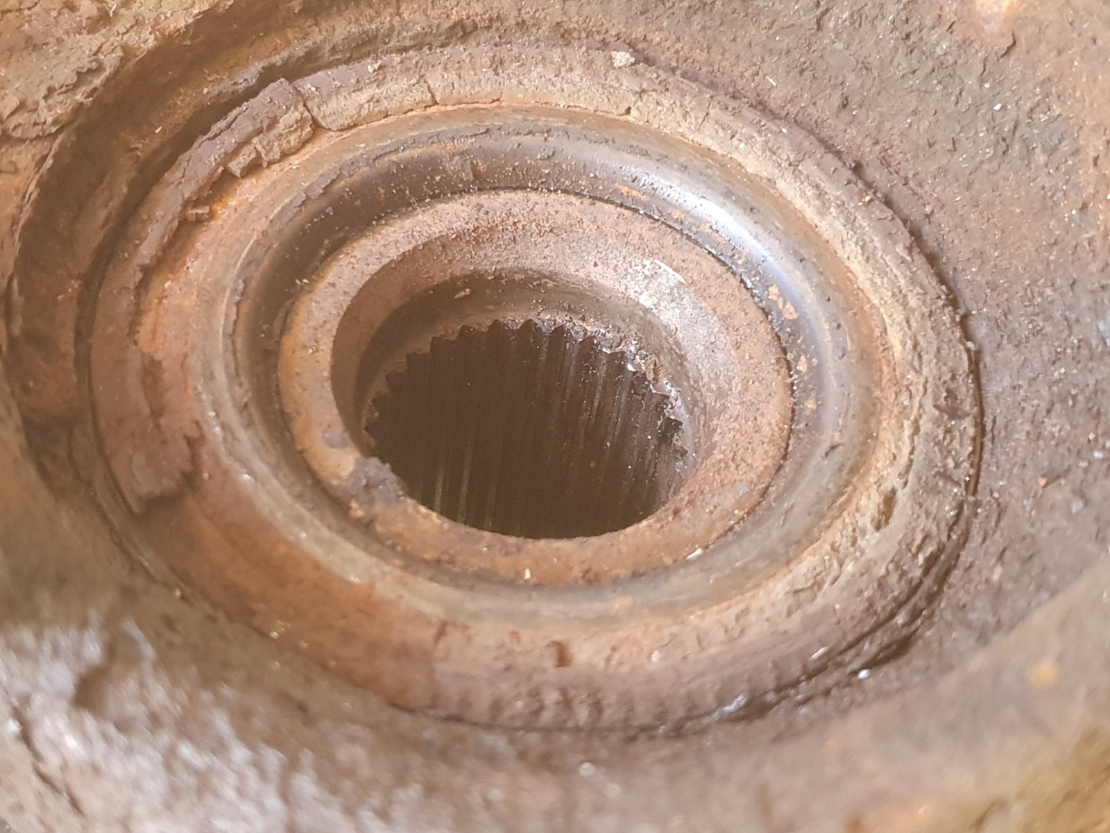

Still got my kit down here in Lanark, and got a version of Diagbox 9.x if you want to try something later... but if you've changed the sensor and it's able to read it, and the fault is repeatable, then most likely it's the bearing - but sometimes a build up of rust under the sensor can give false readings. You should be able to see the track if you take the sensor out, and then rotate the wheel to see if there are any duff looking spots.

Well it's fixed. And Richard W is the winner! The old magnetic track was in a poor state and looks like bits of it have indeed dropped off.

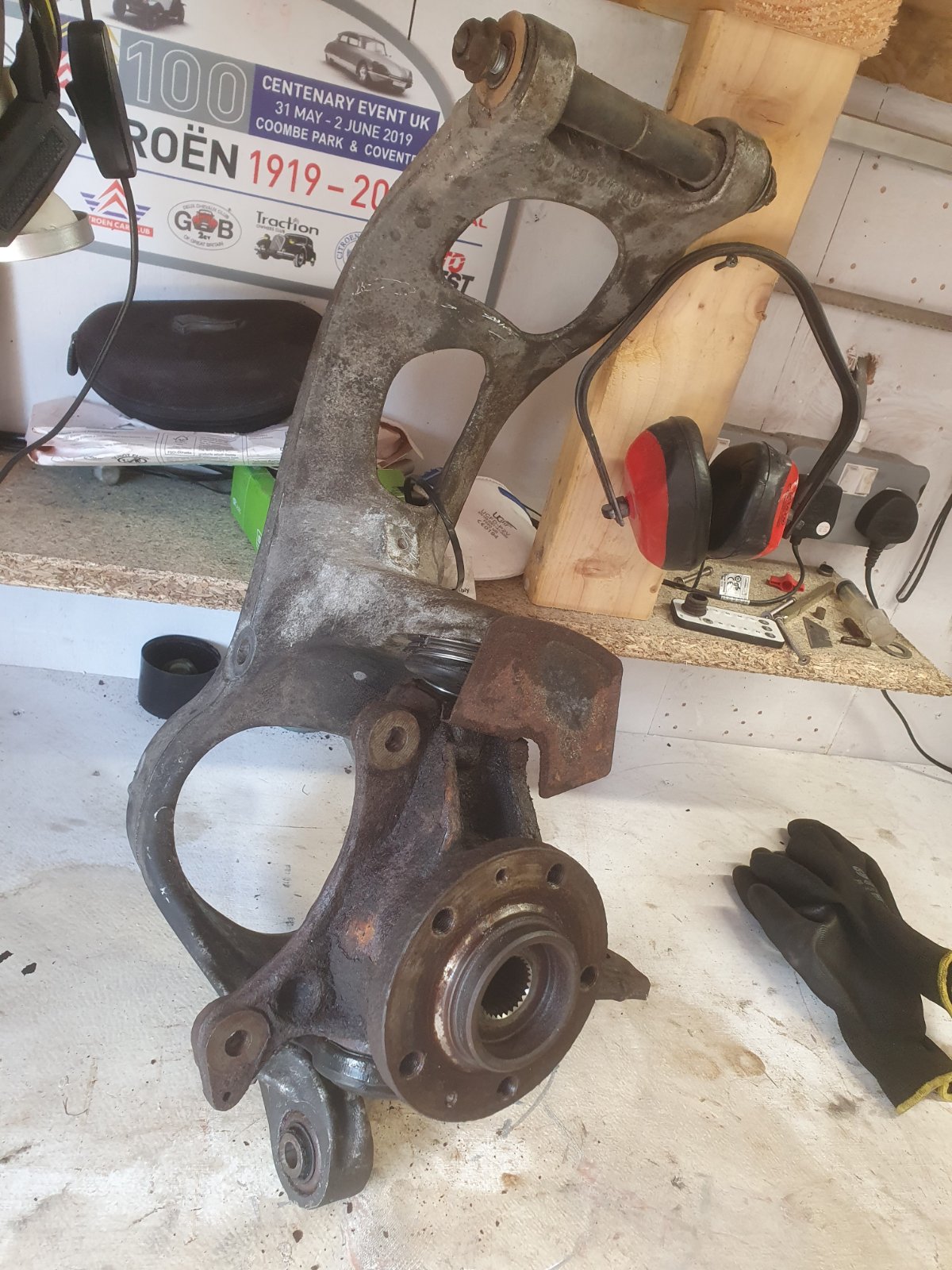

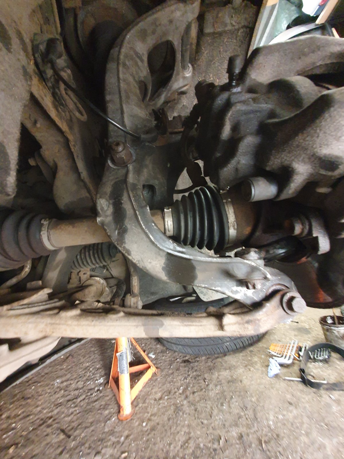

So my approach after fitting a new sensor and finding no change was to order a new wheel bearing. A search on eBay found a full LH hub carrier and at £35 I thought that was an idea because it means I can change the bearing and ball joints off the car and then swap over the lot. As it happens the part arrived today and it actually has a very good hub bearing. It also has a SKF frip joint. I took off the hub from the alloy upright, and also went to remove the dreaded upper ball joint which actually out up no struggle to remove! Unlike the other side over a year ago. So it has a new upper joint, frip joint is in good order and the lower pinch bolt bushing was also in good order so I swapped over the lot and cleared all the fault codes. Test drive and no sign of the array of faults now.
Plan was to refurbish the original hub carrier with the new wheel bearing etc but the replacement one was so much better anyway I'll just hang on to it.
The hub carrier is actually from a 2006 C6 and I was chancing it that it would be identical and it is. Was from ecoparts, an online breaker in Ireland but the get praise for their speed of delivery.]
