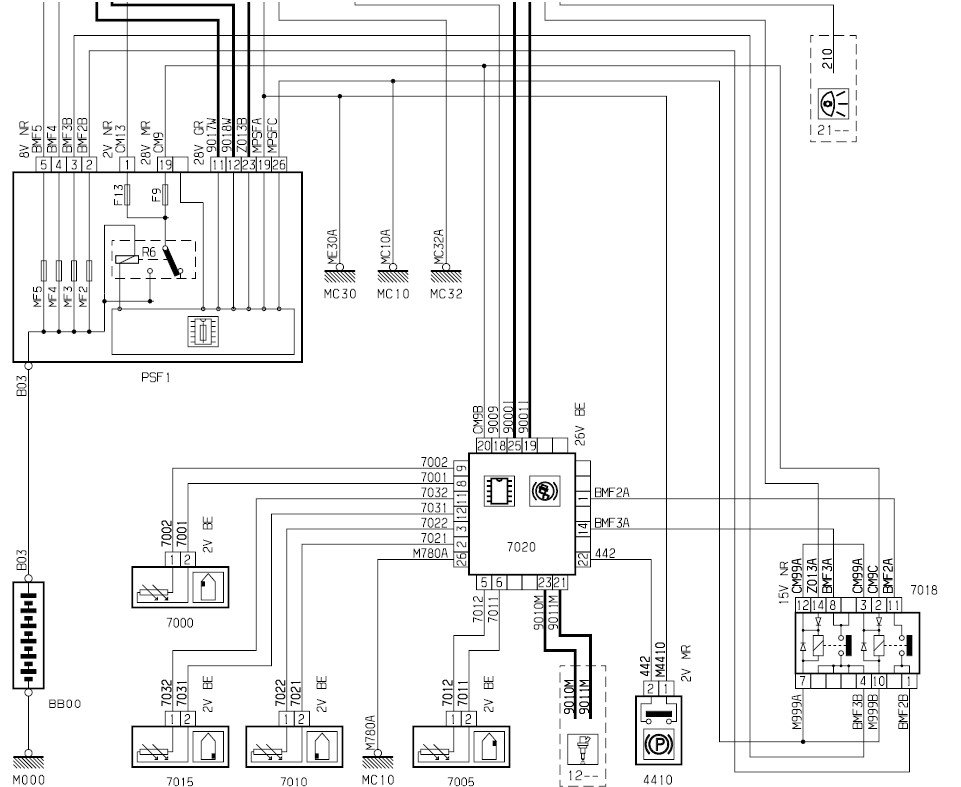

wheeler
Posts: 7928
Joined: 21 Sep 2002, 19:07
x 1053
Re: Citroen c2
Unread post by wheeler »
Yeah, got it. Will try get a diagram just now
wheeler
Posts: 7928
x 1053
Re: Citroen c2
OK so you want to be checking the ABS ECU connector for Battery voltage at pins 1, 14 & 20 when the ignition is switched on. Check that pin 26 has a good earth, (ideally load test the wire)

Unread post by Juliano_1989 »
Just pin 26 as a load test ???
Also is the abs ecu attached to the abs pump ?? Thanks so much for your help
