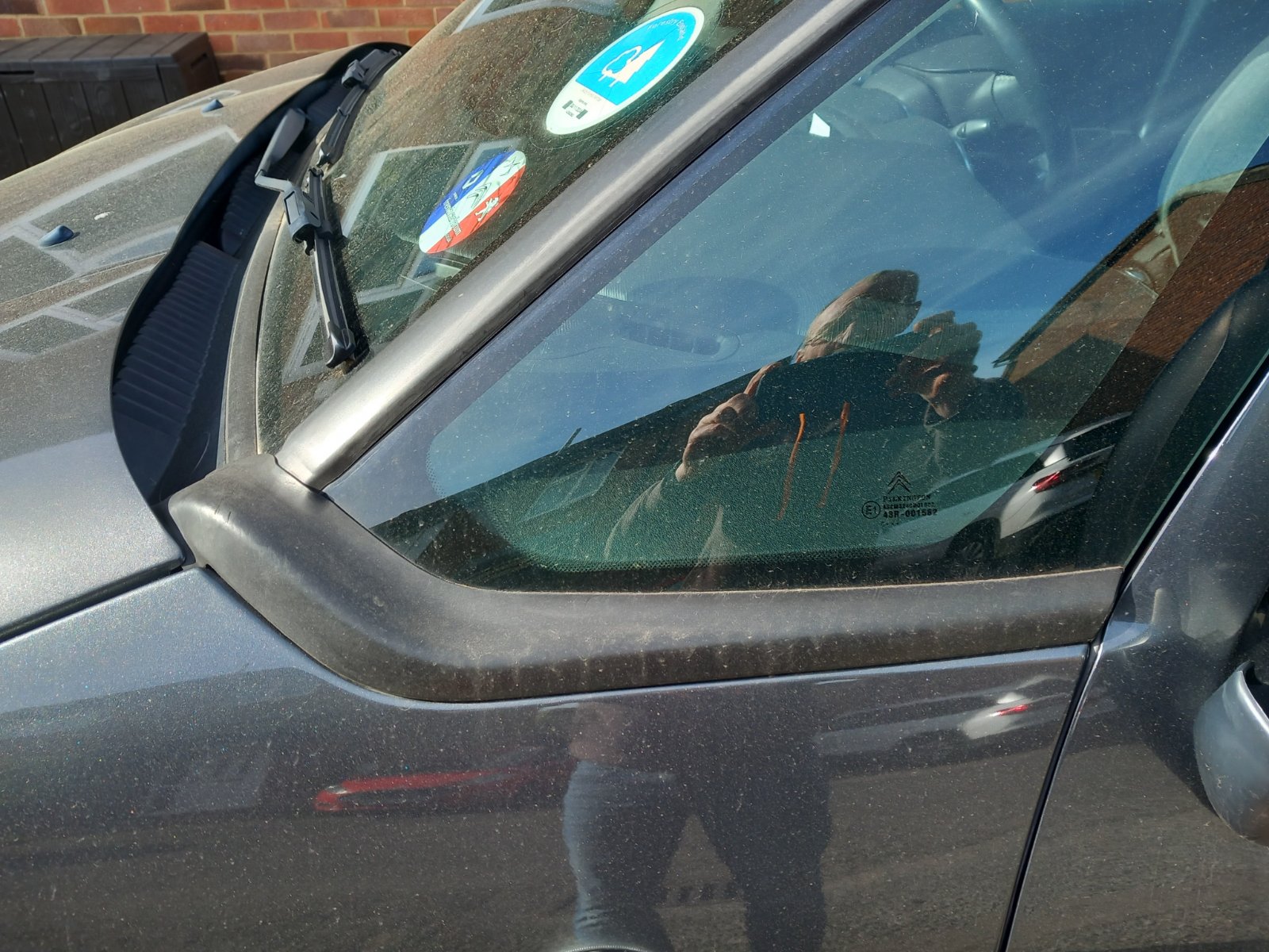

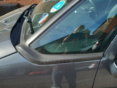

This bit of trim is worth keeping an eye on... I've had mine detach itself and when I checked, it was not fully clicked home...
Not being properly secured could allow water into the electrical area...
It was only my sharp-eyed passenger who noticed it flapping around that saved it being lost completely

You have hit a very valid point I must say, and it is just below this n/s wing as to where the Fusebox housing is located, so I must double check mine in the morning, thank you.
