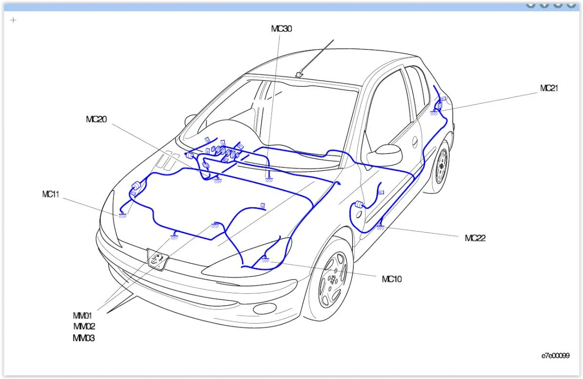

I can't find the mm01 grounding point anywhere,
it's under the two front lights, and I also found it under the battery.

On HDI engines the MM01 grounding point is on the right corner of the engine nearer to the firewall (from the view of standing in front of the car).
Also most abused grounding point on 206 is the one under battery tray. Moisture keeps collecting there and it's usually the first one to corrode.

Arkis wrote: 18 Mar 2025, 05:59 On HDI engines the MM01 grounding point is on the right corner of the engine nearer to the firewall (from the view of standing in front of the car).
Unfortunately, there is no such point on the 1.4 HDi engine as shown in the video,
But I'm not giving up, I've solved a much more serious problem with my car :)
