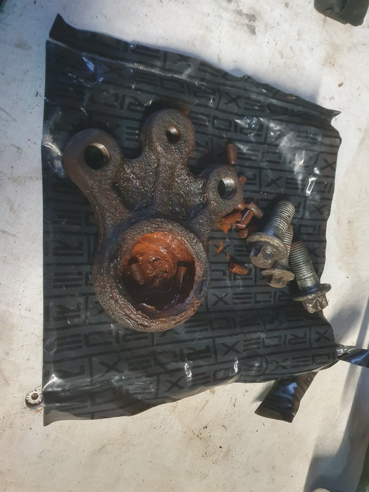

I just changed the remaining swivel joint (frip type) and I could be dreaming but the knocking improved
. Still there though.

Here's a picture of the state of the frip joint that removed from the car.
It's an SKF one so I assume it's the factory original

My original joint (also SKF) looked way better than yours, my mechanic told me it shouldn't be replaced yet, but since i did everything on front end i replaced them also.
I'm still having the knocks and stiff suspension.
