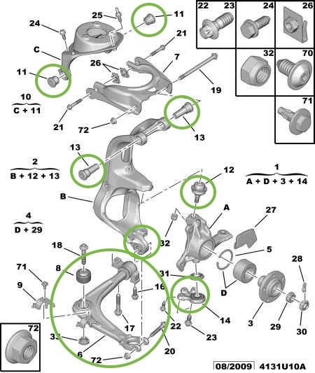

My 2012 C5 X7 with hydraulic suspension has a front clunking noise on bad road surfaces/ repeated road imperfections. I feel the clunk coming especially from left driver side at the feet/ pedals level.

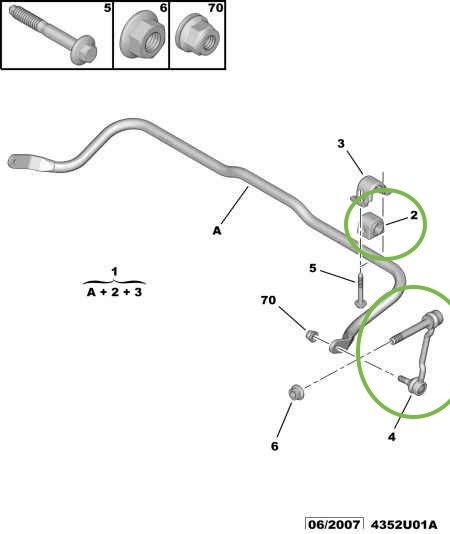

I have replaced all the bushings/ joints/ arms/ links as you can see in the photo, and i can still feel it, at a lower level than before but it still exists.
Is there any chance that the noise may come from the steering pinion? The shaft that it goes with steering column?
I really don't know where to look at since everything is new :(
Thanks in advance!

On the front axle the inner control arm bushes were changed (all4) last year, the outer lower bush, anti roll bar droplinks.
I am unsure where else can cause a knocking. The upper arm bushes, to me I feel these wouldn't cause a knocking but I could be surprised....
I looked at the anti roll bar bushes and couldn't detect any movement in them.

Is the nut (Nr. 32) of the upper ball joint (Nr. 12) tight ? Check and re tighten it. Otherwise check play in brake pads and caliper.
aerodynamica
Posts: 1689
Joined: 26 Dec 2007, 18:10
x 215
Re: Citroen C5 X7 front clunking noise.
Post by aerodynamica »
kantica wrote: 18 Mar 2025, 12:02 Is the nut (Nr. 32) of the upper ball joint (Nr. 12) tight ? Check and re tighten it. Otherwise check play in brake pads and caliper.
Thanks, 32 is OK. Very hard to check but this was done last year with the inner bushings renewal. I'll have alook at the brakes
