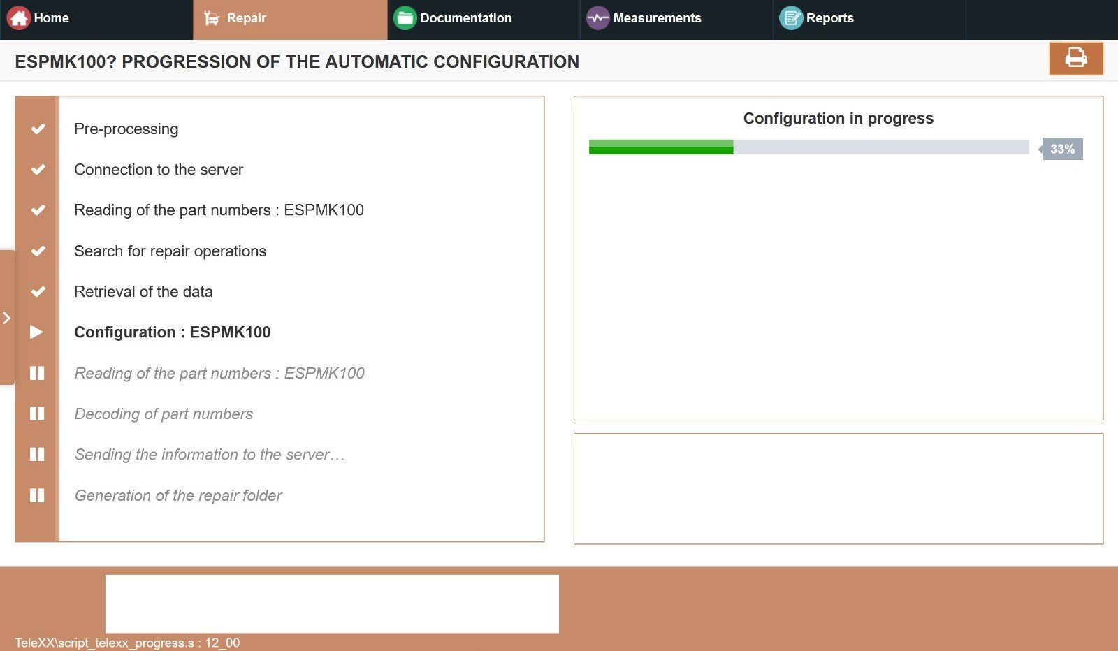

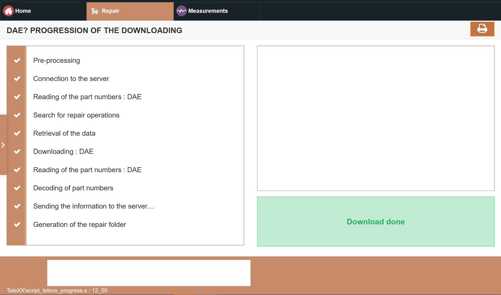

Thanks, just emailed Citroen. See what they say.
Got a company to play around with Diagbox again tomorrow again so any update, will post here.

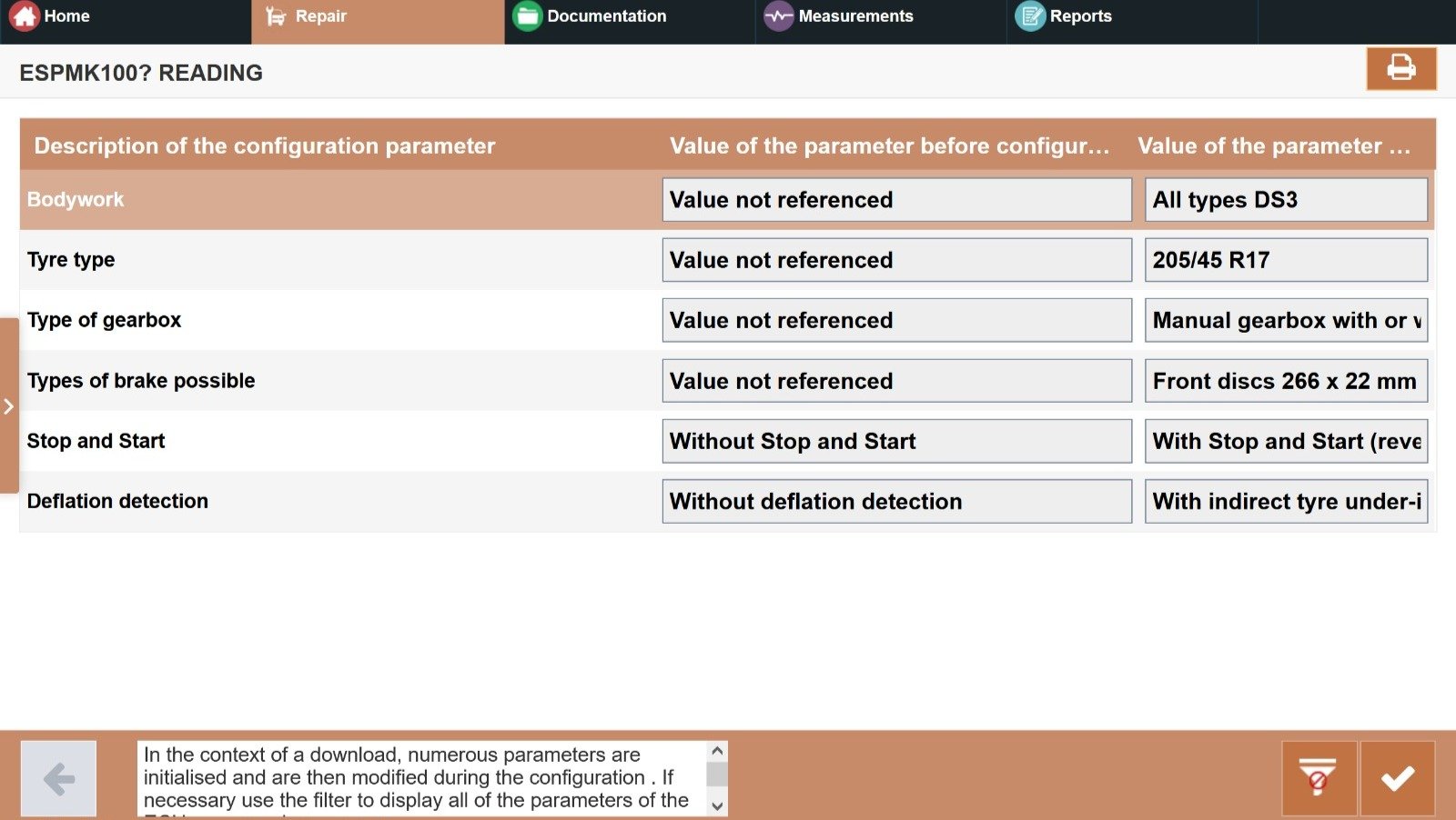

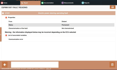

Where are you seeing the reference numbers?Myles97 wrote: 16 Nov 2025, 21:26 Edit: Looking at the attached images there is different software reference numbers to that of the rack fitted to the car.
Old: 96 670 397 80
New: 96 717 322 80
Iain
CX DTR T2 Safari (silver)
Iain

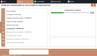

And with the Diagbox, surely if a module was off a different DS3 and still works aside from another module/ECU complaining about it. I would have thought, the software could be downloaded from the servers and put onto the new rack that would communicate to the car properly, otherwise whats the point in telecoding and the need to connect to the server via a token in general.
I know its a long stretch asking this but If anyone could assist with the ability to download the software version of their steering rack for the same model (2015, DS3 1.6HDi) and send it to me. I can then get this put on the car via Diagbox (Supposedly)

In one of the screenshots I added, it says the 'reference of the software or of the calibration', taking a look on eBay at DS3 steering racks, they are on a sticker (each rack varies). When mentioned to Citroen, these mean nothing to them (or at least the parts department)wurlycorner wrote: 17 Nov 2025, 22:28Where are you seeing the reference numbers?Myles97 wrote: 16 Nov 2025, 21:26 Edit: Looking at the attached images there is different software reference numbers to that of the rack fitted to the car.
Old: 96 670 397 80
New: 96 717 322 80
The item listing on eBay for the new rack which is on the car shows (96 717 322 80) whereas the one in diagbox shows (96 670 397 80) so Im unsure whether they're related or not and thats why its complaining... who knows.

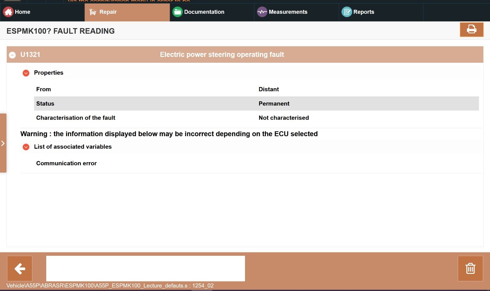

Emailed Citroen again as well as the parts place you recommended. Got a bit late to call them as of now.
We've tried with Diagbox to reflash the power steering ECU and ABS ECU with no real success. Just seems to be a communication issue even though everything is connected, yet power steering works flawless.
Plan is to find the original part number (hopefully by Citroen), purchase a replacement rack again, try it at the top of the car before wasting time pulling the other out.

I'd like to say thanks for all support in trying to resolve this issue.
Another rack was purchased online with regards to a similar DS3. I can only assume that the previous rack purchased which resulted in the creation of this error had a knackered ECU which is the likely cause of why it wasn't communicating with the car. ('ESP/ASR Faulty') Upon purchase of the second rack, it was tested on top of the engine bay before being swapped out. All went well and car no longer has fault. This didn't require any programming thankfully. Now in for an MOT and alignment.
All the companies I spoke to about this were no help and Citroen suggested bringing it to look at which would be £150 p/h
